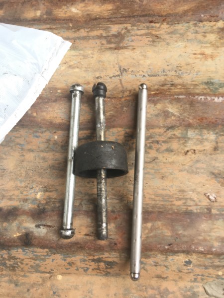

I’ll compare the new cylinder pushrod length to the old one, but I believe it’s the correct cylinder. Idea about the pushrod sounds promising, I’ll see how cheap I can grab one from work. I started thinking the same about the power bleeder so I’ve been using a reverse bleed technique where the slave cyl is compressed repeatedly to force air up the line. Got a lot of air out and pedal feel is good, so may try longer rod. Thanks for the idea!
Leftmost rod is the new slave cyl rod, middle is old cyl rod, and right is pushrod I just tried to replace the cyl rod with. The extra length on the pushrod did not help, still wouldn't go into gear. I have a little bit of stuff I need to do around the house then I'll go out and remove starter, have wife press clutch pedal, and see whats happening in there.

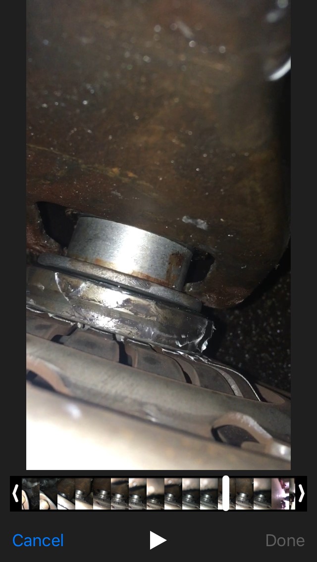

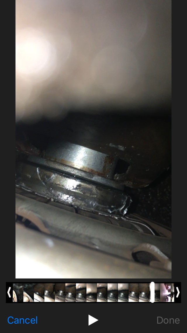

Got some stills from a video I took of my wife pushing the clutch pedal. Looks good to me, anyone see otherwise?

"Looks like" it is pushing in far enough but hard to tell
But if you can't shift into any gear with engine running then it is not releasing clutch disc enough, simple as that
Clutch disc MUST slow down to 0 RPMs to put transmission into any gear when you are stopped, thats how it works
And why you CAN shift into any gear when engine is off, clutch disc is at 0 RPMs when engine is off

My thinking is that the pressure plate resistance is not letting slave expand fully, so you are not getting full travel at the slave regardless of pushrod length, its being held in by the pressure
