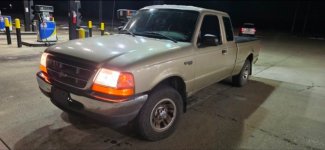

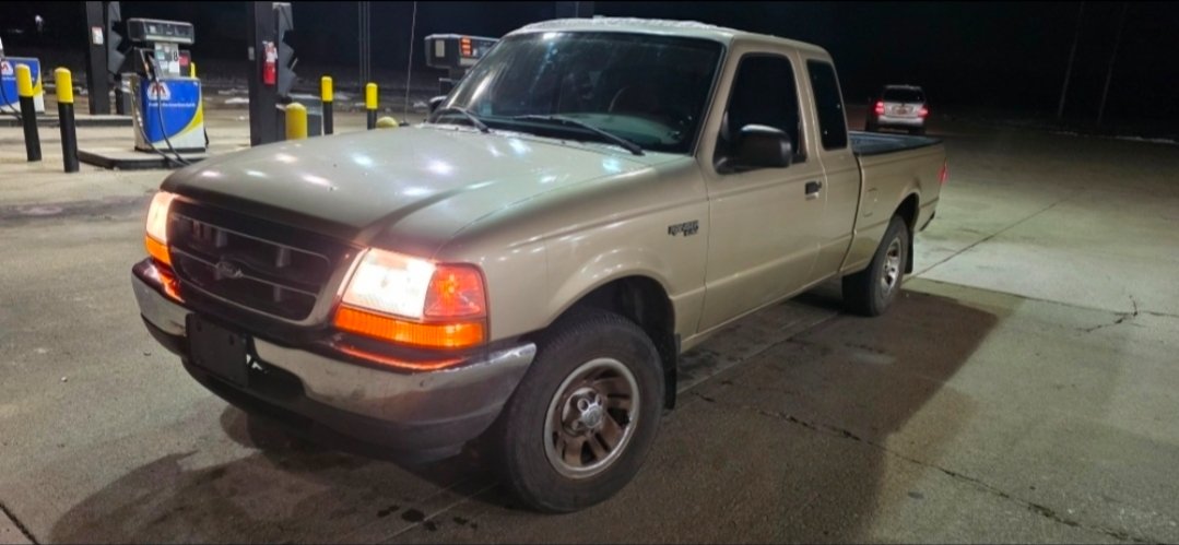

Hey guys, first time poster here!
I’ve got a 1999 Ranger, 2WD with the 3.0.
Stock tire size was 225/70R15 on the factory wheels. My original steel wheels are pretty rough, so I picked up a really clean set of aluminum wheels from my neighbor, they're brand new.

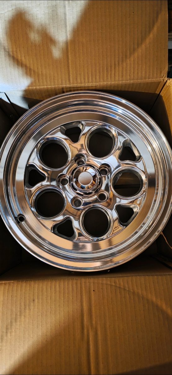

They’re the correct bolt pattern and still 15s, but they’re staggered:
2 wheels are 15x7
2 wheels are 15x8
0mm offset
I’ve never dealt with a staggered setup before, so I’m not sure what tire sizes I should be running. Or what I should even look for.
what I’ve read, I know the main thing is keeping the overall tire diameter close so it doesn’t mess with speedometer or handling.
My main question:
If I do go with these staggered wheels and staggered tires, what tire combo (front and back) would work and keep my diameter close to stock?
Would love to hear about and see other people's similar Ranger set ups!
Also this is my daily driver, I really want it to look good and drive right.
I really appreciate any help 👍
P.s. I've also got a 95 2wd Ranger with the 3.0/5spd. Its got 14 inch wheels. Thrown around the idea of putting these wheels on it instead. So any info on that would also be appreciated, if not the same. Thank you, again!

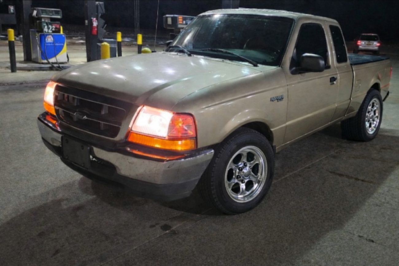

Your OEM wheels are 7" wide, and going to an 8" would be as easy as running a 235/70 profile on the rear and keeping the stock size on the front. While it is slightly larger (28" vs. 27.6" dia.), it'll also give the truck a bit of a racy look. At O offset, you're going to have about 1.25" of "poke" in the rear and a flush tire wall in the front. It'll definitely change the look, and give you a small bump in traction. I recommend going with a touring tire for this setup, not all-terrain.
This is kinda what it would look like...

235/65 would also be good out back. I think i have 235/70/15 all the way around on my 04 3.0
That's exactly the type of info I was looking for. Huge help! Thank you!
Yeah, either that or just keep the same size tire, the sidewall just won't pooch out on the 8" ones, I've ran some goofy wheels in the past, stock '80's Ranger steelies (must have been 6 or 6.5" wide) and some jeep aluminum ones and the sidewall pooched out on the narrow and looked goofy on the aluminum with the 225, I just didn't rotate those tires as the aluminum ones wouldn't fit on the front of my '97... (center hole too small)
I thought bulge was beautiful. 🤣 That would be an interesting look, flat sidewall, especially if you had been able to do a 4-corner and got those wider rims on the front.

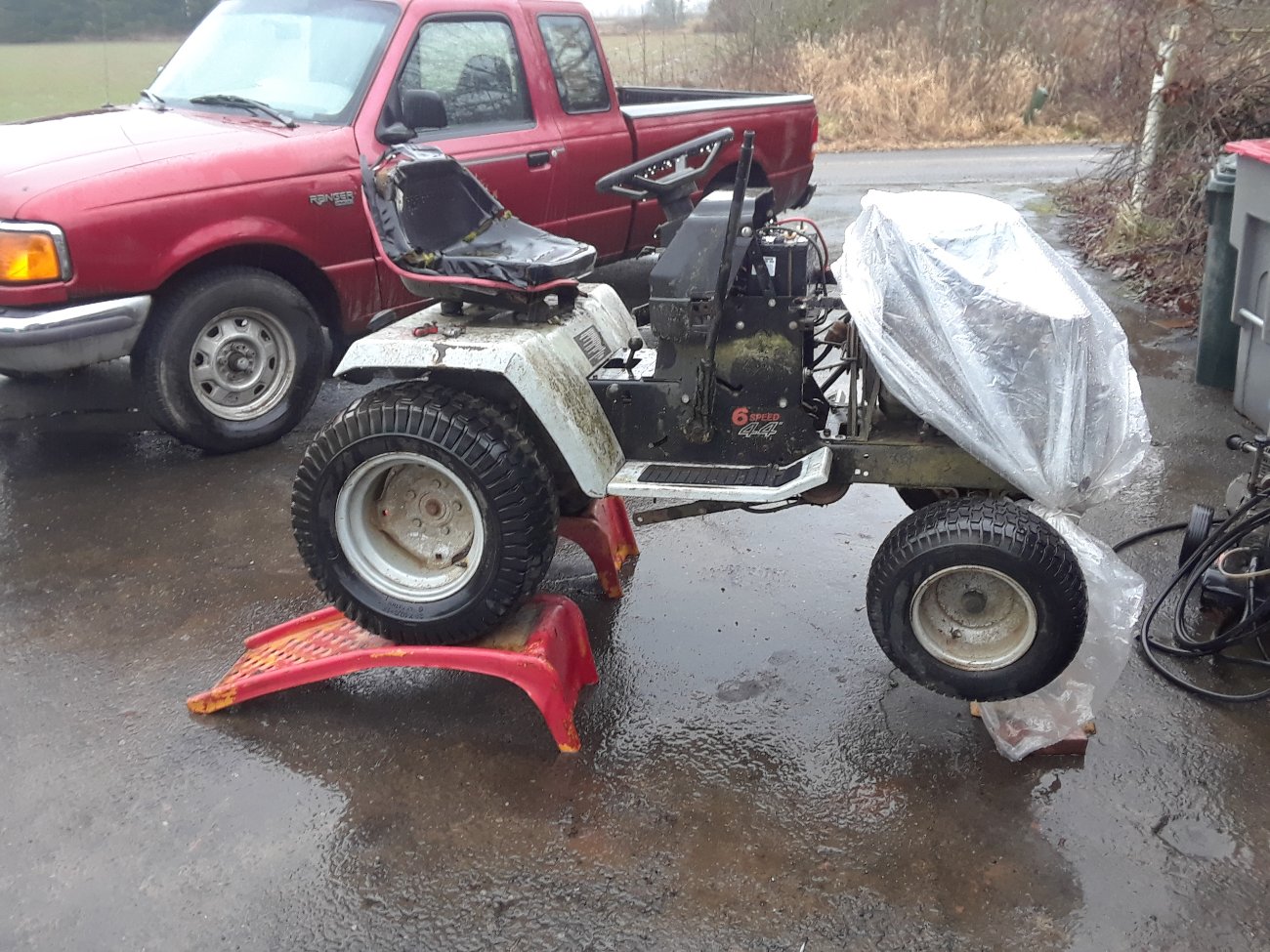

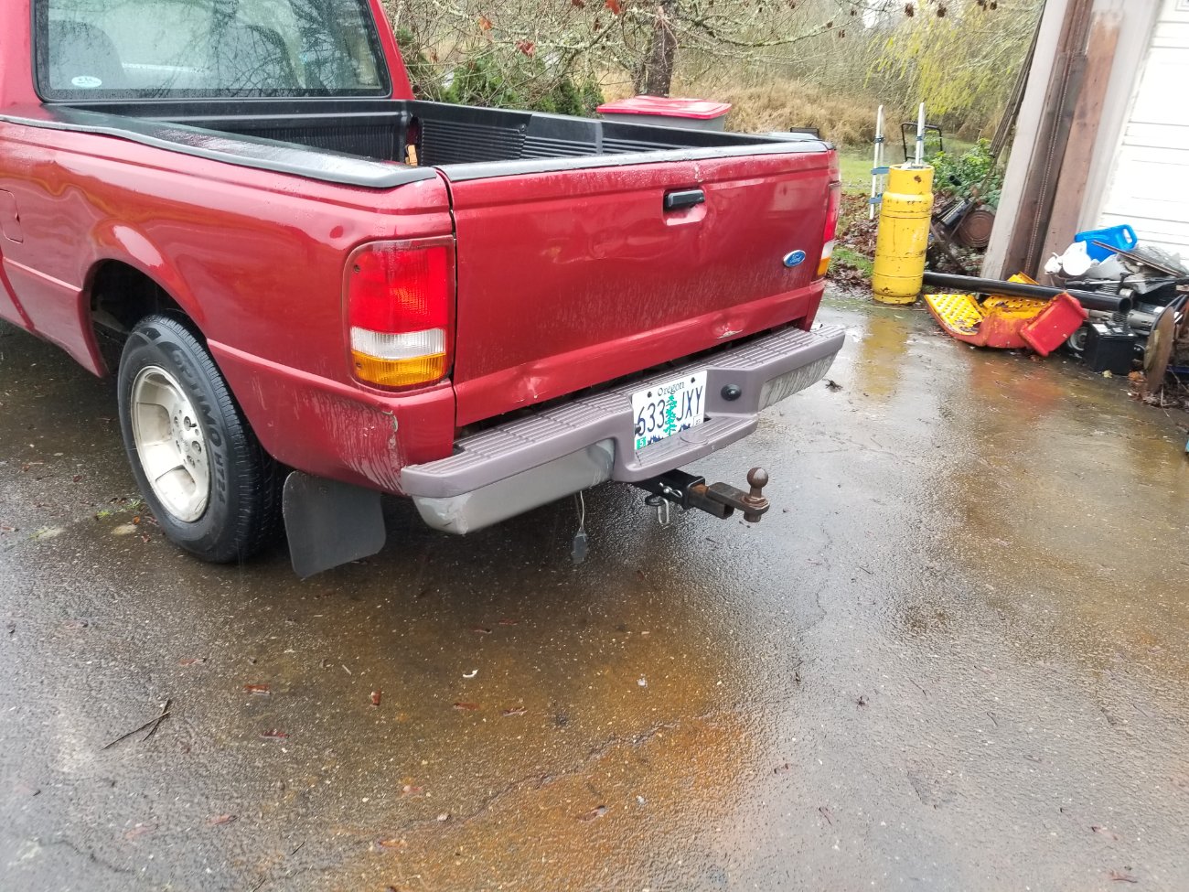

Apparently I don't have a side shot of the thing with that setup but here's two pictures somewhat close together... you can see the front are bulged and the rear the tread is narrower than the wheels, that's with my $60 set of 225 70 15's, I got a matching set of '09 Ranger wheels to put a new set of the same tires on...
