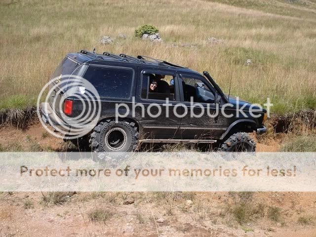

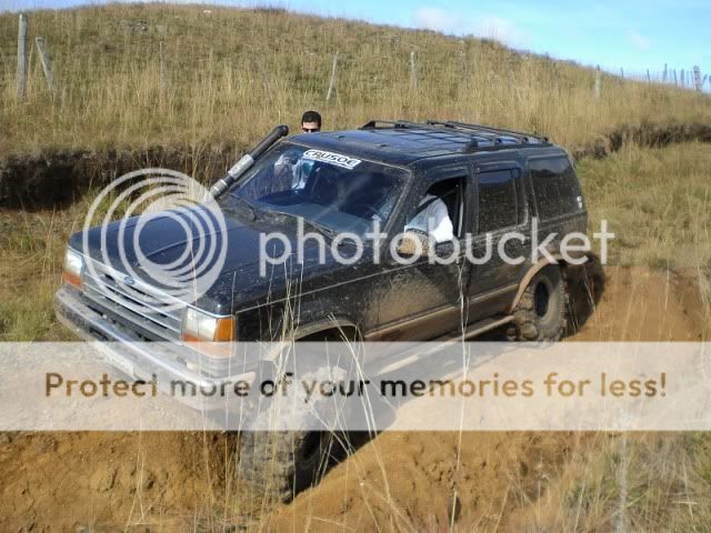

I have an inquirey.
Does anyone know what tires are on this Exploder?? I would LOVE a set big time!!!
