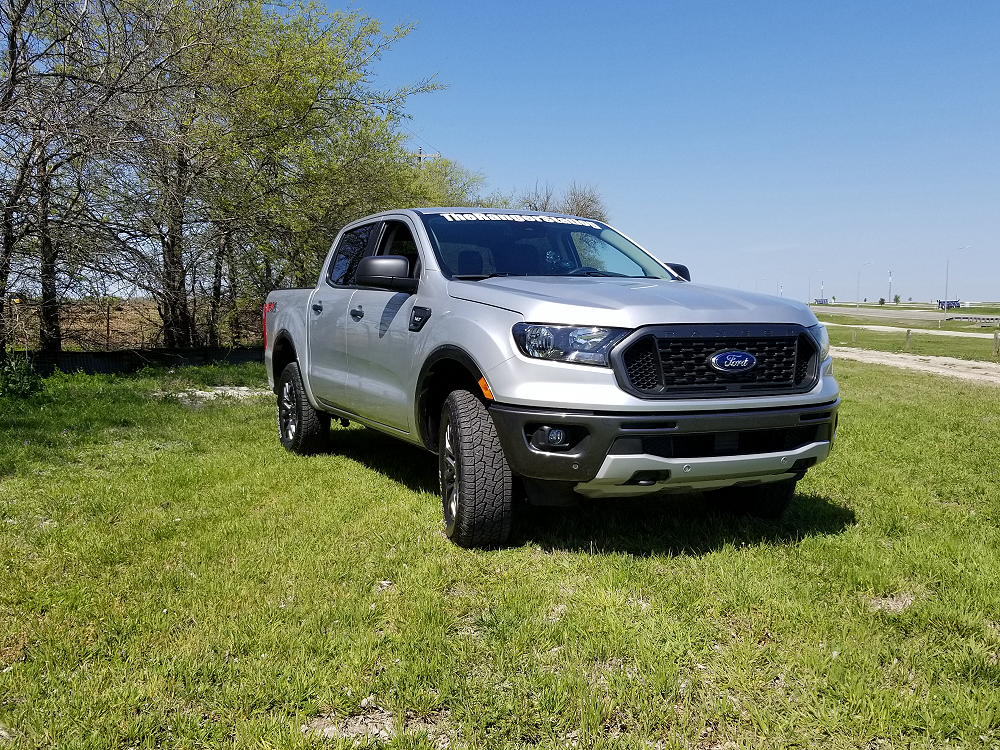

Here it is, the 'Loan Ranger'!​
How I Got It:
As you know, TRS was at the debut of the 2019 Ford Ranger in Detroit (January 2018), the start of production celebration at the Michigan Assembly Plant in October of 2018, and then I attended the Media Drive event out in California in December 2019. 2019 is the 20th anniversary of TheRangerStation.com, and ironically the same year that the Ranger returned. I have been in discussion with Ford about getting a Ranger for the anniversary since the debut, and was blessed that the right people in Ford were willing to work to make it happen.
I do not own this truck. I want to make that clear from the beginning. Ford has graciously loaned this 2019 Ford Ranger FX4 XLT to me until September 30th, 2019. That means that I will have this truck, and TRS-2 (my 1996 Ford Ranger) at the 20th Anniversary Trail Ride on September 7th, 2019. It's also not technically an Anniversary Edition, but wouldn't it be great if Ford offered that? 2-inch lift, mud terrains, grill guard, etc...
Ford has told me that I can modify the Ranger, I just can't drill any holes, or permanently mount anything to it. I have to return it back to stock before returning it.

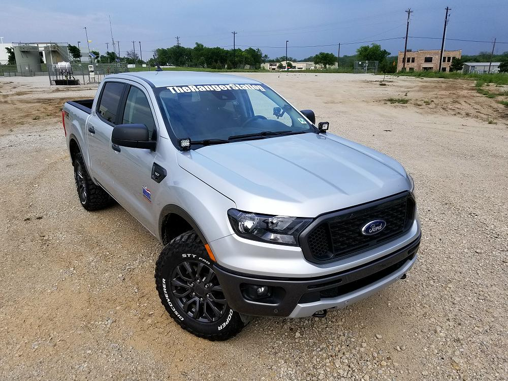

Current Status:
26577

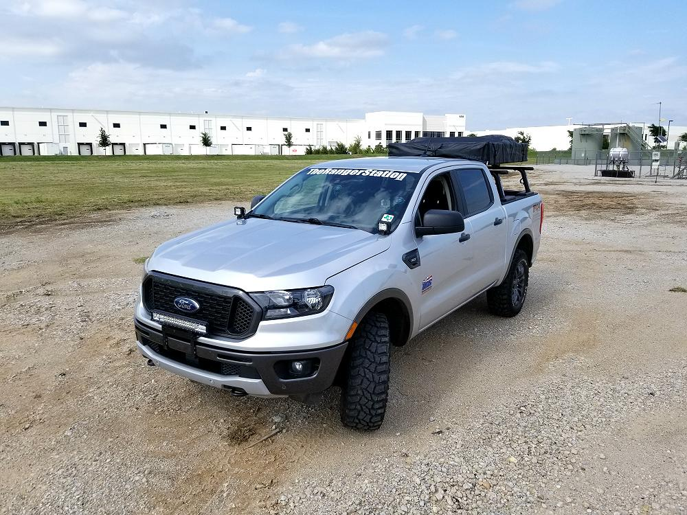

The 'Loan Ranger' is now riding on 265/70/17 Cooper Discoverer STT PRO tires and is equipped with (2) Nilight 4-Inch 60-watt LED off-road lights.

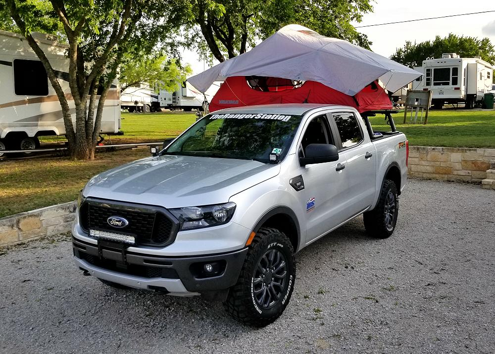

Update 05/01/2019:
The 'Loan Ranger' now has a Yakima rack and SkyRise tent, as well as a Nilight 20-inch LED light bar above the front bumper.

Sweet ride. look forward to seeing mods.
looks good (the truck)

Does it have the Black option? Cant tell ,really? Looks good though. Congratulations Jim, this is a BIG deal, and a great accomplishment.

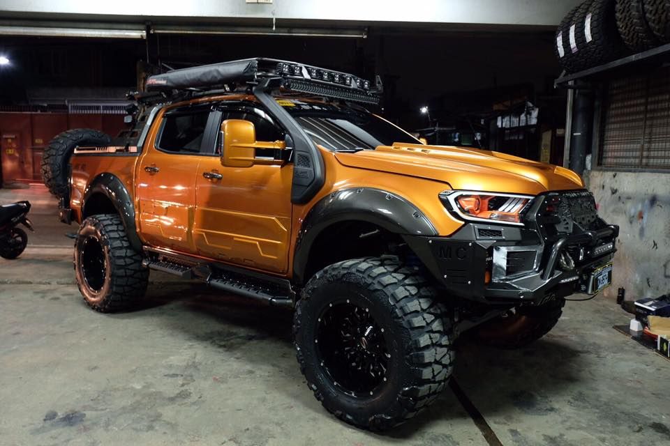

Here is some motivation.

I did not know Chevy tow mirrors fit the new Ranger too... they were a bolt on upgrade for my F-150. I wonder what was involved in hanging them on a Ranger.
I think Jim's new truck just has the dark gray trim like a standard FX4.
@Ranger850 it's just the sport appearance package.

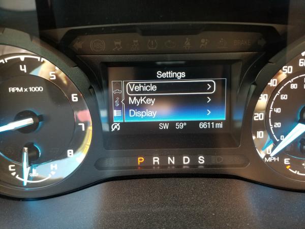

Automatic Highbeams:
This Ranger briefly freaked me out last night. The highbeams kept kicking on and off. It has a setting that will allow the highbeams to automatically turn on and off when the headlight switch is in automatic. It senses lights, and dims back to low beam. If you dial the headlight switch to the regular on position, it seems to stop. You have to go in to the menu in the gauge cluster, and deactivate it.
26583
If you turn the headlight knob from 'A' automatic one click left to the on position, the automatic highbeams will stop coming on.

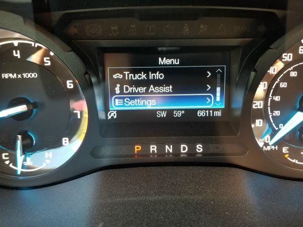

On the steering wheel controls, push the left arrow next to the OK button, and then arrow down (scroll) to 'Settings' and click right.
26579

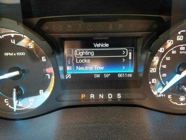

Then click right on 'Vehicle'..
26580
And then lighting.
26581
26582
You'll see the options for 'Automatic Highbeam' and 'Daytime Lights'. I already unchecked it by pressing OK on it, but this is where you shut the feature off.

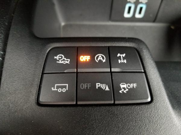

Ford Ranger Auto-Stop:
I also found myself using the button on the console to shut off the feature that makes the engine shut off every time you come to a stop.
