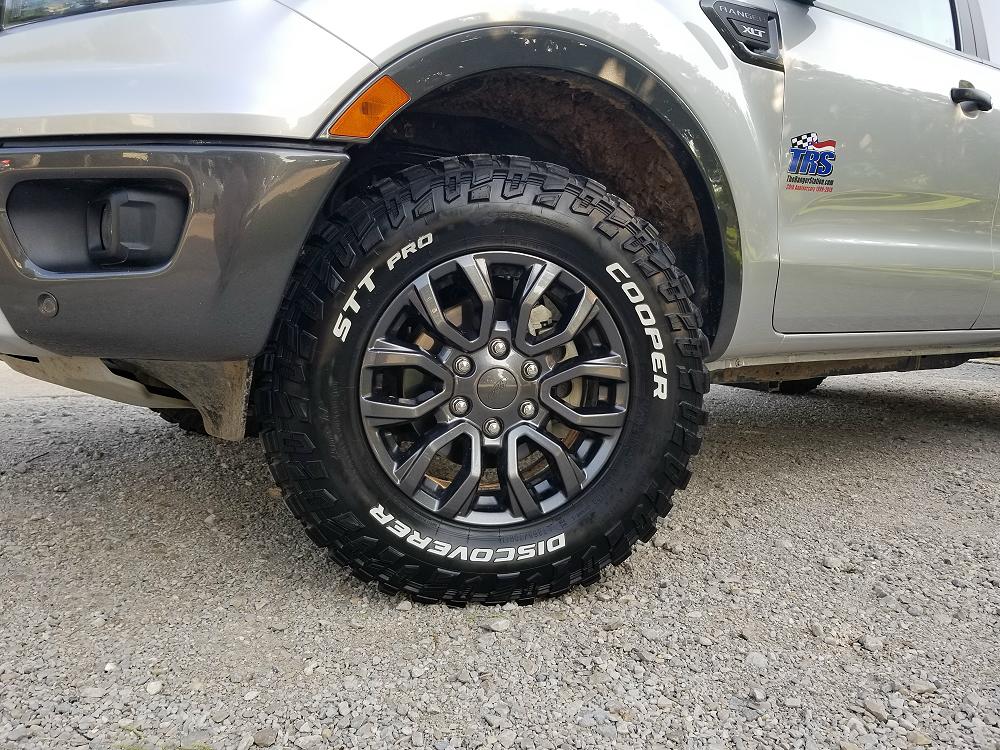

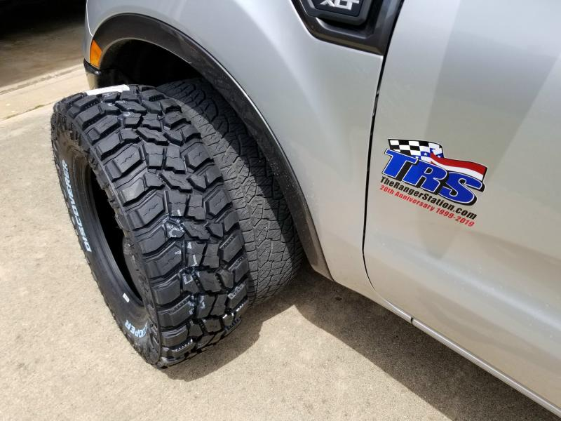

When Ford gave me the 2019 Ford Ranger FX4 to use for 6-months, I knew I wanted to take it off-road and do the Trans America Trail (TAT). I also knew I wanted a set of tires that could get me over or through anything I encountered. I had used the Cooper Discoverer STT PRO tires before on another truck, and knew they were the tire I wanted for this adventure. I ordered them in 265/70/17 (31.93x10.70x17) which was about 1.5-inches taller than the stock tires.
- Stock: 265/65/17 (30.40x10.40x17)
- Coopers: 265/70/17 (31.93x10.70x17)

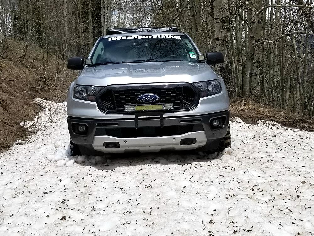

This trip took me through the mountains of Colorado, where I ran in to deep heavy snow in the higher elevations. The Utah section took me through Moab, where I encountered rocky ledges, and sand. Some sections of this trip took me through rough terrain where rocks and holes were hiding in tall grass. Oklahoma and Arkansas put me in slick mud.
