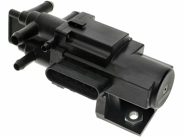

does it have the plastic diverter manifold style? probably the valve is dead.
Tank Selector Valve issues
Yes but the issue is we were checking the wires thag plug into it and there was only a signal on one of the 5 ports and all the rest were dead even when the switch was flipped.

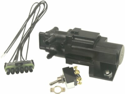

the last thing i posted has a pigtail and new switch.
