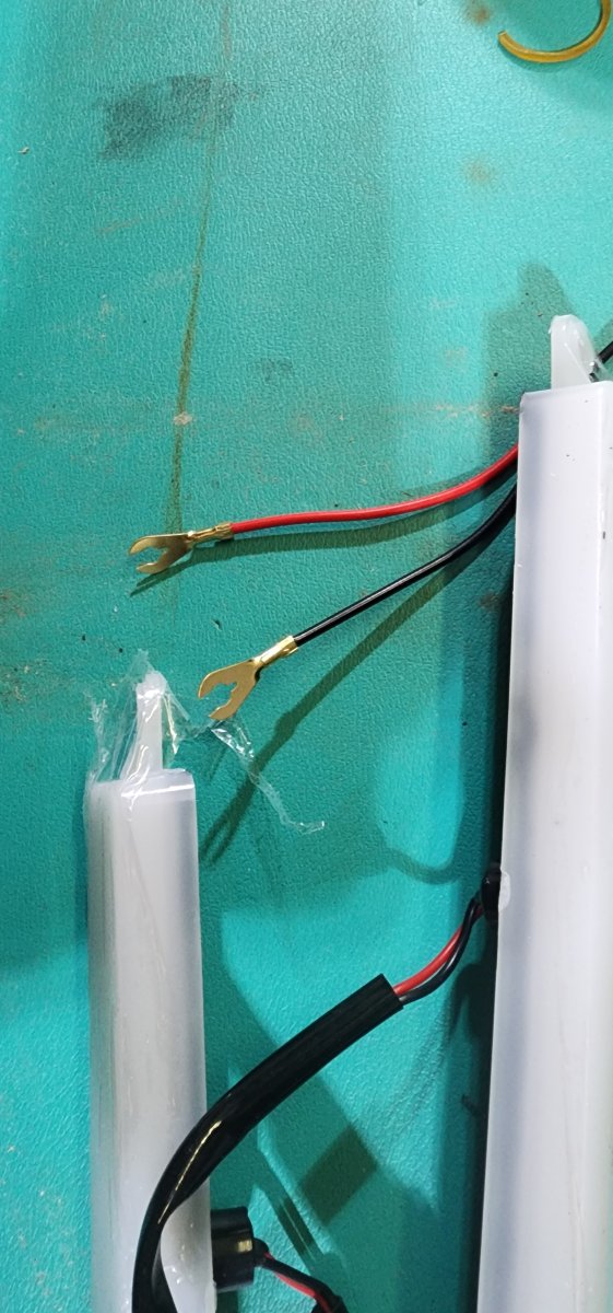

I'm just looking to install LED grille accent lighting on my 2020 Lariat.
Can anyone tell me where I might Source a solid 12 volt supply for that? Preferably something that comes on when the daytime runners are on?
The LED grille kit I bought comes with ferals, or stak-on forks depending on the vernacular you prefer.

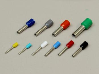

Ferrules

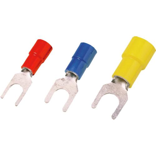

Fork lugs or fork terminals

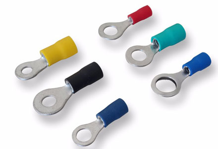

Ring lugs or ring terminals
