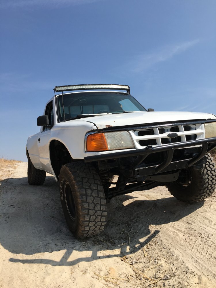

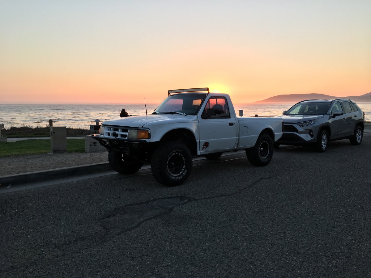

Here’s a few pictures of it a few moths ago before I cut the fenders back for clearance ill get more pictures tomorrow.

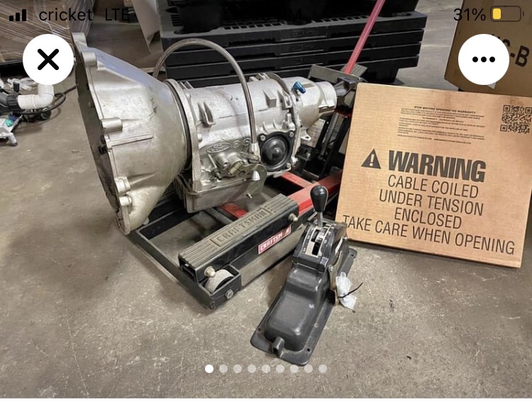

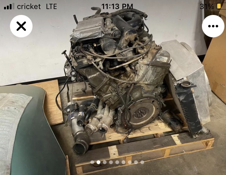

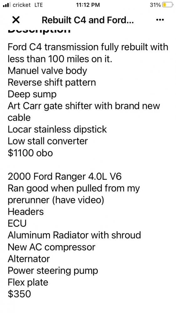

Also here’s what I’m getting

so just a heads up for when you need to get parts.... if that motor is said to be a 2000 like your post its actually from an explorer not a ranger. rangers didnt get a sohc till 2001.
thats a great combo for a fun prerunner. i have the same in mine. if it doesnt have them already, youll wanna go get fuel rails from a 1997 explorer. that was the only year sohc that has a return style fuel rail/lines. that way you can use your stock pump and lines and stuff.
