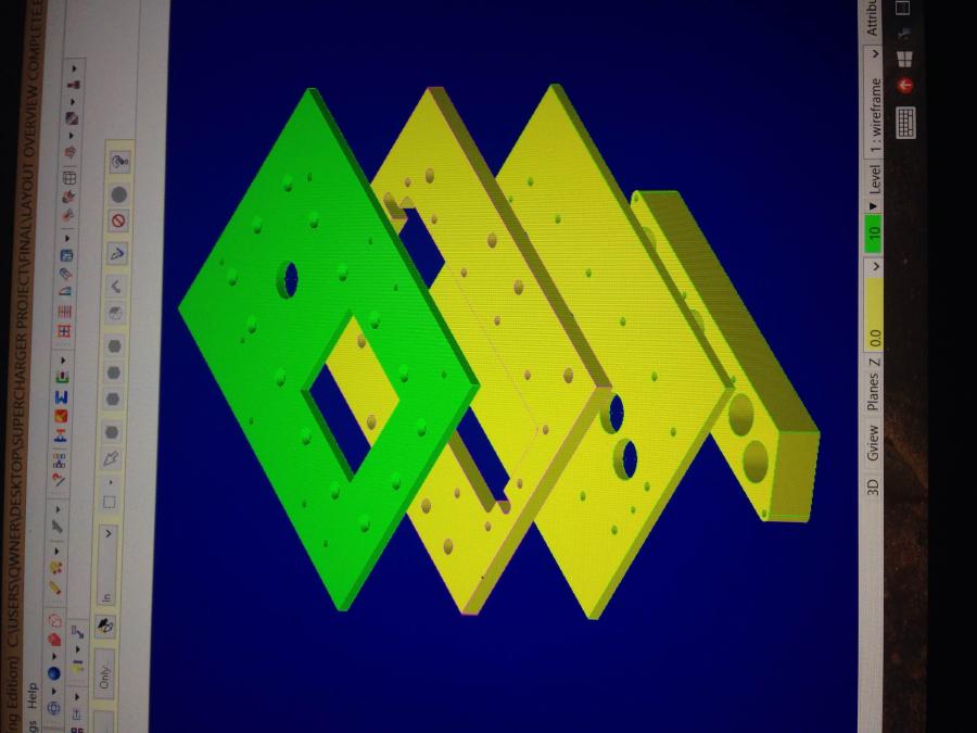

Hey guys its been a while since my last post. Haven’t had a whole lot of time since then with school but some personal issues arose and in order to solve them I had to drop physics for the first half of the summer which gives me now some free time until summer term 2 starts up. Regardless, I was able to talk to a local machinist I went to once before, he owns a custom shop and specializes in cars, he didn’t have much to say for the design except that I could combine three of my pieces into one without increases the cost of milling it out. He told me it will be about 600$, but will allow me to mill out as many stencils of certain aspects of the part to physically double check clearances and measurements! Which is great news! This allows me to really fine tune a lot of clearances which will remove a lot of variables. Essentially the intake spacer, base plate, and cavity plate will all be one piece (as seen highlighted in the picture). I’m going to close up the tolerances on the bolt holes for the “intake spacer” ensuring the whole assembly is solid, and I will see how much I can lower the height of the intake spacer to allow more clearance for the total height of the supercharger and intake.
In terms of a kind of cooling system, personally I don’t see that happening as there is just not enough room to fit some form of intercooling system inside the intake. However, a meth/water injection seems like the way to go as JP02XLT suggested and is what I will be installing for this project. A bit pricey for a pump and controller at around 400-500$ but I think the added safety to prevent detonation is worth it.
Bad news is the mastercam free edition doesn’t allow any post processing nor allow me to save my files as anything but mastercam home edition files :( So my machinist introduced me to this really neat CAD software called ViaCAD, he says he uses it more than solidworks, and to be honest I was impressed! In some ways its more powerful than mastercam's design tools. The program costs only about 70$ and allows me to save in almost ANY file possible! I wish I had known about this earlier. So it looks like I will be copying down the blueprints onto this new software and sending some stencils to mill out and check my measurements physically. Im not sure how long this will take but I’ll keep you guys posted as best I can, and sorry if this thread is slow, im trying my best to get this done when I have time!

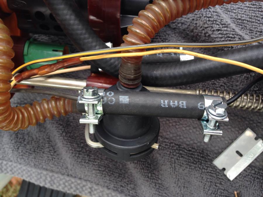

Fuel Pump
I was also able to get in a walbro 255 lph fuel pump the other day, it was branded as a "High Flow Performance" product but im pretty sure its all from the same source, looks just like a chinese walbro. Either way works well so far :icon_welder:
