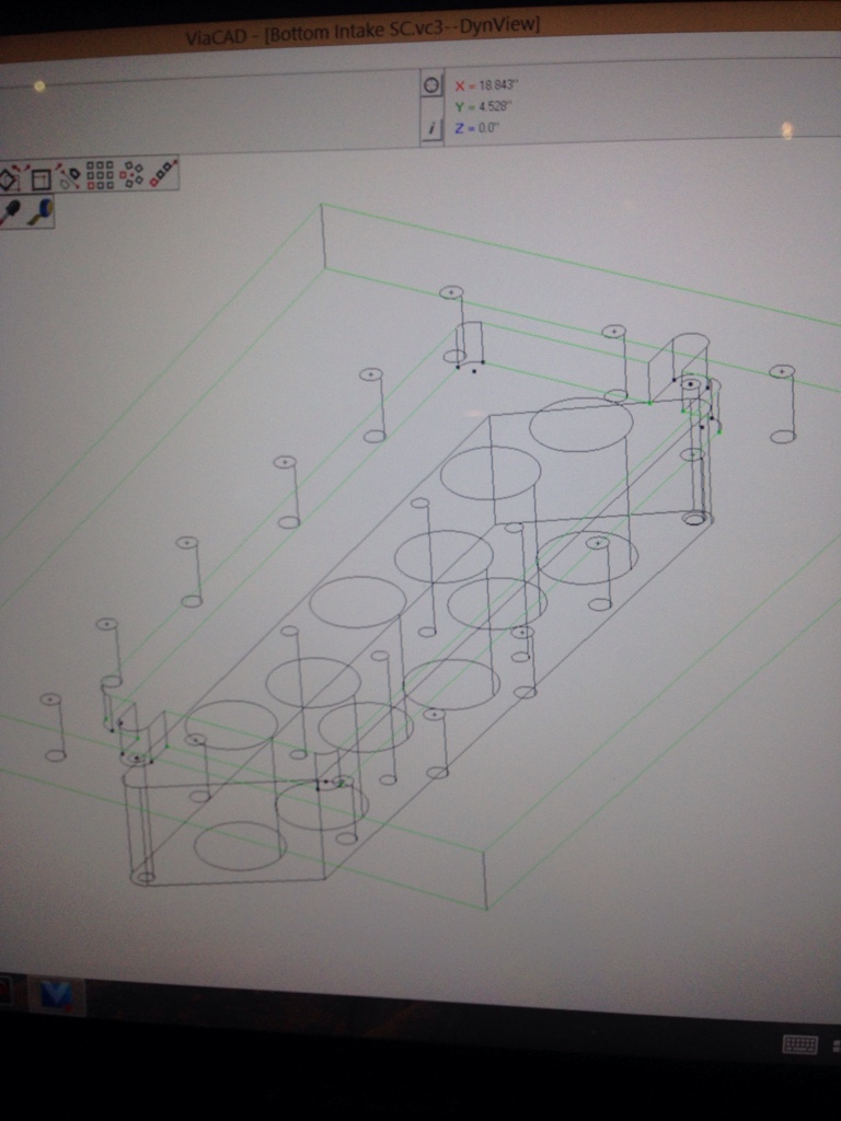

Just finished re applying the blueprints onto the new ViaCAD software at work. Also emailed some files for metal stencils to my machinist which will allow me to tell physically how the supercharger will sit in my truck and check for all my clearances, alignment, tolerances etc. Pretty excited! Once this is all clear, it's just a matter of waiting for him to mill out the real intake. Time is now in the hands of my machinist
Alright so my machinist says he's been out for the week and rearranging the shop. Hopefully I'll get the stencils in next week, and ultimately the final supercharger done by the end of July! If all goes smoothly!

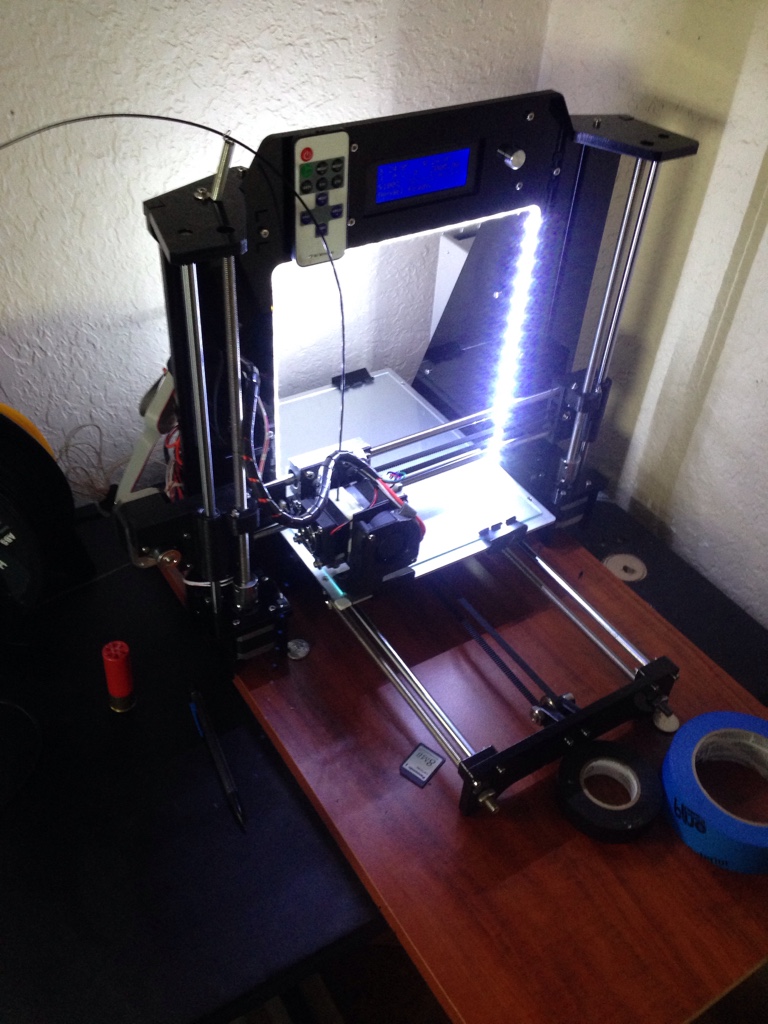

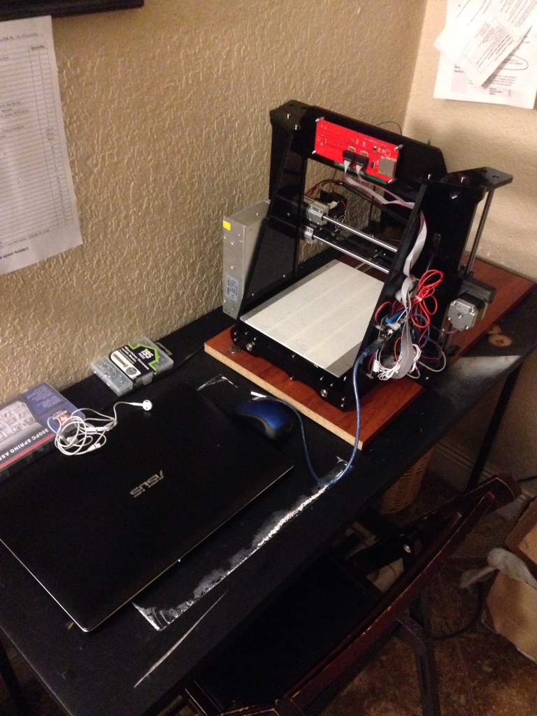

In other news I got myself a 3D printer to occupy my time...which is why I haven't done much for my truck lol :p got some ideas for a shotgun shell speedloader for mag tube feed shotguns and many more. This little gadget was a lot of fun building and making parts from, if anyone here has CAD software and is interested in a 3D printer this is a good buy. Check Amazon for HIC i3 Prusa printer

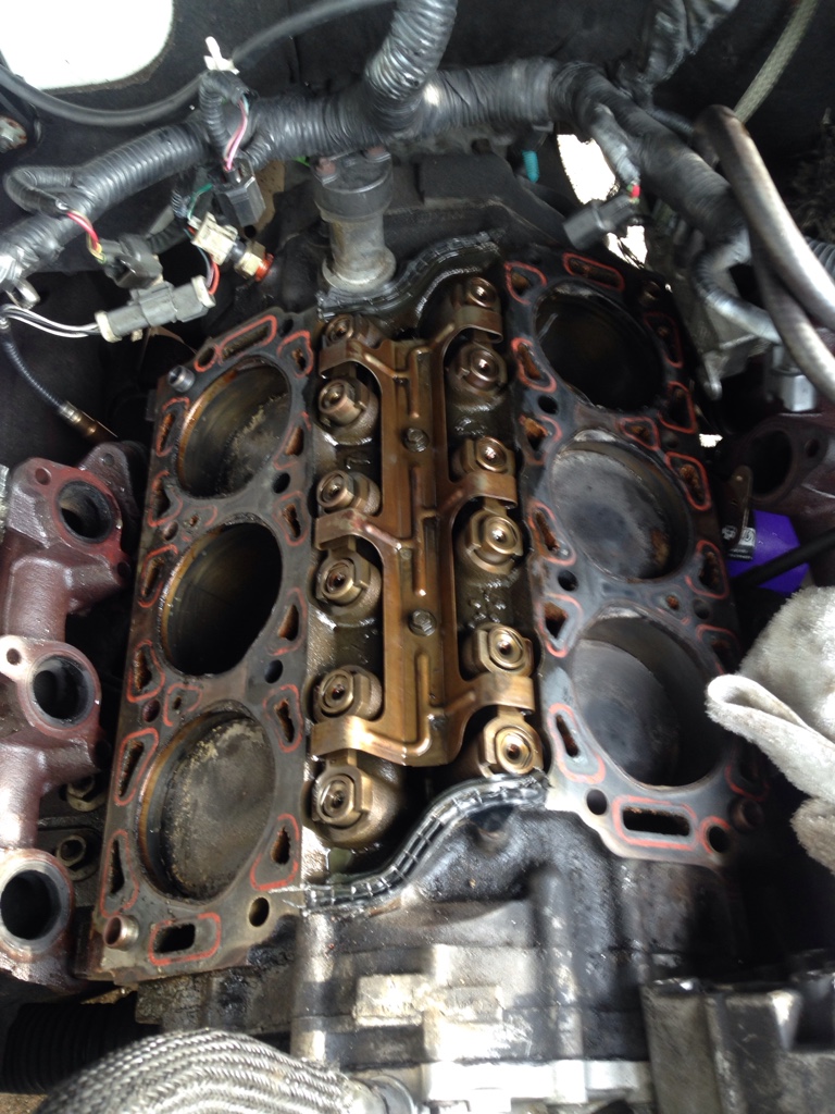

However, I decided to get a wet nitrous kit in the mean time. It's from Nitrous Express and has multiple nozzles for various hp outputs. Considering my engine is a bit tired after 100k miles I decided to replace the head gaskets, exhaust gaskets, bolts, and clean off the tops of the pistons yesterday. This morning I installed the kit, and I must say for 400$ it's well worth it! I'm going to work my way up to 100, although I think 75 will be a nice number. Currently I'm running 50 shot and that allow gives it some kick!

Sorry it has been so long. With classes and other projects I have been working on I have not had time to keep up with this one. I currently have a friend who has a mill and is willing to mill out the supercharger intake once he calibrates it and I bring him the materials. In the meantime, he will mill out a prototype model out of wood and see how it fits under the hood. I also am attaching a link to a dropbox folder with the Solidworks files and pdf files for the supercharger intake! Anyone is welcome to take them and use them for themselves (please check for clearances with your hood and firewall). Enjoy!
