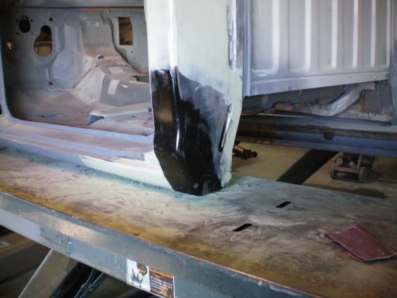

Also stopped in at the bodyshop and took a look at the cab. All the rust areas are dealt with except for the drivers cab corner (yuck). It should be done this week. So far, no filler has been applied, so it will be nice when its done.

Thats definitely a quality previous repair on that cab corner! LOL.

New cab corner is in, so the cab is now officially rust free. The box can now start getting the attention. Who would have thought bedsides would be so hard to get? Cost me way over $1000 to get the passenger one, and I am still trying to get the drivers side.

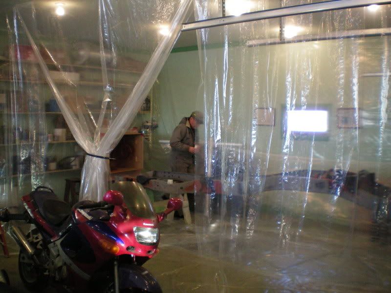

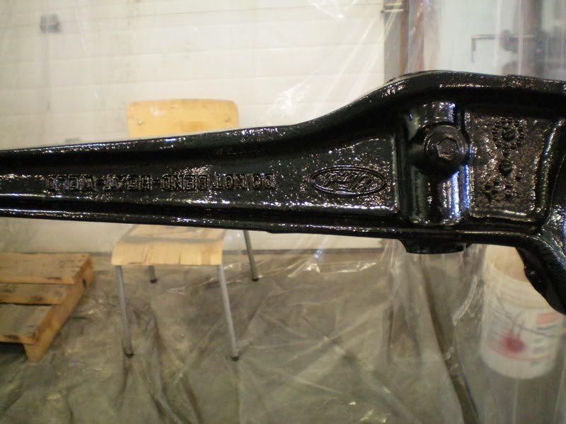

I ended up painting the frame, rear end, front i beams, etc myself with epoxy primer and urethane paint. That urethane paint definately shortened my lifespan. I was watching TV later in the holidays and found out it requires a fresh air supply, even a respirator isn't enough. I had a dust mask, and then a long term headache. At least it came out looking great.

And finally, a little assembly. Only parts reused were the I beams, radius arms, and spindles. Every wear part is new; bushings, ball joints, rotors, calipers, bearings, tie rods, etc.

a dusk mask?! omg man...charcoal respirators are $20 and will do a fine job...fresh air is nice, but a charcoal will be just fine for doing little stuff now and then (though many pro painters don't even use fresh air)
Anywho, frame looks really good.
