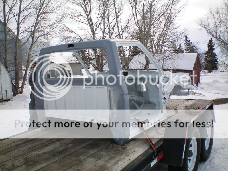

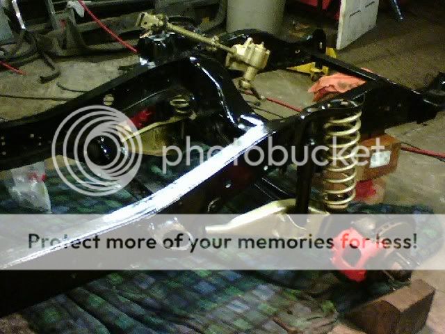

I would have bought a respirator if I could have. I painted it on Christmas day, so any place that would sell that kinda stuff was closed. I mixed up my 2 part paint and noticed it was pretty stinky. I checked and the pot life was only 8 hrs, so I had no choice but to either spray it, or waste it. Since it was about $200 worth of paint, I decided to spray it.

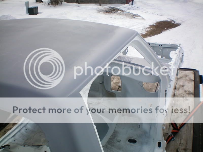

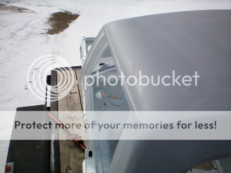

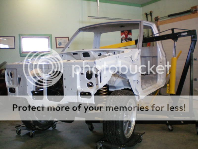

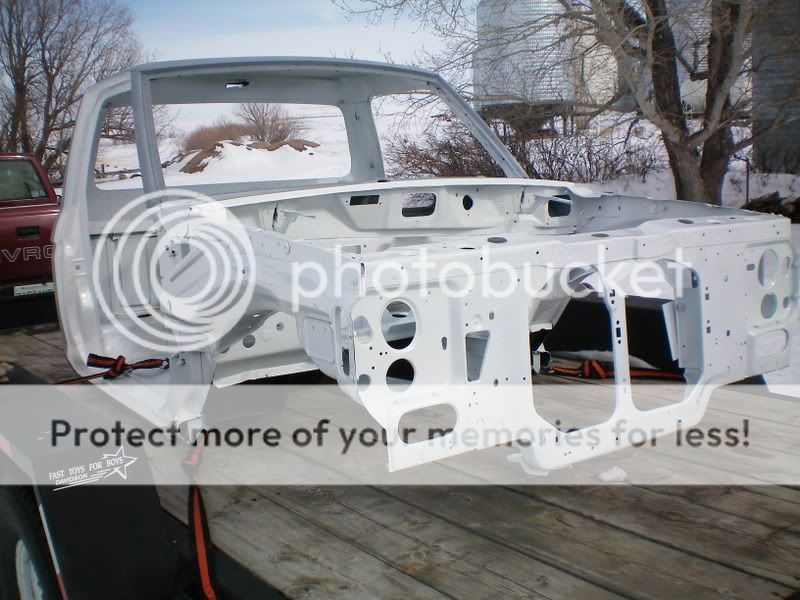

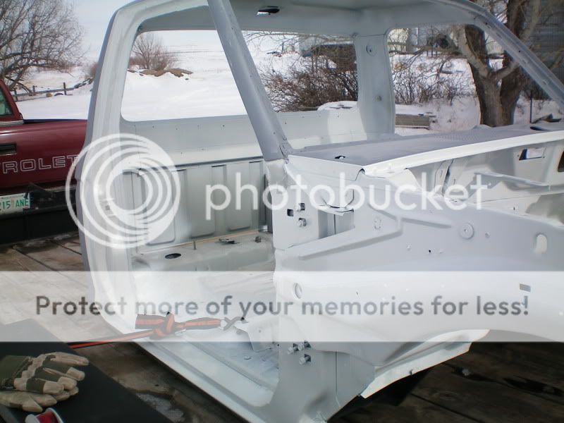

Everything is pretty self explanatory, except for maybe the pictures of the shaved drip rails. You wouldn't notice them if you weren't told. It ended up giving kind of a neat body line.The pearl doesn't show up in the pictures nearly as much as in person, although you can see it a bit in the 2nd and 3rd pics by the door latch area.

Nice truck. Patience isn't one of my virtues... I can't wait to see it finished. And, cherry pickers work so well for dropping a cab on the frame...

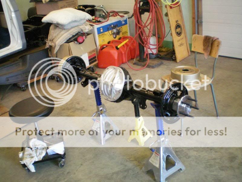

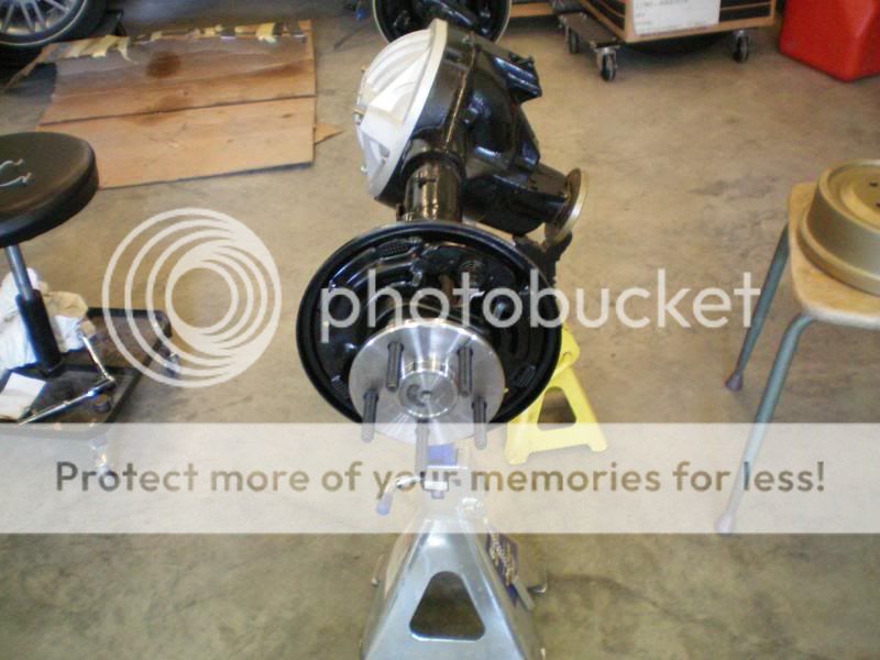

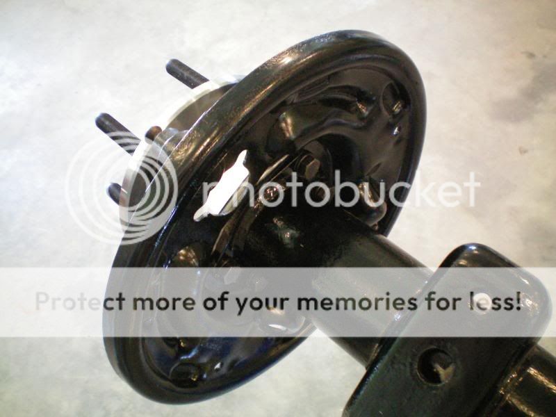

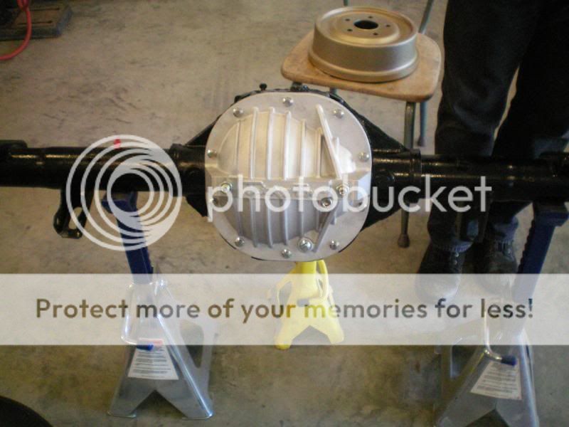

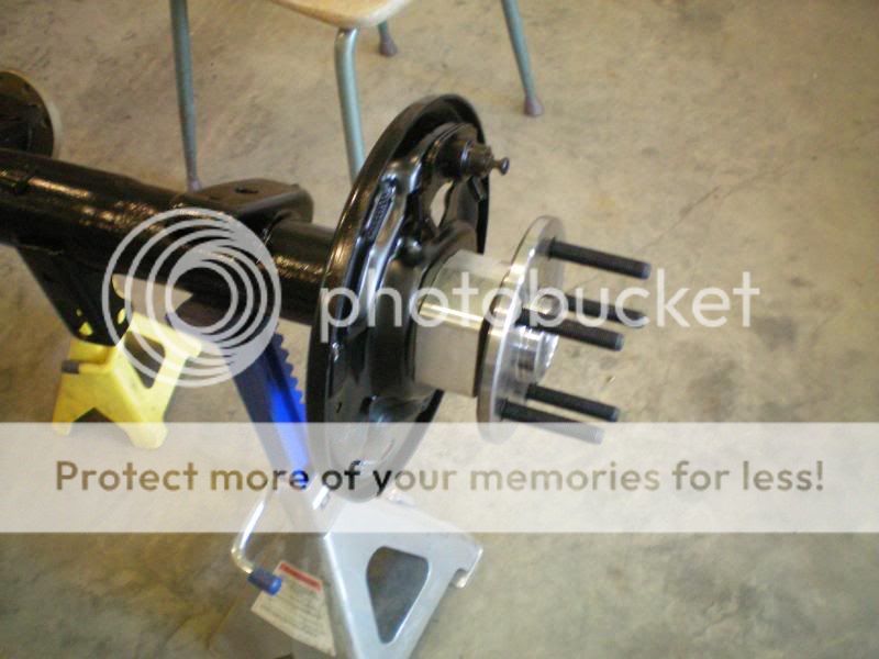

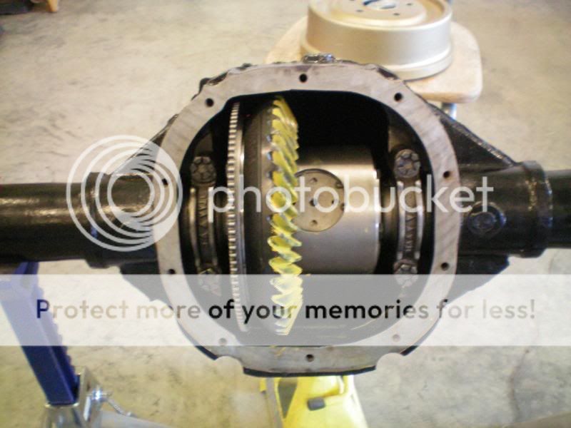

I would like to get the rear end assembled (8.8 w/ 3.73 gears, Detroit True-trac, 31 spline Moser axles, c-clip eliminators), so that I can fit the Slide-a-link traction bars, and get a custom driveshaft. I'd like to get the ball rolling on those longer lead time items so I don't have to wait on anything next winter. I wouldn't mind ordering shocks too, just can't decide if I want to go with an all-around shock, or 90/10 drag shocks.
Well, it's the time of year for some progress again. The rear is actually already under the truck, again, just forgot to take a picture of it on all 4 wheels again.
