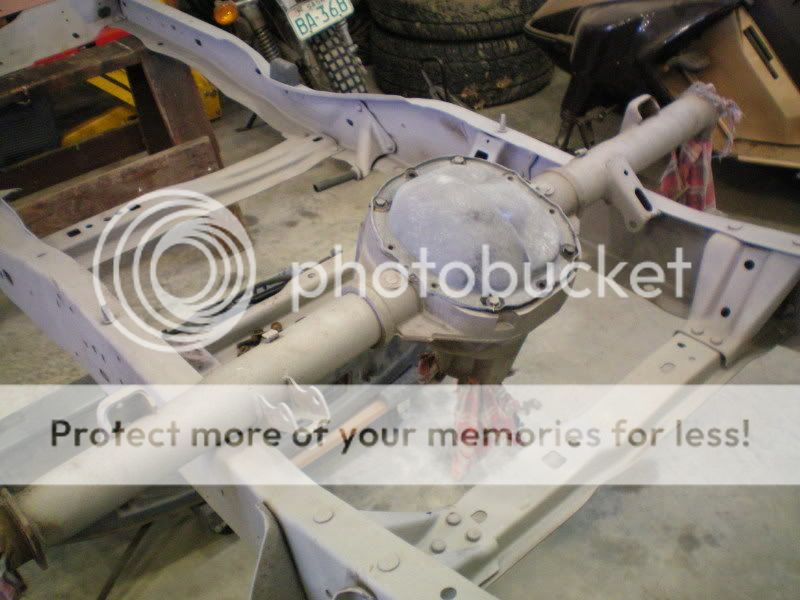

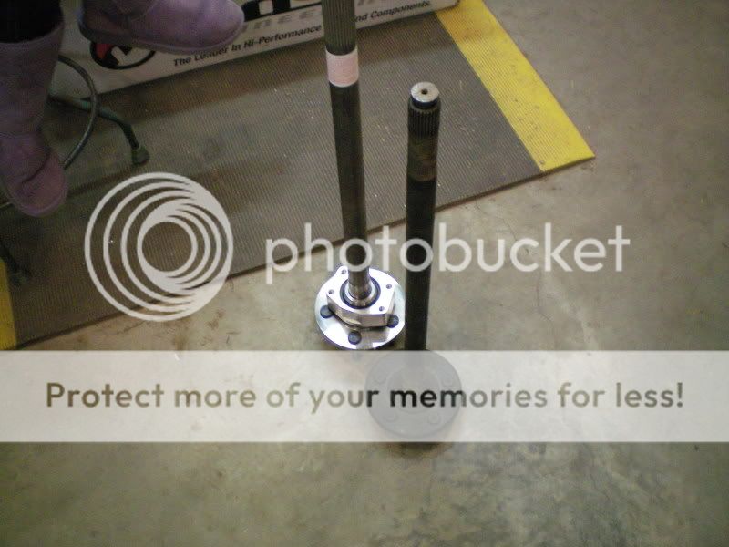

The rear end build is also underway. I have a 92 8.8 rear with 31 spline Detroit Truetrac, Moser custom alloy axles, c-clip eliminators, 3.73 gears, and Competition Engineering Slide-A-Link traction bars.

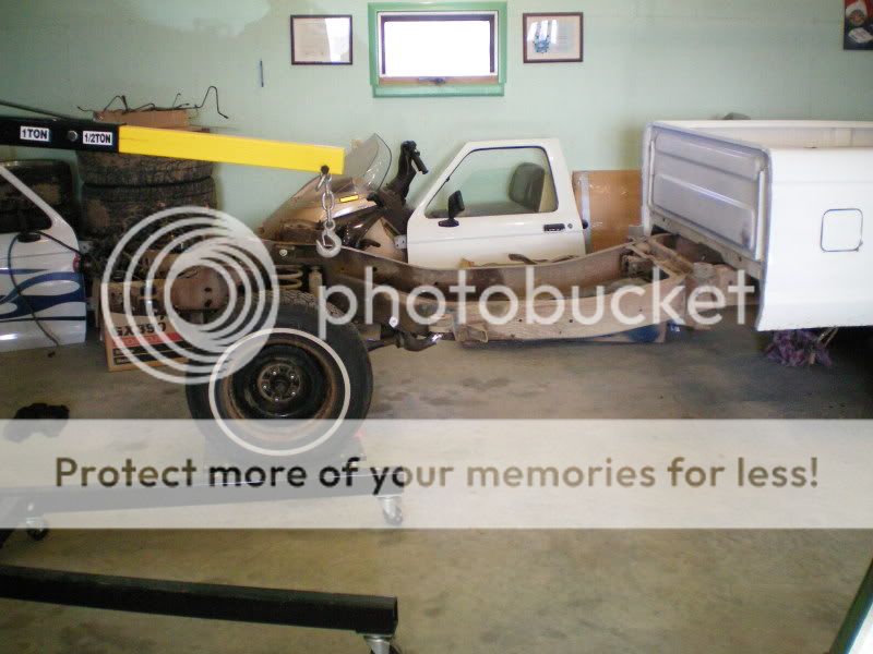

Well, it is totally disassembled. Not a single fastener of any kind on the frame, cab or box. I'll be taking the frame to be blasted, and the cab and box into the body shop as soon as I have a chance. It's all loaded up on the trailer.

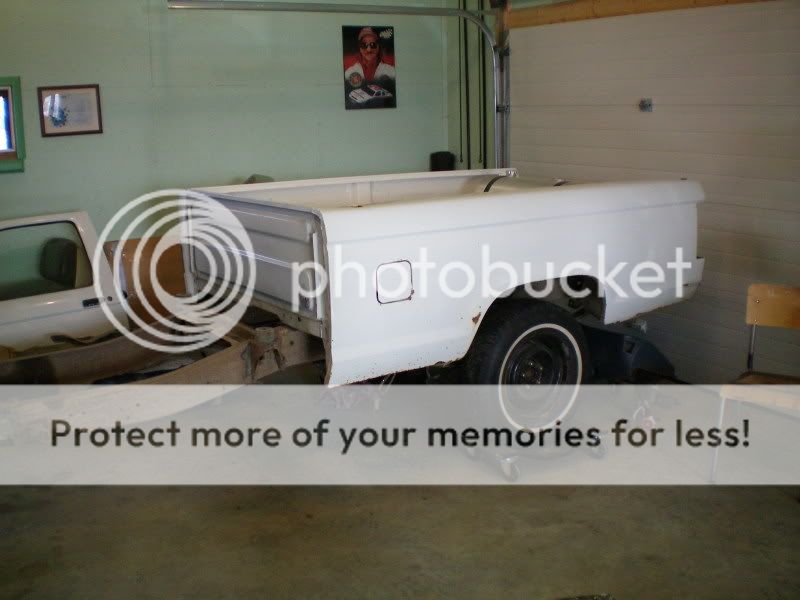

Cab off, box still on.

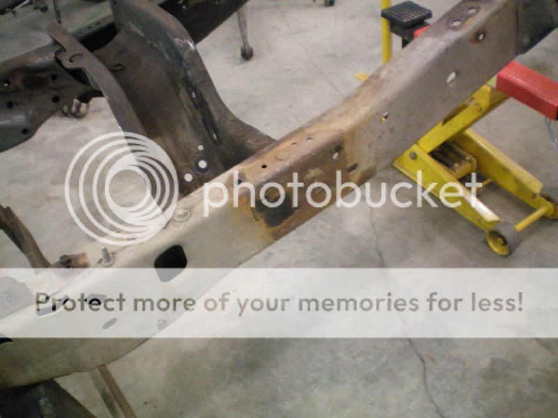

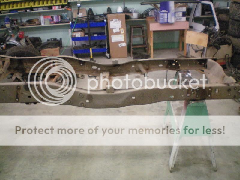

Its upside down! All rusty brackets cut off the frame. Ordered new leaf spring hangers and one front spring bucket.

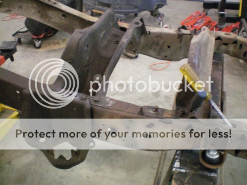

This is where the rear suspension used to be

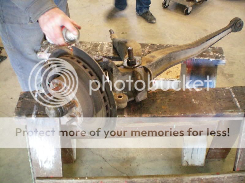

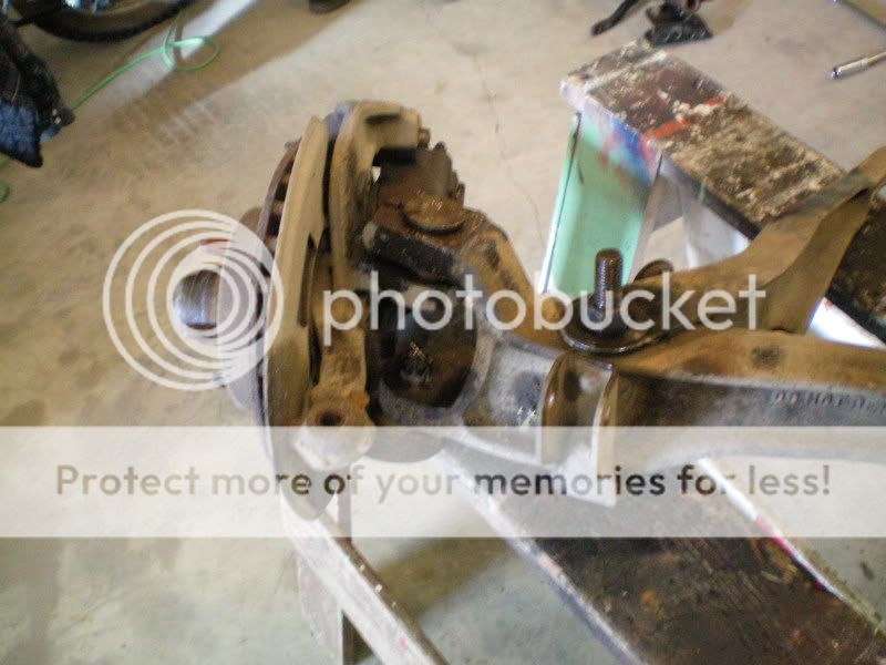

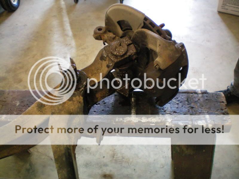

Stripping the front I beams.

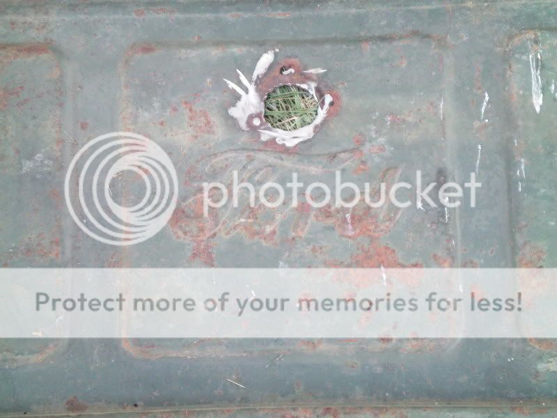

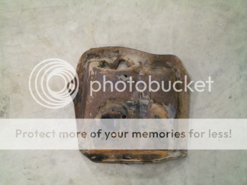

This is one rusty bucket. Note the big hole in it. I was very relieved that the frame under this was unaffected. Luckily the driver's side had a leaky power steering pump to keep it looking like new.

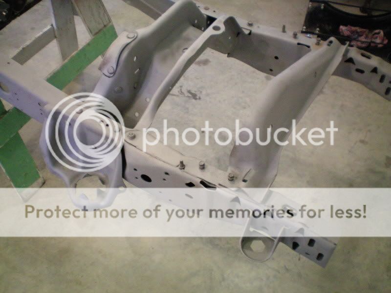

Sandblasted frame, still needs a few small touchups.

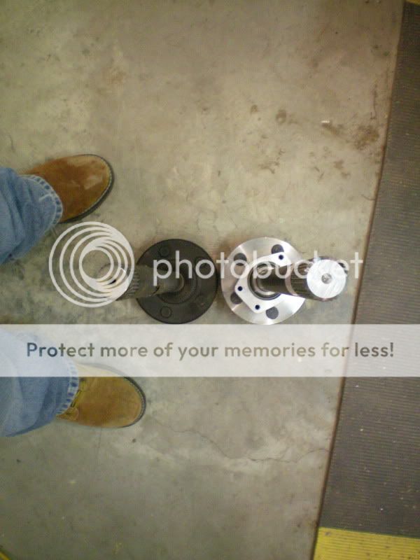

31 spline vs 28 spline

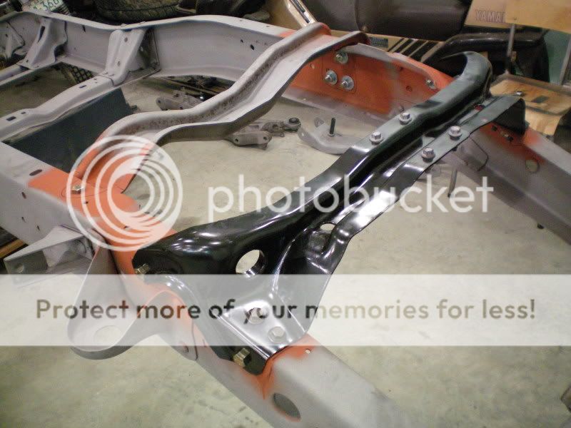

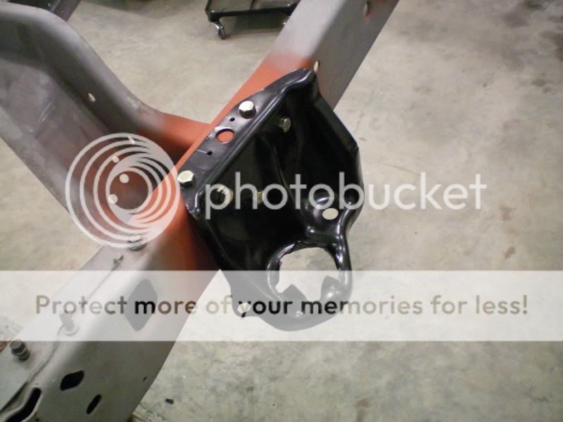

New crossmember and spring buckets. I sprayed red oxide primer under the joints so it won't bleed rust. The Ford paint on these brackets was kinda shitty, so I wanted to get them all painted together.

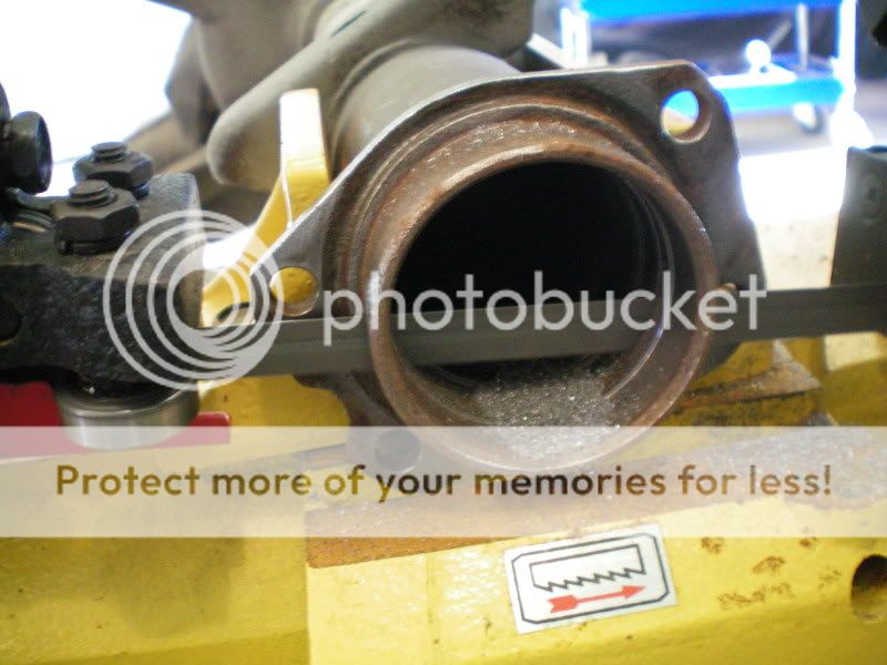

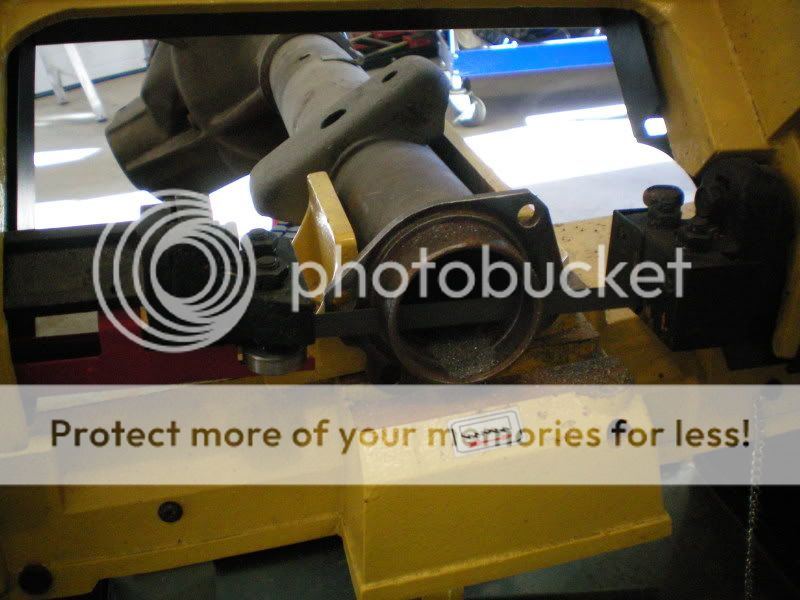

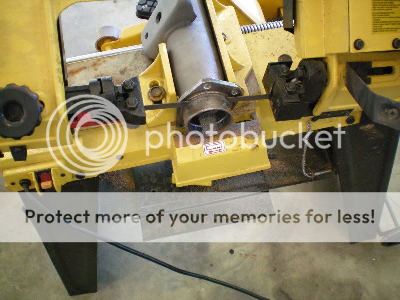

Cutting for C clip elims.
