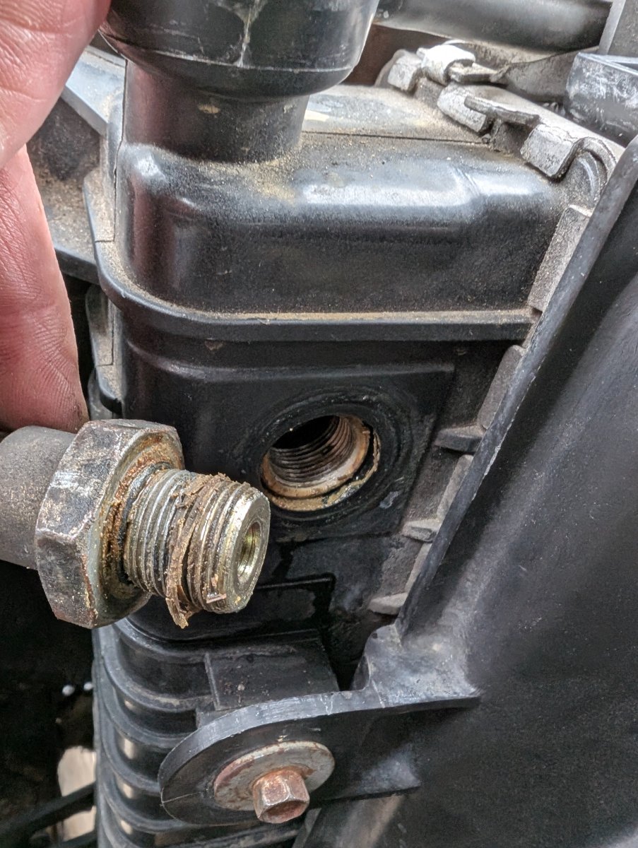

I have a 5spd with the auto radiator. You don't have to cap anything, it's just an aluminum reservoir that is sealed with pipe thread and an O-ring on the face. Mine was leaking so I had to put in a new O-ring and some pipe dope on the threads.

IF I'm following you, this extra "reservoir" (which should just be filled w/ dead-air on a 5-spd) suffered a cross-over LEAK from the main coolant-filled part of the radiator, and if your truck had been equipped with auto trans, said trans would now be contaminated with anti-freeze and water, "milkshaked" in with the ATFluid??? 🤯
No, it was leaking from the O-ring which seals the coolant inside the plastic tank. The pipe thread was still tight and would have kept coolant out of the transmission fluid.
