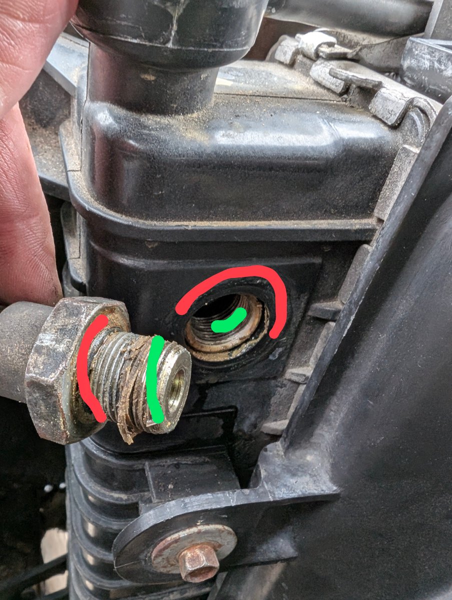

The only way coolant could leak into the trans reservoir is if the the O-ring face bottoms out before the pipe thread gets tight. I wouldn't doubt a cheap aftermarket radiator would tap the pipe thread too deep and not seal as the O-ring face gets tight.
No, it was leaking from the O-ring which seals the coolant inside the plastic tank. The pipe thread was still tight and would have kept coolant out of the transmission fluid.

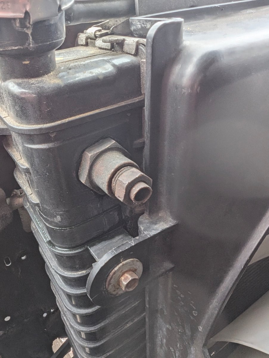

You don’t have to plug the ports. I try to do it to keep dirt and mud wasps and stuff out on my manuals usually. Sometimes I don’t and get mad at myself for that. I have automatics that fit the same rad, I like the idea that I could potentially pull plugs and stick the rad in another truck if I’m in a bind. For the record, I’ve never had to do that yet because rads don’t usually last long enough to be in that position, lol.

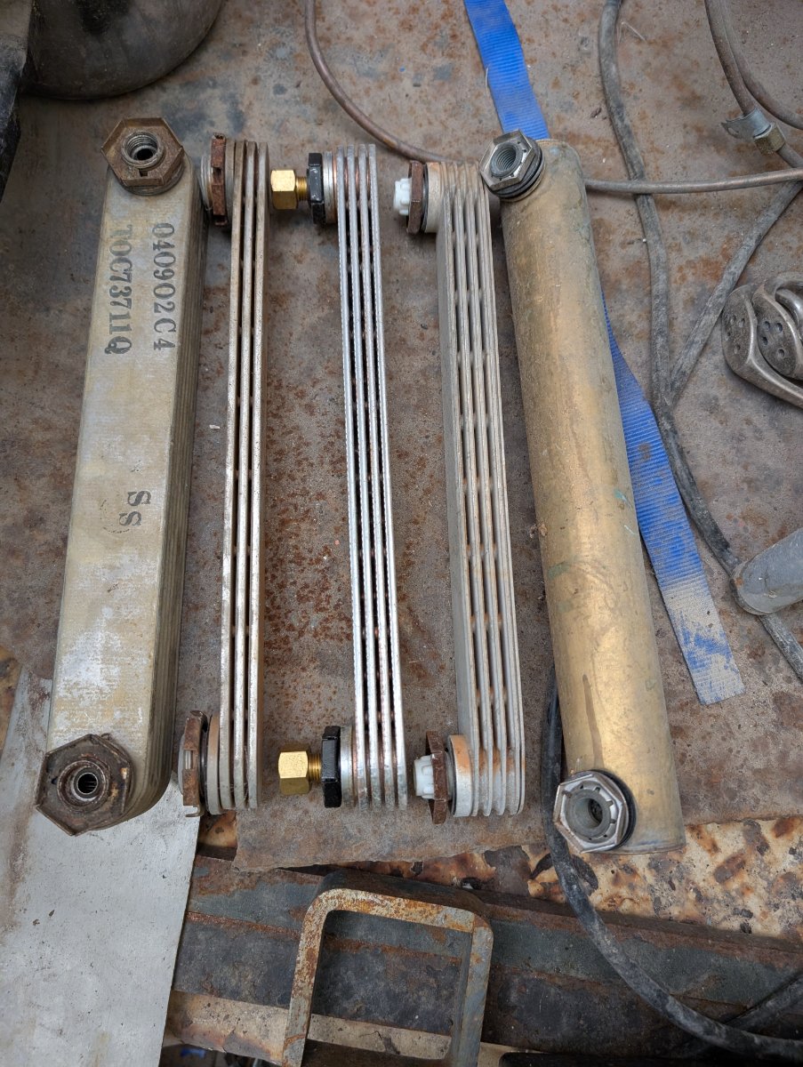

I’ve removed the tank before, that little trans cooler thing is a tiny radiator inside the side tank.
That threaded thing with the O-ring serves as a connection to pass fluid (it’s a pass-through bulkhead fitting), as a mounting (it holds that little radiator inside place inside the tank), and as a seal. The trans cooler lines thread into it or you can thread a plug in.

Some of you geniuses have never cut up an old radiator, and boy does it show.
Why do you say that? I will take some pics of the transmission coolers that came out of a variety of rads...
Stay tuned...
Don't worry about it, that's just the standard level of hostility you get east of I-495. :ROFLMAO:
Don't know about east of I-495, but it does seem to be about the standard quality of post that you get from certain members.
So anyway now that we have some pictures, other than the core itself leaking, what is the leak path people here are so concerned about?
