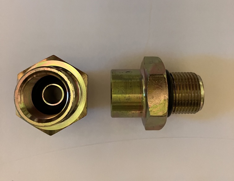

I’ve removed the tank before, that little trans cooler thing is a tiny radiator inside the side tank.
That threaded thing with the O-ring serves as a connection to pass fluid (it’s a pass-through bulkhead fitting), as a mounting (it holds that little radiator inside place inside the tank), and as a seal. The trans cooler lines thread into it or you can thread a plug in.
Got me a Torxe brand (yeah, I never heard of 'em either) single-core rad from CarID.com (saved me about $25 over cRock Auto!), and it's got separate hex ring-nuts that hold the ATF cooler to the inside wall of the tank, but it also has these spendy looking 5/8-18 UNF nipples/bulkhead fittings, with O-rings on both the male and female threads!
Gonna keep those aside for some future "performance" mods, since they don't plug the ports anyway... I'll find something much cheaper to plug those holes with.
