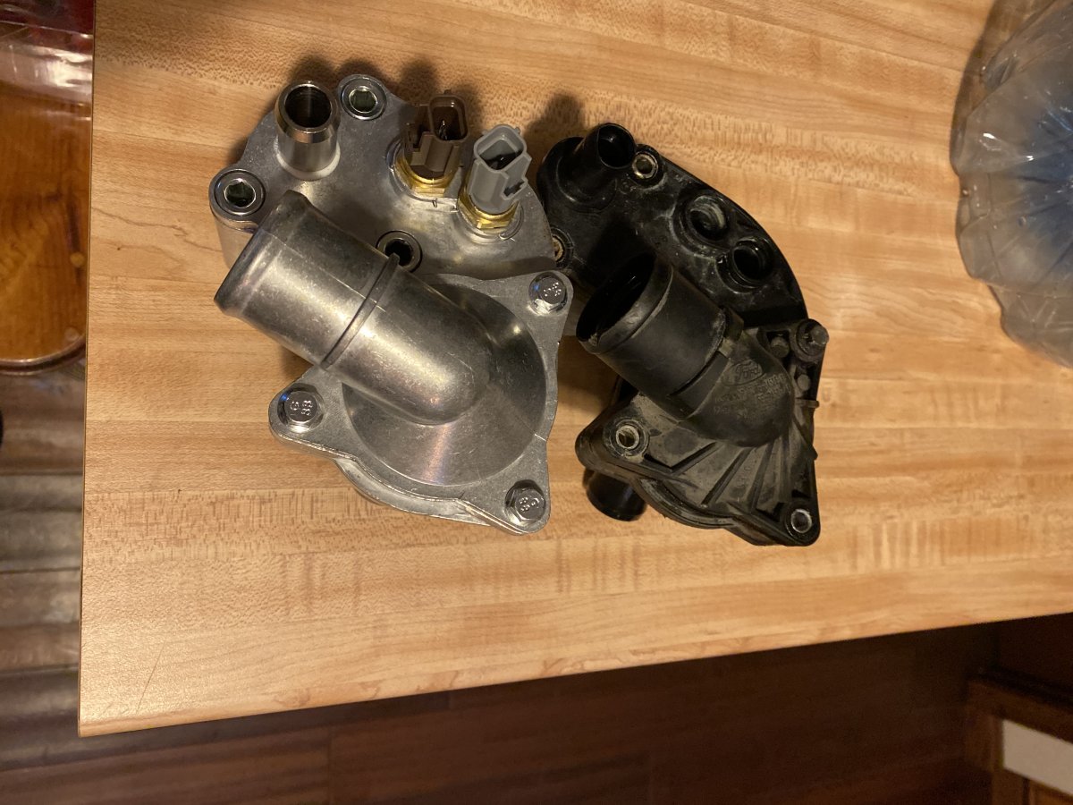

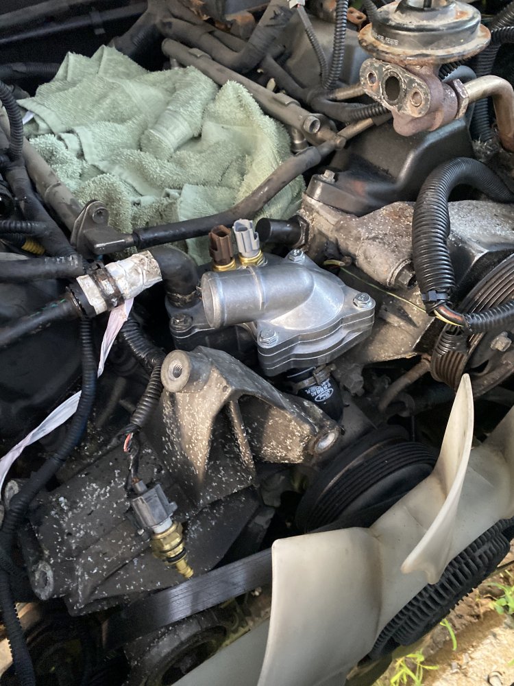

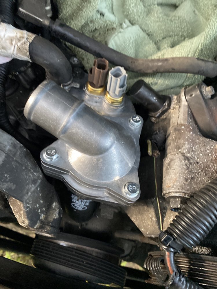

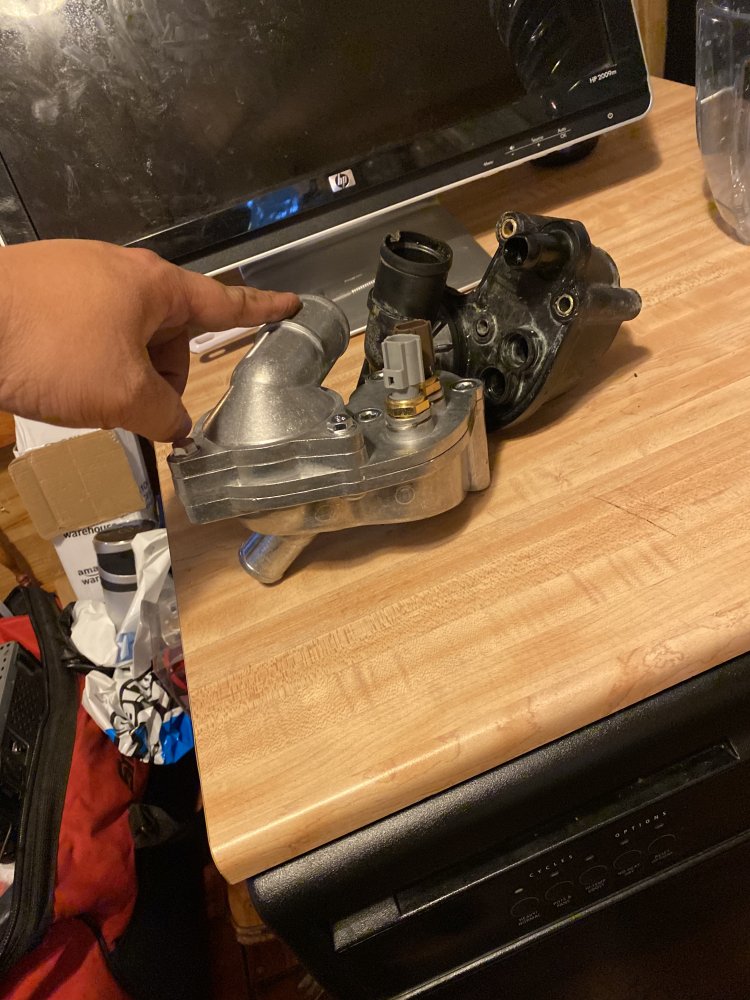

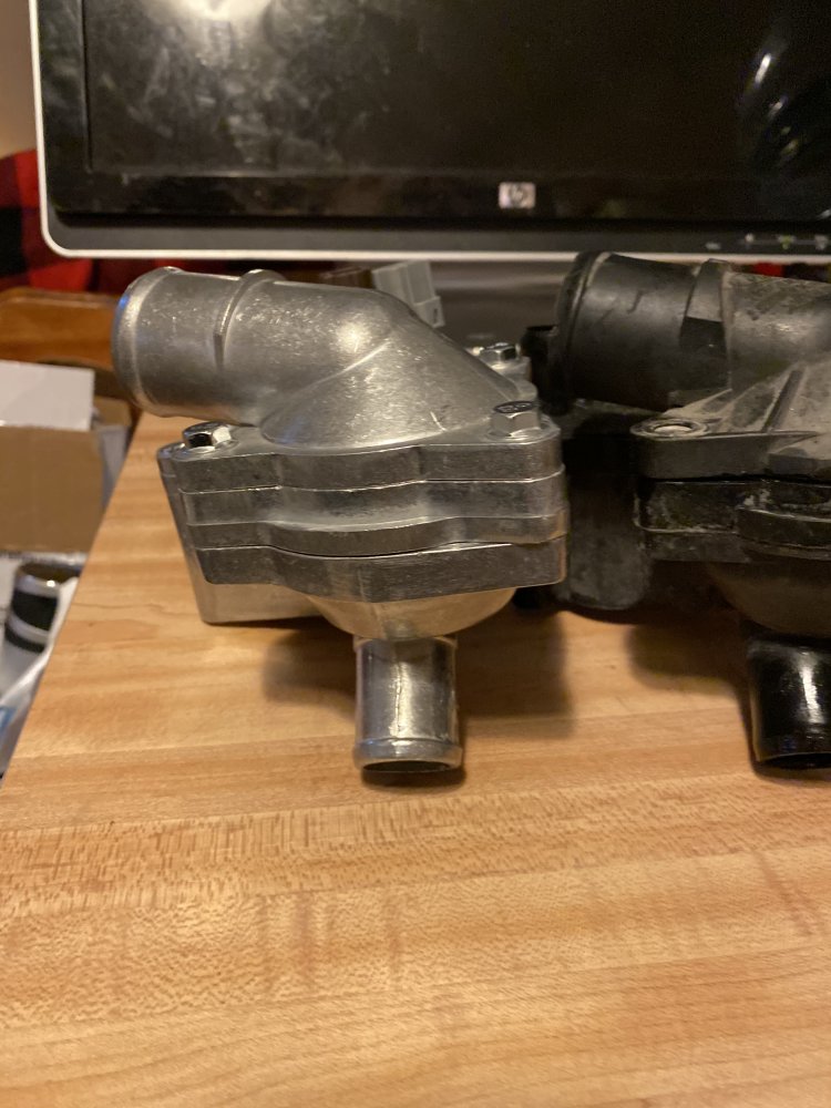

The SOHC 4.0 in the Ranger (and I believe the explorers) came with a plastic thermostat housing that is prone to fatigue and failure. Well mine failed last week in my search for the best price on a replacement i came across a SPK part on rockauto that is Aluminium. It comes with new sensors and and thermostat. For around the same price as the oem part

I’ve done this upgrade. Not cheap but better to do “one and done” than replace the plastic housing over and over again over time.
The one I ordered was for a single sensor with a plug in the unused hole. It also came with all the needed o-rings and gaskets to do the swap.

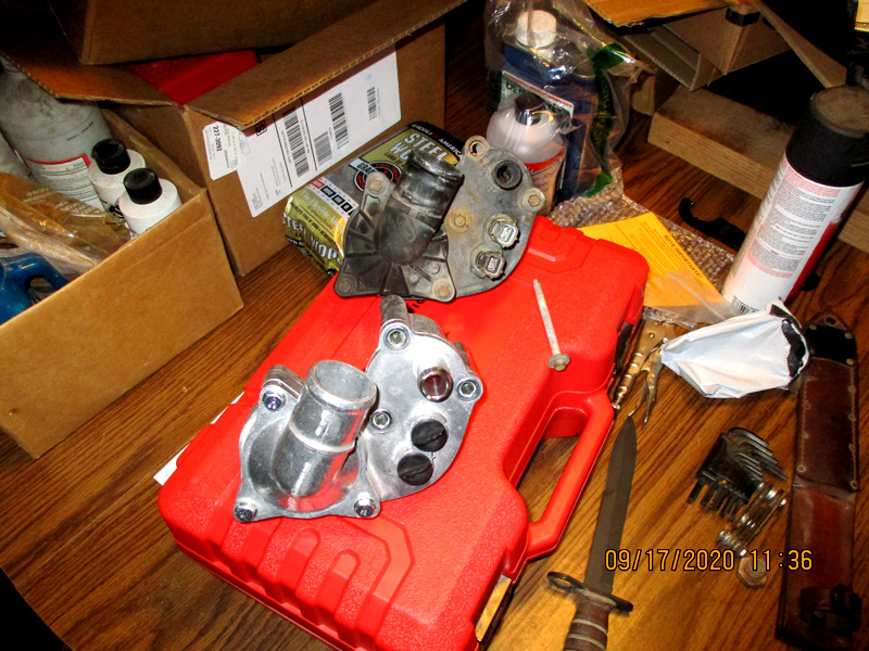

A little update; I got my new thermostat housing (no sensors, SKP SKRH144C) today. It seems very well made, but.... The openings for the sensors on the new housing are a little larger then the OEM housing, 0.530: Vs 0.505" The OEM sensors with their old flattened out O-rings just drop right in, so new O-rings are a must (I'm guessing oversized) It came with two plugs blocking the sensor holes, the o-rings on the plugs fit but not very tight, I'm not trusting them. Also the clips holding the plugs in are made of smaller dia wire and aren't as strong, you'll want to use the OEM clips.
All in all I'd recommend getting the one with the sensors already installed.

Concerning the sensor holes being bigger in the alum housing I bought, I ordered a few different size o-rings from Amazon and found the "8 mm ID, 14 mm OD, 3 mm" (3x8mm or 0.118 x 0.315 In.) viton o-rings fit with some wiggling and using the OEM clips (the clips that came with the housing were smaller gauge and not as strong), rated for 350*F.
