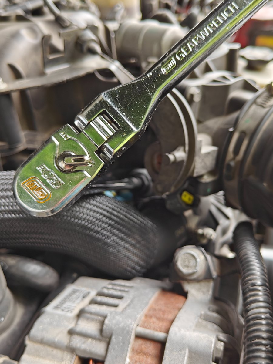

The intake manifold is a real PIA! I have a Craftsman deep well socket for the tensioner and it hits the bottom of the manifold before getting to the "bolt" part of the tensioner. I was able to use a 27 mil combo wrench on it but can't get the room to crank it down.

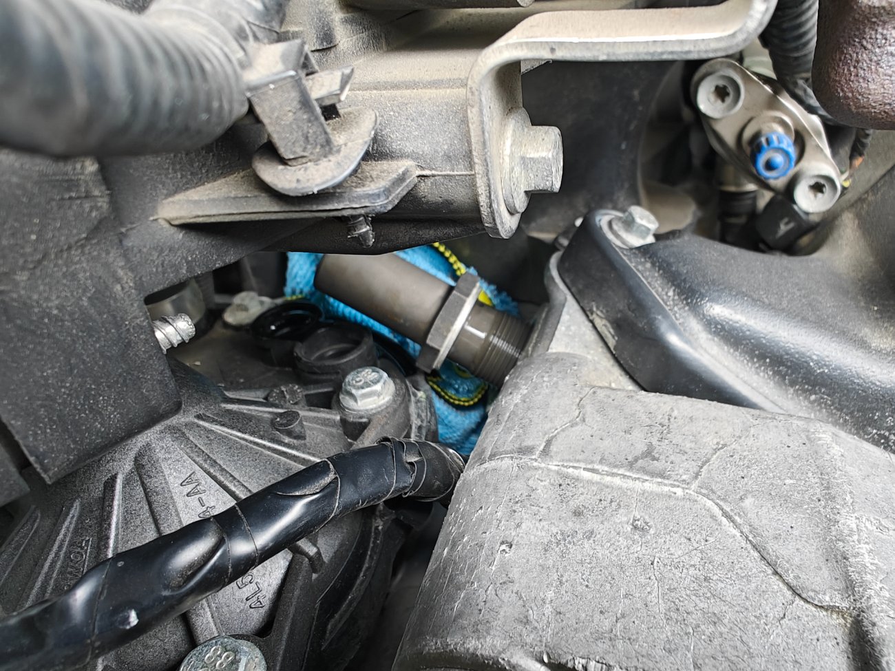

I was able to get the front tensioner off & I installed the new one this weekend. I'm in the middle of doing a thermostat housing replacement and with all that stuff out of the way I was able to get a deep 1-1/6 socket on it for removal. And a torque wrench on it for the install. Just needed a 3" and a 1" socket extension IIRC.

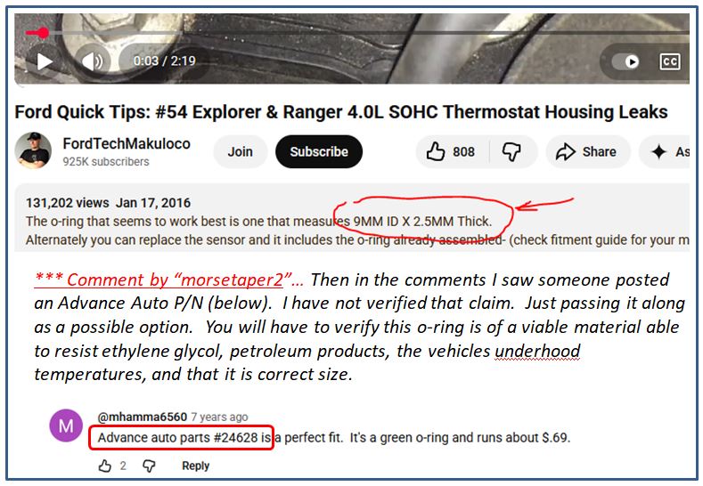

And for the sensor O-ring, over on Ford Tech Makuloco's youtube channel he states that the sensor o-ring (not sold separately by Ford, only comes on a new sensor) is a metric o-ring with dimensions of 9mm ID X 2.5mm thickness. I measured the sensor o-ring that came w/ my Simmonz replacement thermostat housing and it was a match.
You can buy 10 of those o-rings in viton (resists ethylene glycol, petroleum products, and other chemicals, good to 400*F at Mcmaster-Carr for about $5+$10 shipping for 10 pcs.
9mm ID x 2.5mm Thk Viton O-ring @ McMaster-Carr
Or I imagine call Simmonz up and they'd sell you one or two.
Also saw in the youtube comments this o-ring at Advance Auto (p/n 24628 & T24628) in some sort of green rubber used in the A/C system. No idea what the o-ring material is though. Don't know if it is suitable for use with ethylene glycol & petroleum products?
Green O-ring p/n 24628 & T24628 @ Advance Auto

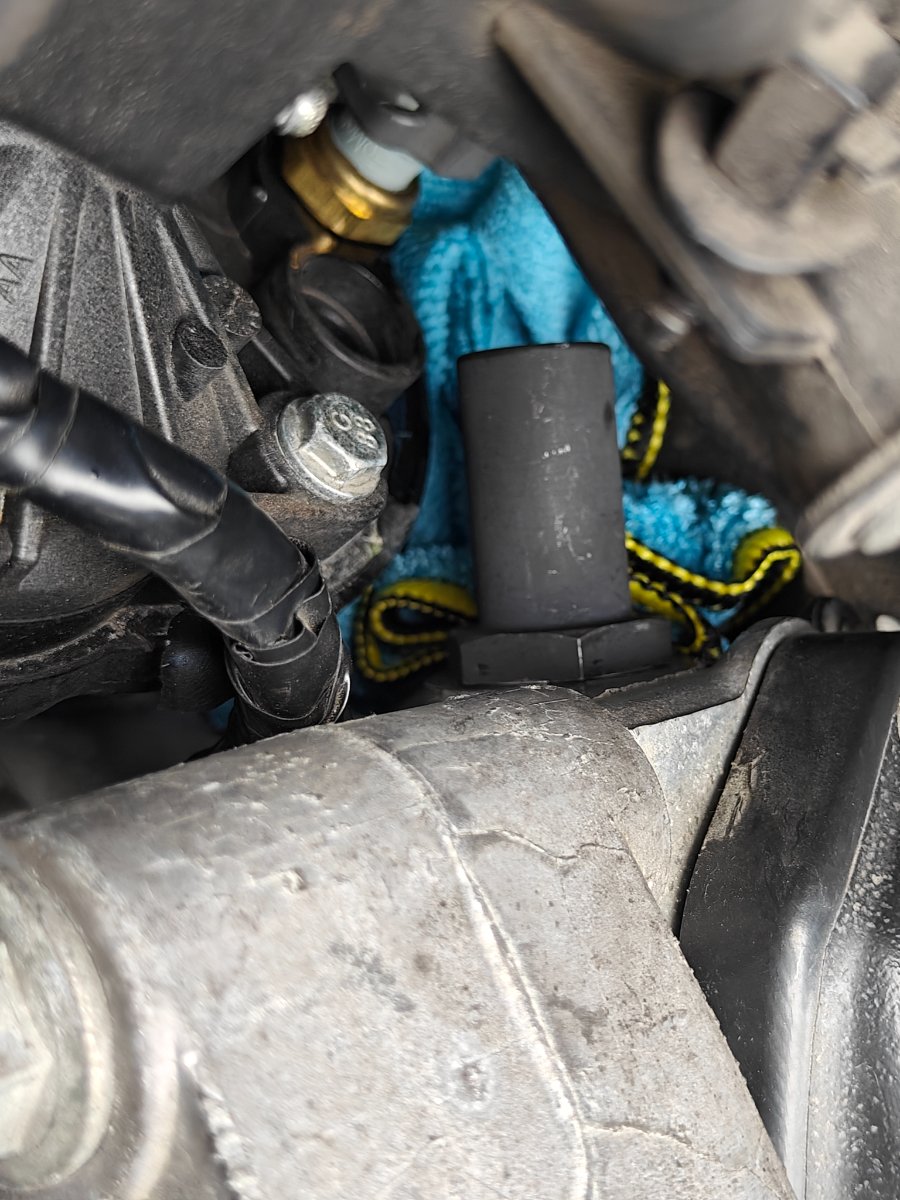

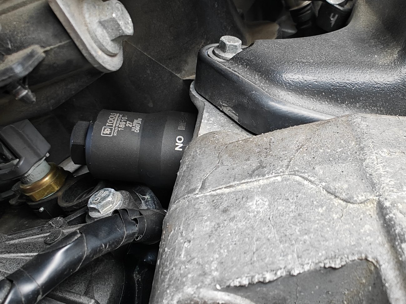

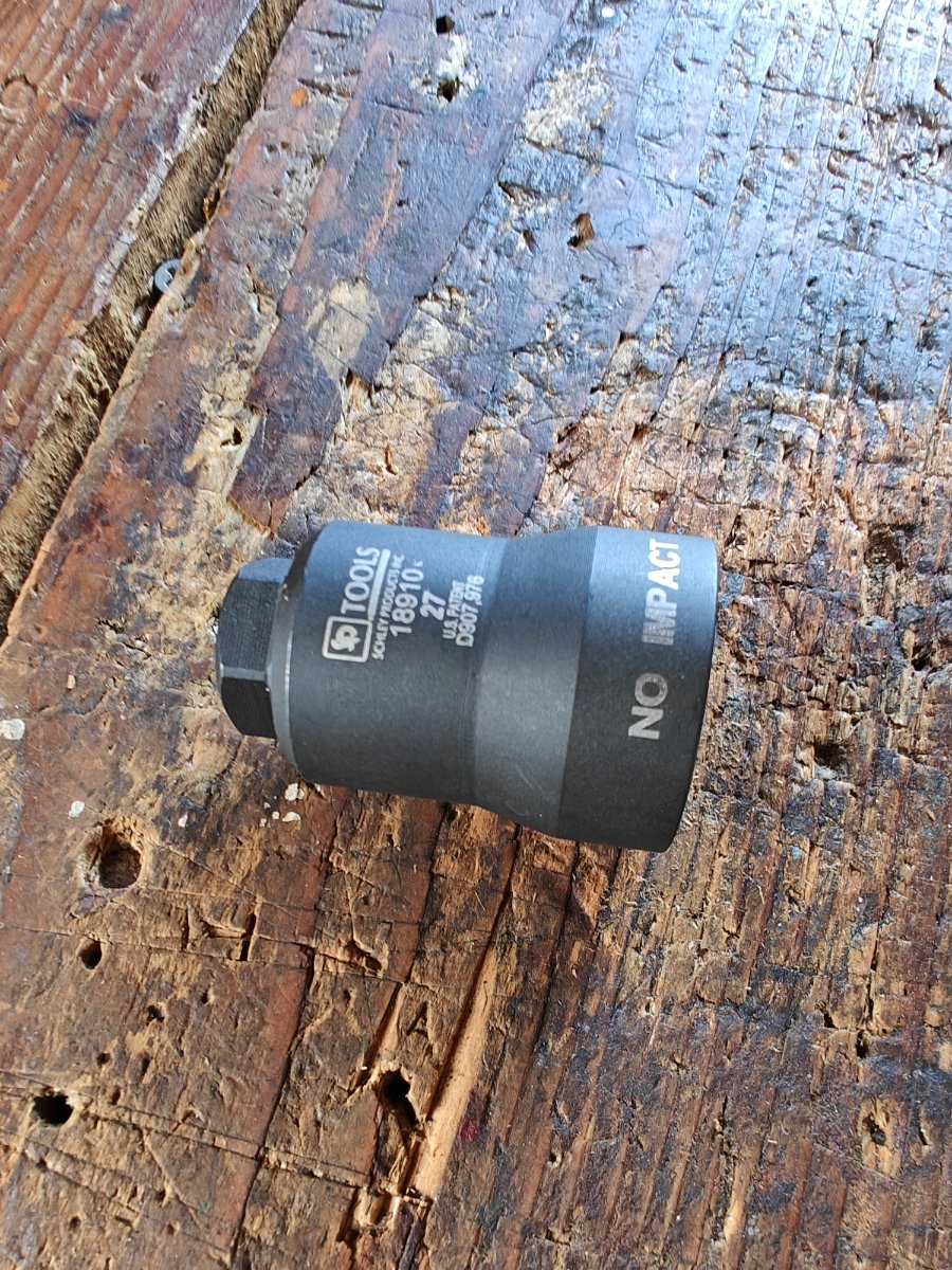

I got this socket to try to change my tensioners. Every 10th start or so I get a weird noise on startup that could almost be called a "rattle" and I'm wondering if it's my tensioners. Mine are new within the last 5k miles but I used Cloyes. Wondering if the springs are weak and not holding tension on every start until they get to full oil pressure.
Anyway, I'm hoping with this socket I can just remove the coolant temp sensor and get the front tensioner replaced. It looks doable but I won't know until I try. No big deal If I have to dig deeper to do it either way.
It's been months since I did mine so all I remember is it was very tight in there and I thought it might be difficult to do w/o the thermo housing out. Since my thermo-housing was leaking and being replaced, it was EZ to change that tensioner once it was out of the way. That socket w/ the hex might be real useful there for you.

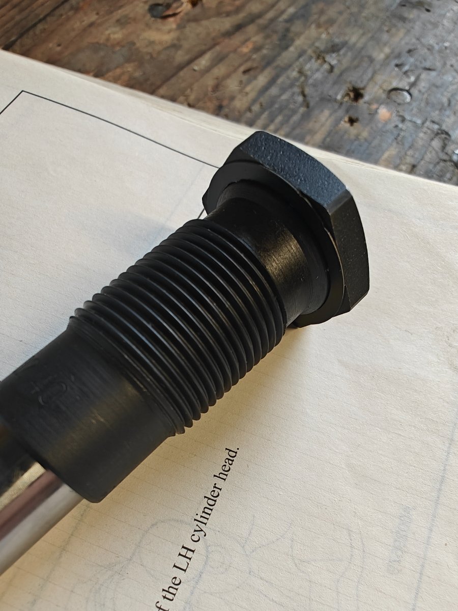

Hey Morsetaper, did your tensioners come with these flat washers already installed? Are these considered the crush washer? My Cloyes tensioners had very thick aluminum crush washers and I can't remember what the tensioners that I originally took off the engine had. Just wondering if I need to add more or run these as is?
SOHC 4.0 thermostat housing upgrade
Is that an actual genuine Ford part? Both mine (L&R genuine Ford parts) came w/ thin seal shims that looked like that, pre-installed on the tensioners. And they looked the same as the ones I removed w/ the old tensioners.
I had actually ordered new seal shims along w/ the tensioners at the dealer parts counter. I didn't know they came w/ one. And they looked the same as the ones pre-installed on the tensioners. So the Ford parts guy allowed me to return them for refund since not needed.
After removing both tensioners I verified that nothing was left stuck to the block, made sure that mating boss on the block was clean, installed the new tensioners, then used a torque wrench set to the correct final torque, and installed them w/o adding any addtl silicone, etc. And no leakage so far.
So just install it "as is".

My replacements are OEM Ford tensioners.
At one time the Ford tensioners did not come with the washers. Good to see that's changed.

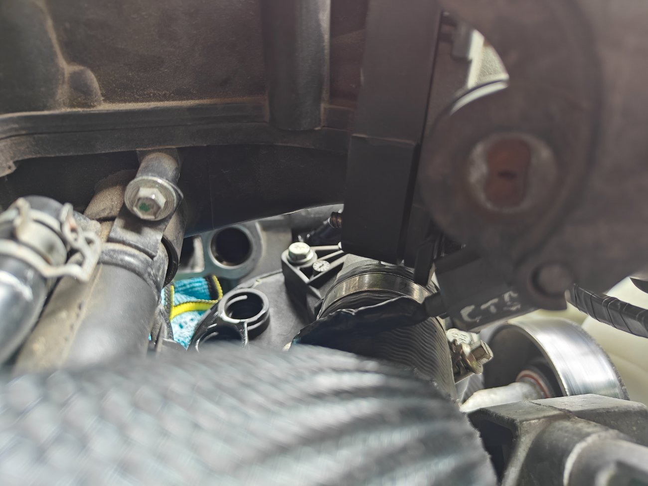

Wow, I guess I was all worried for nothing because the left tensioner literally took me five minutes. I feel bad for the guys that have 2 coolant temp sensors because I guess the driver's side won't come out with the intake in place🫪
