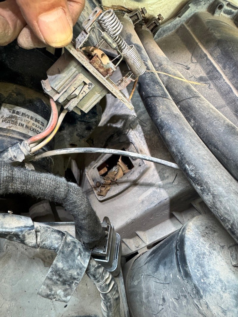

Leaves in the Blower fan box, and some were on the Resistor Block on startup so burned
Pull off the blower motor in engine bay, 3 screws/bolts, unplug its 2 wire connector and rubber elbow
Look and Reach inside and see what stuff is in there, clean it out
Next to the blower motor, toward drivers side, is the resistor block, fan speed control, 2 screws/bolts, unplug it
Remove it and have a look, blow it off, if it looks OK reinstall it, if it looks burnt get a new one
Resistor block runs VERY HOT, which is why its put inside the blower box so the fan can cool it down if its on, if fan is not on then resistor block doesn't get hot :)
And your fan was on or "smoke" wouldn't have blown in
Rubber elbow is an air vent for the electric motor so it doesn't use engine bay air that could have exhaust or other unpleasant "odors" that could possibly end up in the cab vents
Typical blower motor resistor assembly. Those springs are the resistors, they get red hot.
