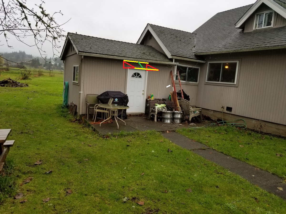

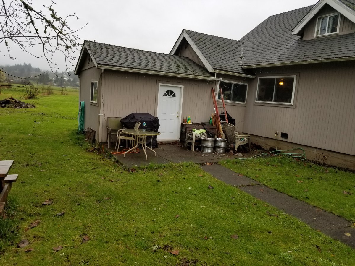

I have a pellet grill that keeps getting wet and the auger plugs up, it's annoying to clear out... plus if I had some rain cover on the back deck thing it would be kinda nice... The problem is this deck is right in front of the kitchen window so I don't want to cover up the whole view... Keep in mind this is on the down wind side of the house and there's a 1' overhang on the roof next to where I'm talking about
So here's my thought, I have a bunch of 3' lengths of metal roofing and a fair amount of some light gauge 2" steel square tubing. If I made two perlins out of the tube then made 3 brackets to lag bolt to the wall that are 3' tall would that be sufficient for a 3'x15' with about a 2-12 roof slope? This would mount the roofing just under the gutter on the house. I could do 4 brackets, I would just prefer to not do any posts... I'm in western Oregon, snow load shouldn't be an issue as it's been years since there's been more than 3" of snow and even that is rare...

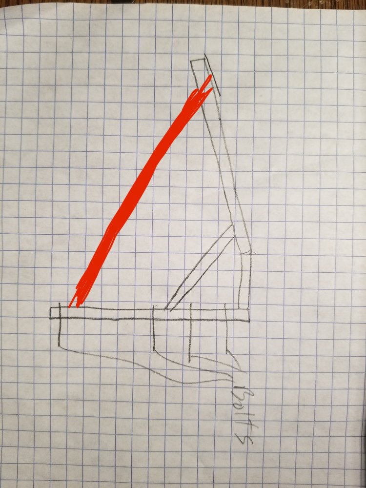

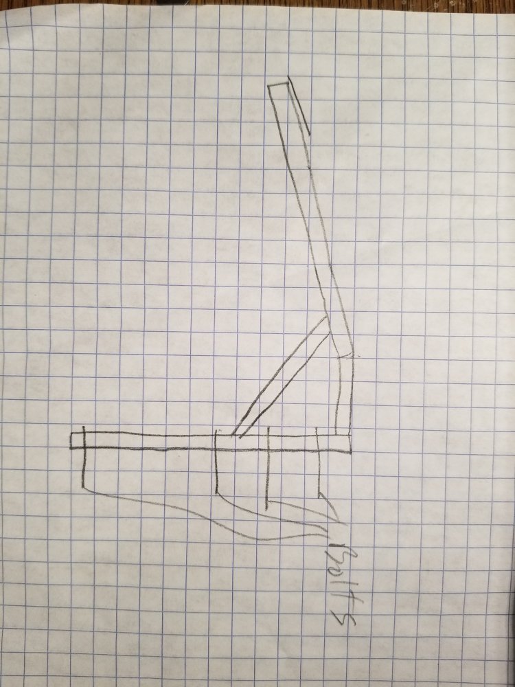

Ok, here's a pic of where I'm talking about and one of my sketch, it is sorta to scale at 4 boxes to a foot but I haven't taken any real measurements other than that gutter is just over 14' long... as you can see by the gutter line height compared to the door I don't have much height to deal with hence the shallow pitch...
I would tie it into every other stud and have full or near full length supports on both ends like this.
4 1/2” or even 3/8” lags will hold it no problem. Built like this i would guess the sheet metal roof would give before the frame work.
A triangle is strongest, but i dont see a need to go all the way to the bottom of the upright. Keep the brace level IMO.

And i dont see a need for the kink in the top piece.
The kink in the top was just to go out from the wall and meet where the gutter is for the metal, the gutter is mounted to a fascia board so I gotta get to that... but yeah, that wouldn't be necessary, I'll play with it.
For the brace I imagine splitting the difference would be enough, it'll be fully welded 1/8" wall 2" square tubing since that's what I have, all I have invested in the material is 3 hours grinding it apart from what it was originally... and the metal roofing I got in a pallet deal and is what is left over from building a 12'x20' lean to for my tractor several years ago...
Even every other stud is only 5 supports, I gotta do an inventory of the metal at this point...
If you run the roof panel parallel to the gutter you can save some material. Just screw the panel directly to the brackets. Put a very slight slope to the brackets so the rain water runs of away from the house. You can buy self tappers that have a washer and gasket meant for steel roofing over steel perlins.
Good catch. Definite need to pitch the top panel away from the house or there's potential for a lot of water damage (e.g. rain/snow). I see snow laying up there, melting closer to the house first - trapping it between snow and the wall, weeping up into the soffit and penetrating the wall necessitating a complete tear down and rebuild.

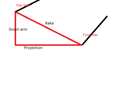

I've built and installed awnings for the past 15 years. I tried to do different colors to separate the 'pieces' . If the door swings out, you need a projection more than 36" to cover the open door. If it swings IN, no need for the 36". Too much projection and you'll need support. More drop add more support. Width would be whatever you desired. No brackets needed if you drill holes in the top back arm and the down arms.
69630
If you go through the frame, the lower on the down arm, the more strength from "up drafts" ( wind hitting the side of the house and going up into the awning.)
Feel free to ask ANY questions. I have over 10,000 hrs doing this type of work. (actull almost 20,ooo hrs)
