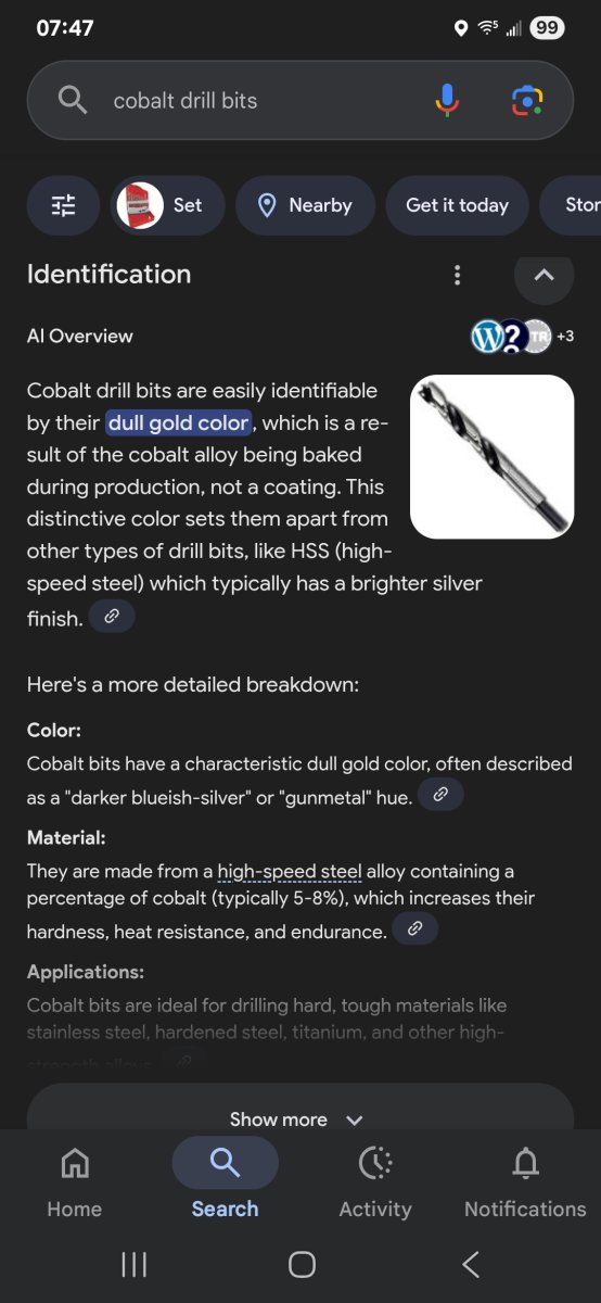

Cobalt is the name of the manufacturer, not the drill bit material. Typically "high speed steel" is what all decent bits are made with. I like the short ones. Mixing acetone with oil works to get into the smallest areas. The best penetrating product I've ever used is a very light oil mixed with a solvent.
No. It's not. Cobalt is one of the materials in the steel alloy used to make the drill.

I believe that @MaicoDoug was under the understanding that Cobalt was a brand name because,
like me he mistook the brand name Kobalt for the metal Cobalt.
I made the same mistake when I first heard about the metal named Cobalt.
Arggg....."Cobalt" was used as some sort of name for the drill bit product that Doug posted, (I would hardly say that there was ever any "cobalt" in any consumer available cutting tools) "Kobalt" is a china junk name that the largest pusher of china junk uses, lowes.
