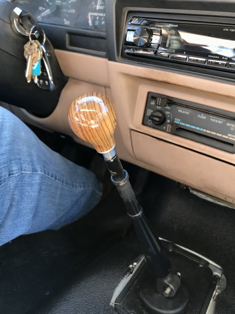

I bought this sweet knob on eBay. I measured the shaft at 0.583” with a couple spots up to 0.588”. Going to get a die and put some 9/16” (0.5625”) threads on the shaft. I think I’ll need to shave off a couple hundredths off before putting the die on. I read that you want to start at the target OD or a few thou smaller.
67757
67758
68058
68059
Wound up taking the lever to my local machinist. Paid $30 for him to put it on the lathe and put some threads on it… and they are some tight threads! No play at all! I didnt want to track down a die and handle, then figure out how to shave the diameter down with a thou precision. Would have cost more and probably turn out pretty shoddy.
