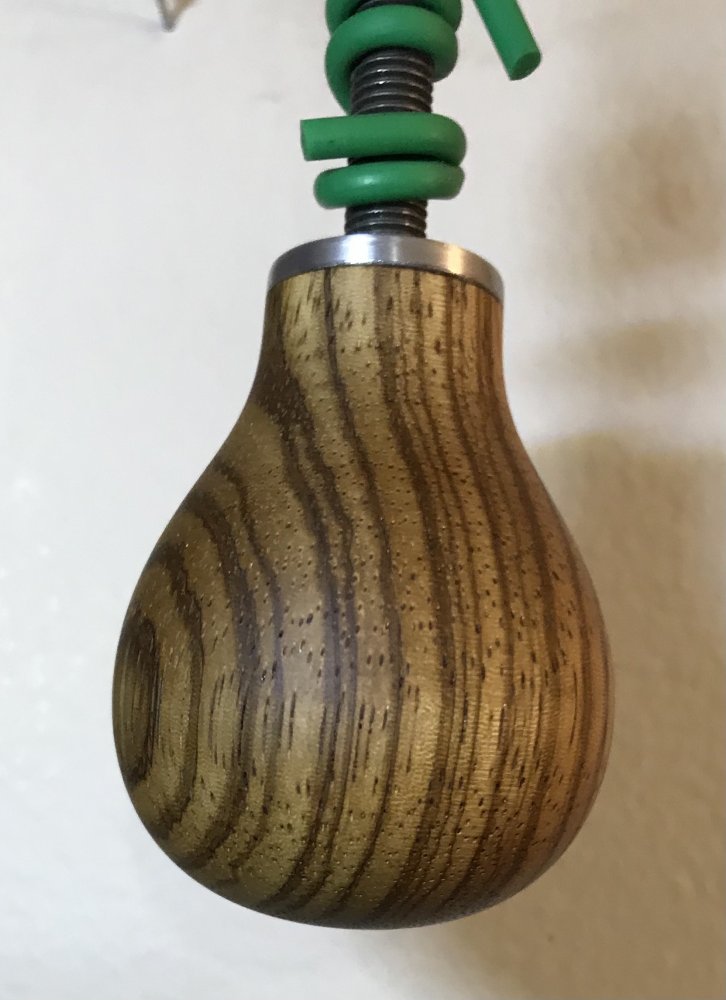

Glad you brought that up. I sanded it down and put on a new coat of urethane since it’s 30+ years old. Unfortunately it took a tumble at the machine shop and has a gouge in it now. Thinking of redoing it… again. From what I read, the toughest finishes are aluminum oxide and acid cured, but I don’t believe I have any possibility to do that. The next best was always urethane.
So why boiled linseed? I’m looking for something TOUGH so I don’t wear the finish off in a year.
Boiled linseed oil soaks into the wood and withstands abuse and oils from the hands better. Tongue (sp?) might be better since it’s used on gun stocks for the same reason.
If you want shiny, you can wax and buff it after you do the oil treatment just like they do with gun stocks. The down side is you might have to retreat it every year or so to keep the wood protected and wax it for a polished look.

I sanded it down to the wood and applied the first coat of tung oil. I got some minwax stuff that I hope is good, cause it’s all they had. I’m going to depart from you, sgt sand, and put the urethane on top of it.
This won’t be my only knob tho. I got it in my head, so I’m going to try my best at getting at least one produced. I’m going to try wood turning my own knobs. Set a nut in the bottom of a block of wood, put it on a drill and see what happens.
Edit: above I said I hope the minwax stuff is good because I read that buying “tung oil” that actually contains tung is kinda hard. I figure if it’s advertised as tung, it must give the desired effect of what people who want tung are looking for. I’ve been reading for a while and still don’t know the difference between varnish, stain, oil, shellac, and any other wood finishing products. Heck even “finish” and some other word that’s like finish but not that I can’t remember aren’t the same thing.

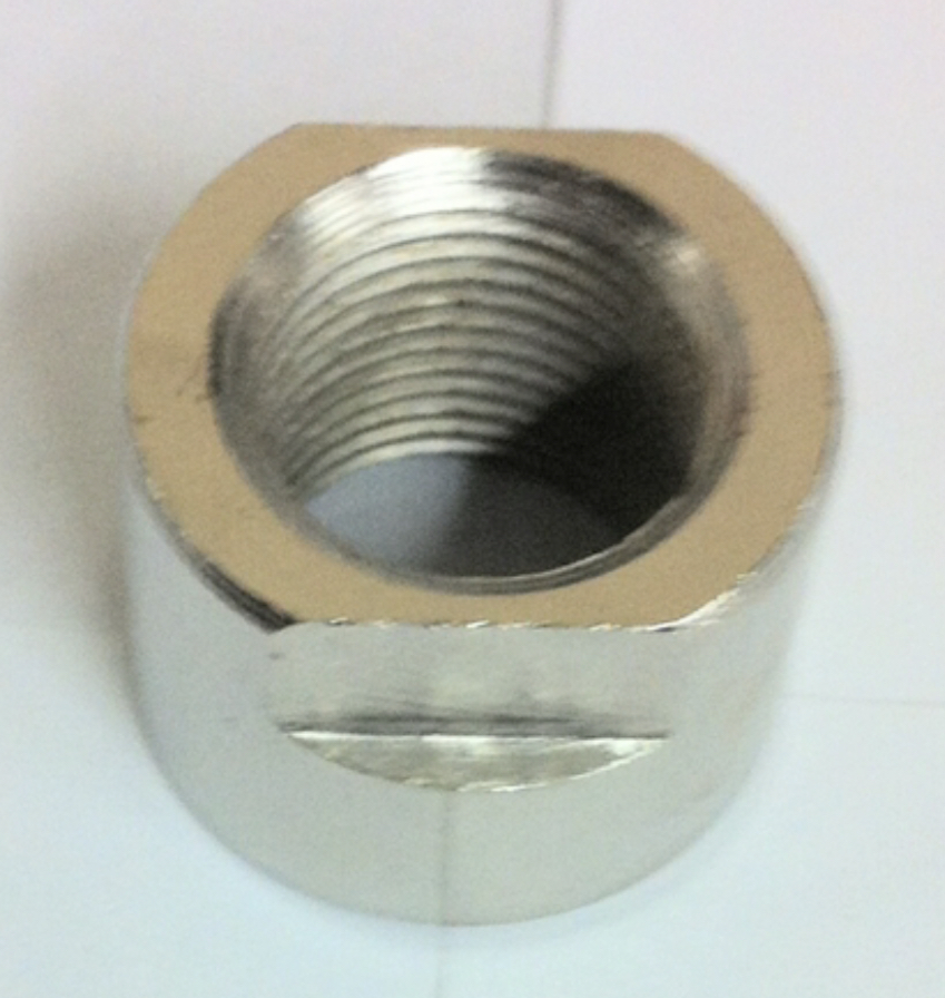

Now I need a nut so I can tighten the knob down and to cover extra threads. I’d like something that looks a bit more finished than a regular hex nut, but don’t know what to search for. What would this nut be called?
68355
Now I need a nut so I can tighten the knob down and to cover extra threads. I’d like something that looks a bit more finished than a regular hex nut, but don’t know what to search for. What would this nut be called?View attachment 68355
It's Probably called a female threaded bushing. But it's not really something commonly found. They are usually made special for each application.
You could make that, especially if you have a drill press.start with a chunk of round bar stock. Drill and tap on center. File or grind the flats to fit a wrench. 1 hour or less in the shop.

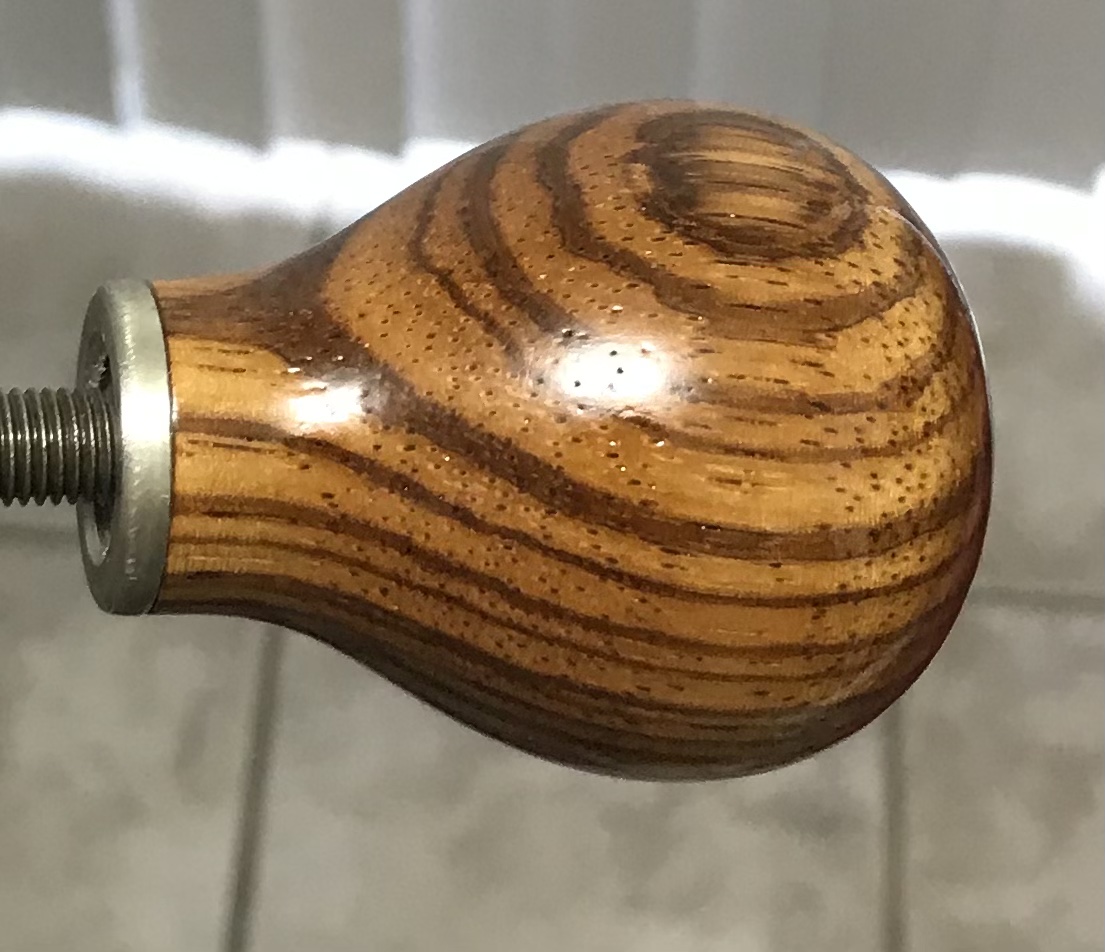

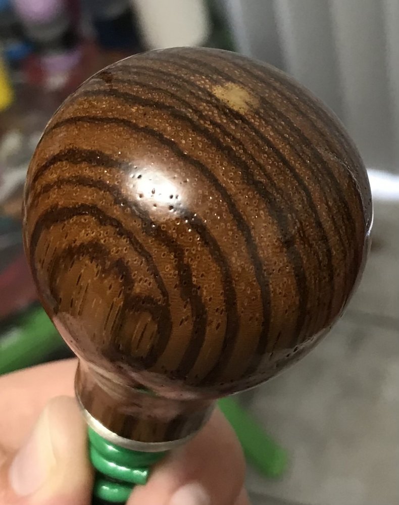

So here’s a pretty bad pic of the final product. I have a few questions for the wood folks.
What are these tiny divots in the urethane finish? I originally thought that was the end grain soaking up more material than the rest of the wood, but I’m not sure that’s the case after 3 coats. I’m using spray urethane, waiting 3 days and sanding in between coats. I’m wondering if it isn’t something the spray is prone to. I’m considering giving it a good sanding and putting a final coat of brush on urethane
What’s with that circle on top? That was there before I applied anything to the bare wood. No amount of sanding got rid of it.
the top half is a good deal darker than the rest. Is that cause the end grain soaked up more tung than the side?

Looks nice. The dimples are where the grain soaked up the material. Often, a filler material and sanding sealer are applied to help prevent or minimize that. At this point, just continue with light sanding and another coat or two of your finish and they should be filled.
that spot on the top is probably just some anomaly in the wood. Wood is a natural product and can have hundreds of different flaws and anomalies. That is what gives it character.
