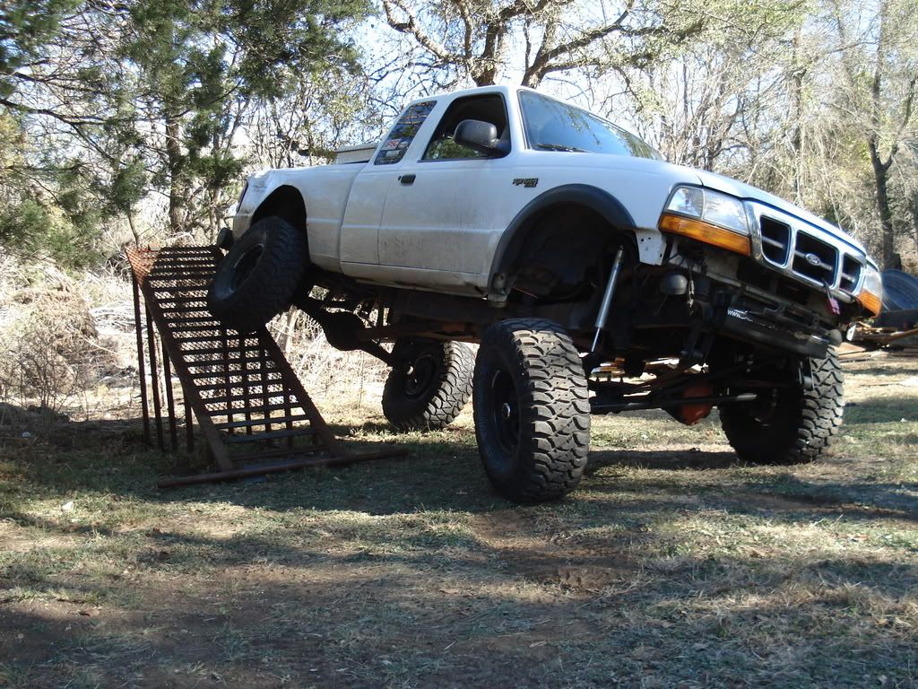

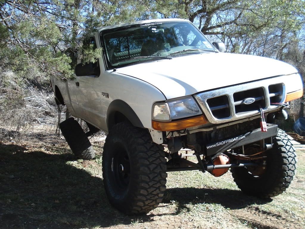

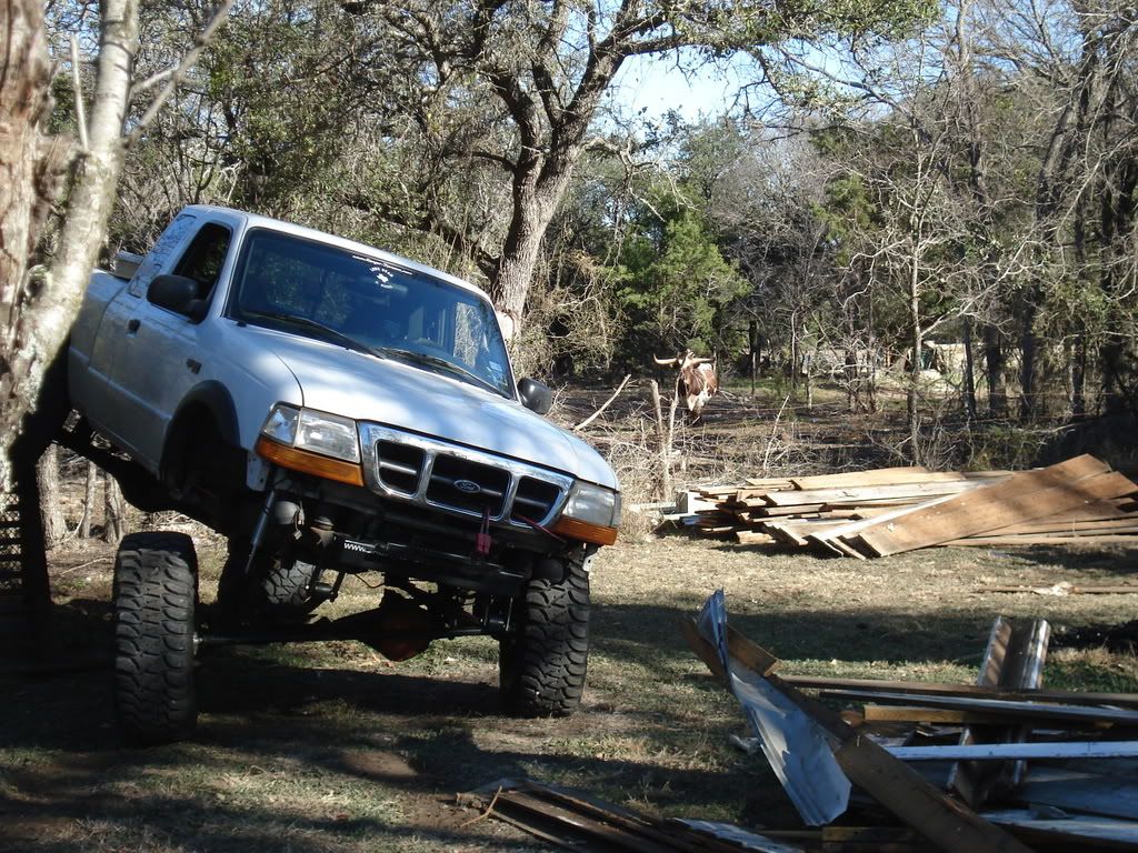

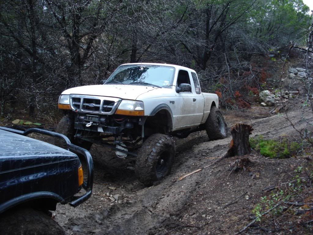

and some posing shots. my buddy did this one :icon_thumby: I've seen better, but for a $2500 sas its not bad.

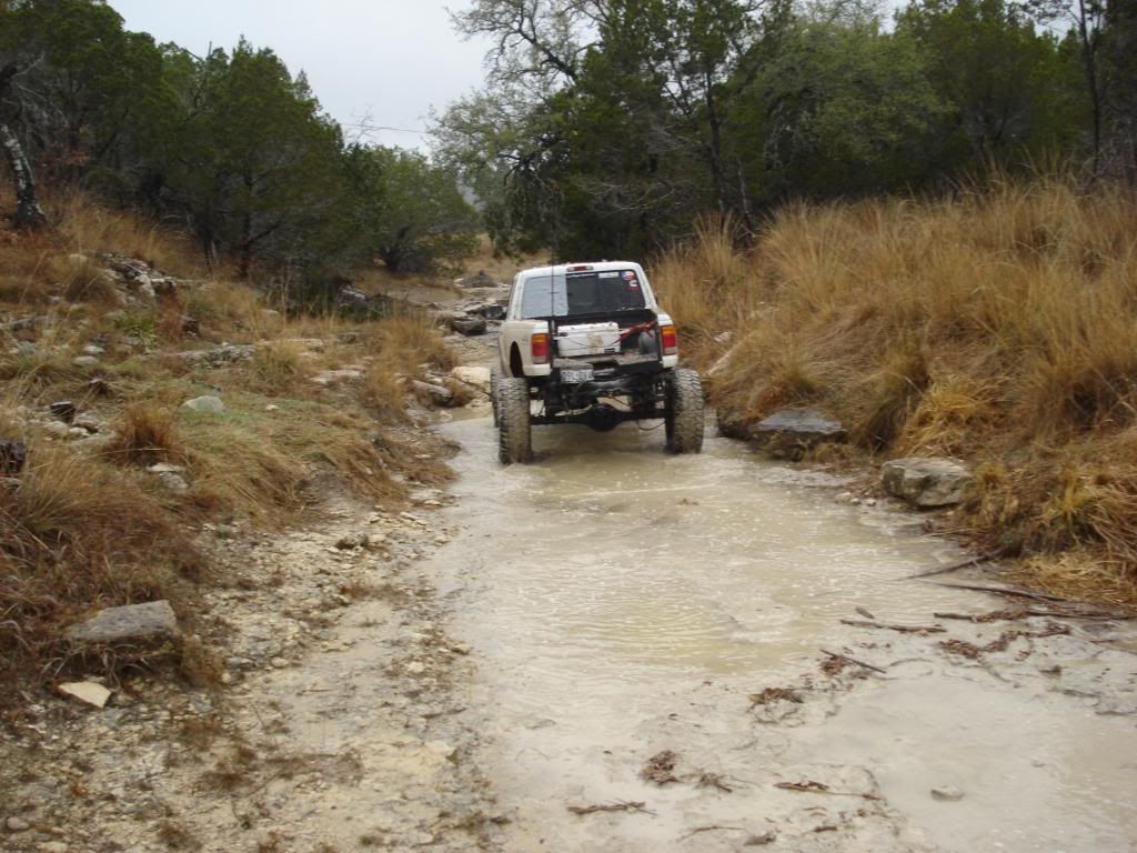

I still have some major rubbage when i stuff the driver rear tire. the gas tank skid and drive shaft rub pretty bad
and a longhorn decided to come say hey.

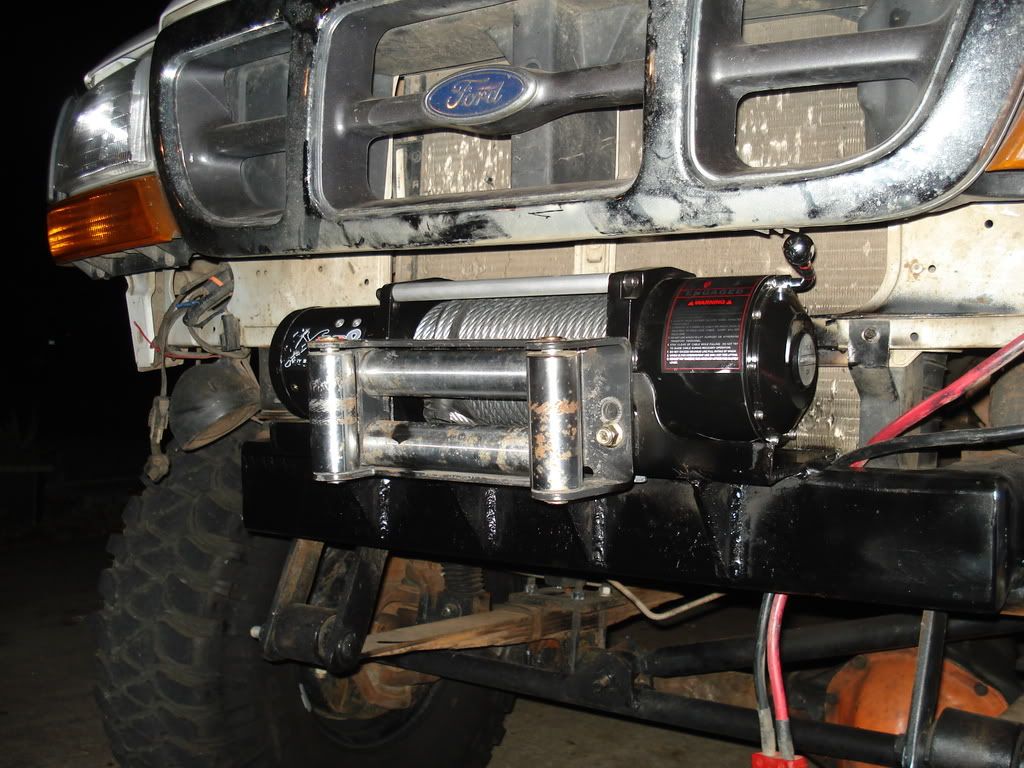

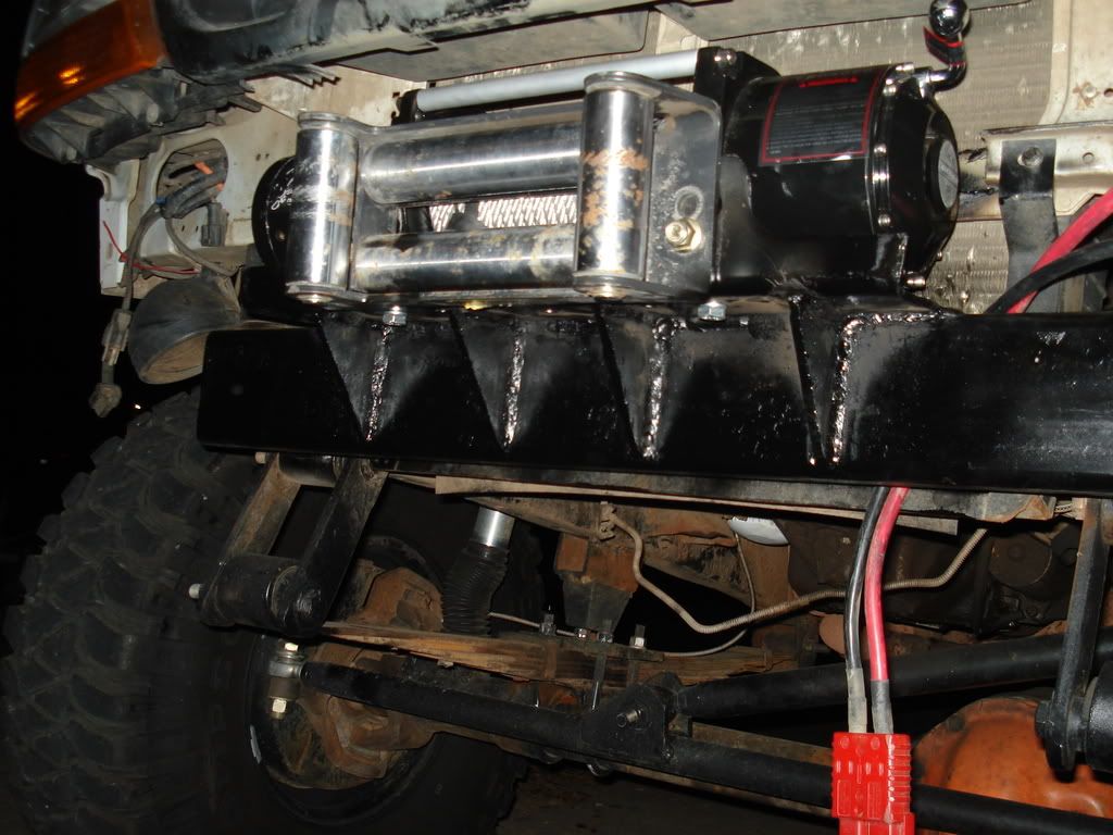

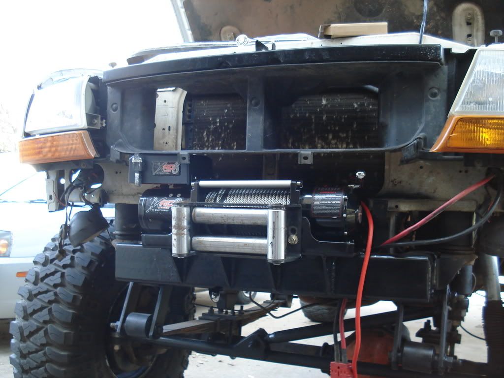

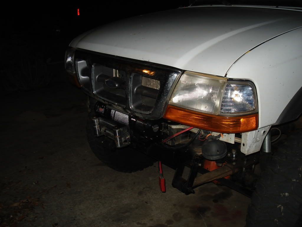

I welded up a winch plate with some bracing, as well as hacked apart the header panel and core support to squeeze the winch in.. but it fits :biggthump
and i put a rollerless fair lead on.. seems to work really good, and it doesn't stick out any farther than the grill which is very nice..

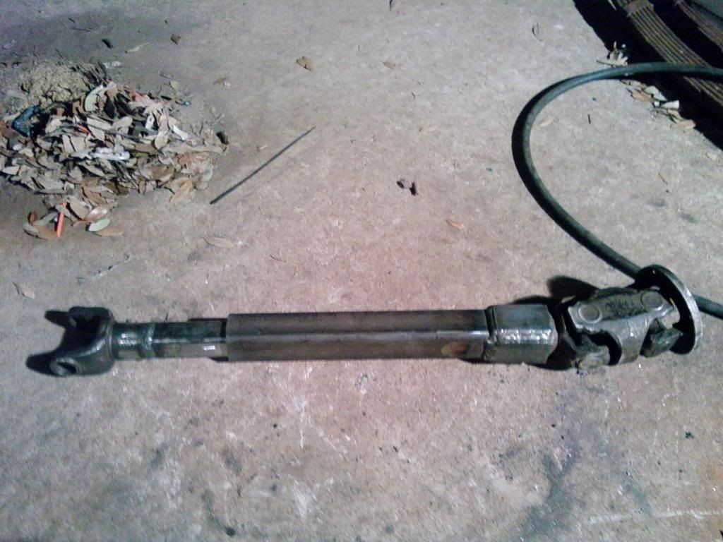

I had Kevan (badkarma) make me a square front drive shaft, i gave him a drive shaft off an old chevy/jimmy, he cut the ends off and welded some 3/16" wall square tubing in.. braced both ends, has solid stock on the inside thats been drilled into from the outside and welded up.. its not going anywhere..

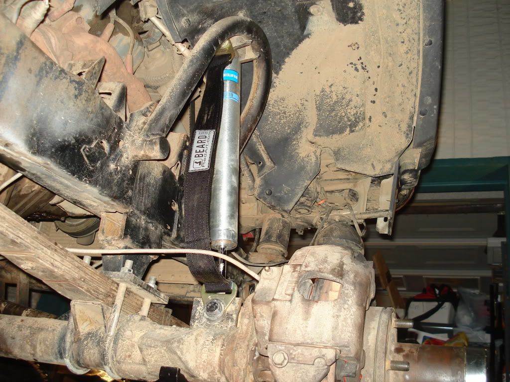

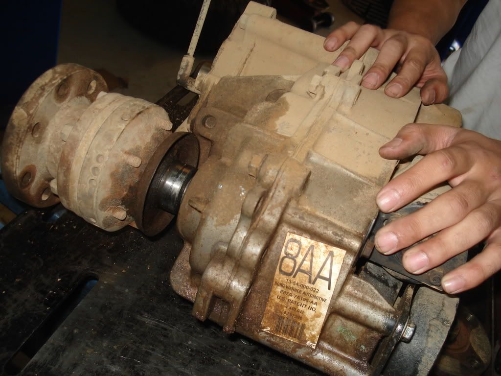

And since i ripped out the front output shaft on my t-case, i found out the axle went down too far for the driveshaft and made the t-case the slip joint :dead: so i got some 25" Beard/Red Art limit straps, they seem to have served their purpose, i didn't break the t-case on my last trip.

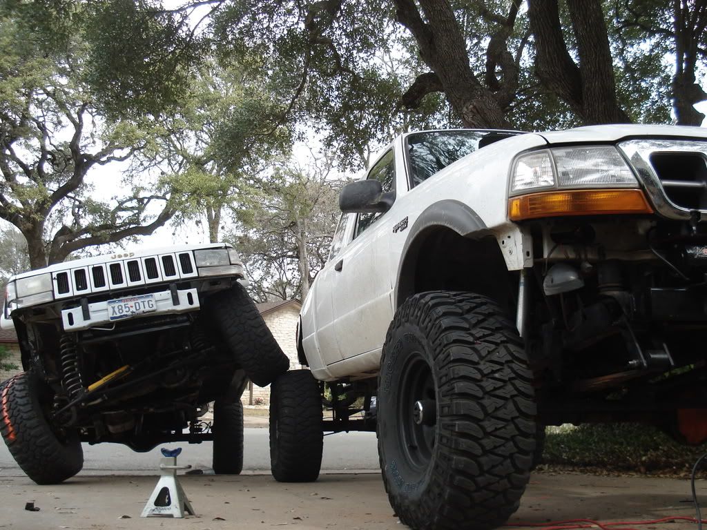

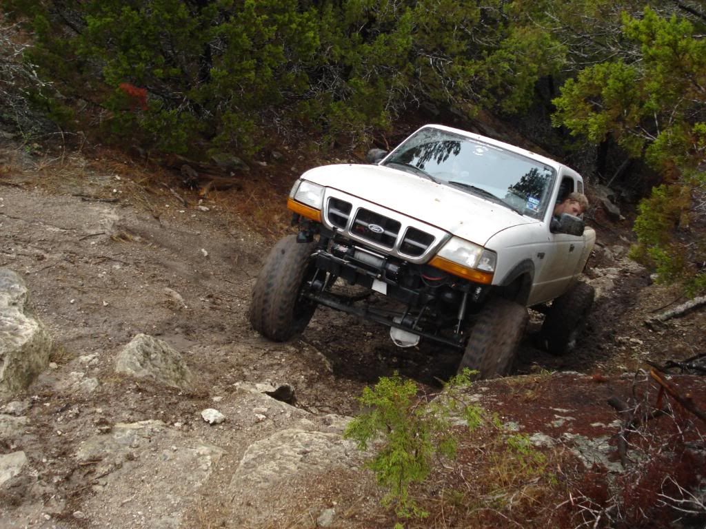

and heres what it looks like as of the last run out.

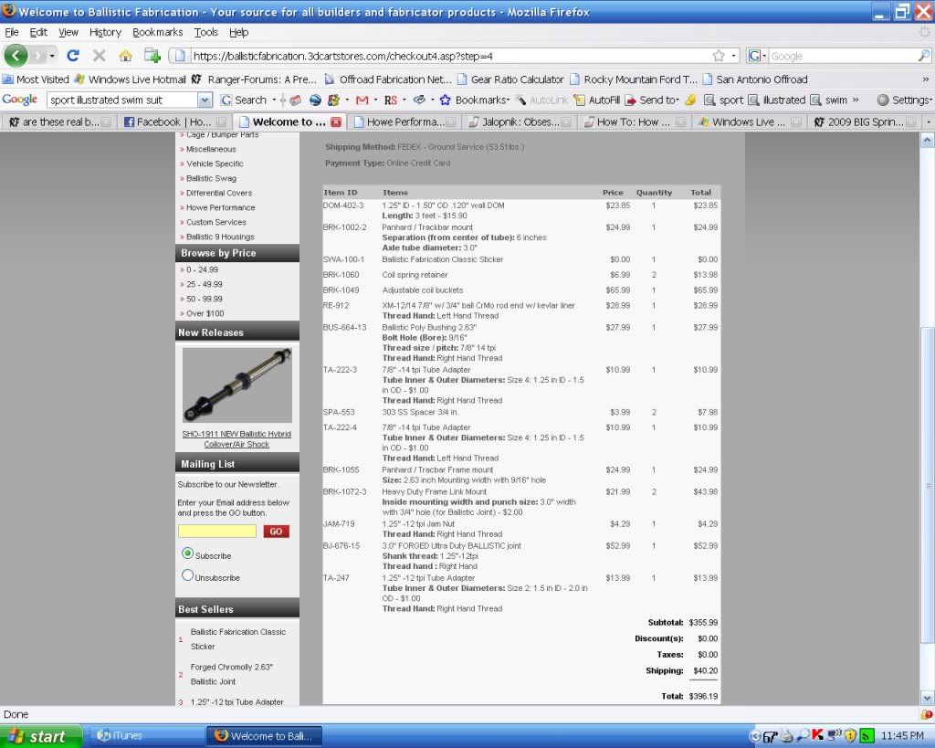

And I just put this order in.. Only coils/7º caster bushings and extended radius arms then a few days of work and I'll be sitting on 4" lift super flex bronco coils.
