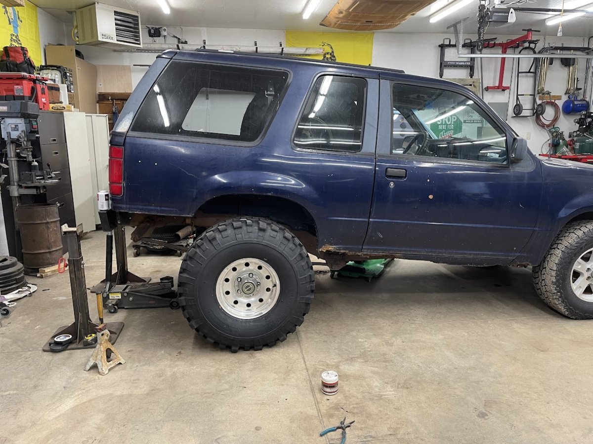

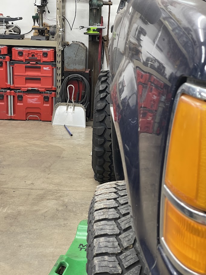

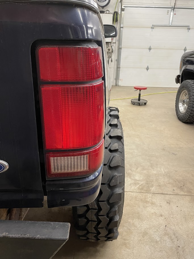

View attachment 120432View attachment 120433View attachment 120434
im looking to keep my wheels and tires and not wanting to spend a bunch of money (obviously an sas aint cheap) but i did find a 1998 tj dana 30 for 50 bucks nearby
