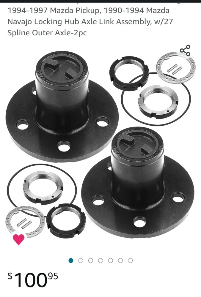

You think I should go to manual hubs now. So this doesn't happen again? I can get a pair on Amazon for $100 new, and that ain't bad. It says it fits my Year. Mine is a 93 Ranger.
Question: Can I use my existing automatic hubs with a Manual conversion kit?
No. They're different. One big difference is the hole for the locking knob.
Do the manual hubs use a keyway also? Hopefully not, I'd rather not deal with the keyway any longer if necessary.

The manual conversion uses the "keyway", but not a key like you are trying to remove.
First, to be clear; a "keyway" is a slot or "way" that a key fits into. The key is a piece that slides into the keyway on a shaft and also the keyway in a hub, gear, sprocket, etc. And links the 2 pieces (shaft and hub) together. The key is the piece you are trying to remove.
The manual hub uses a washer with a tab on it's inside hole. The tab slides in and engages the keyway (slot) on the shaft.
