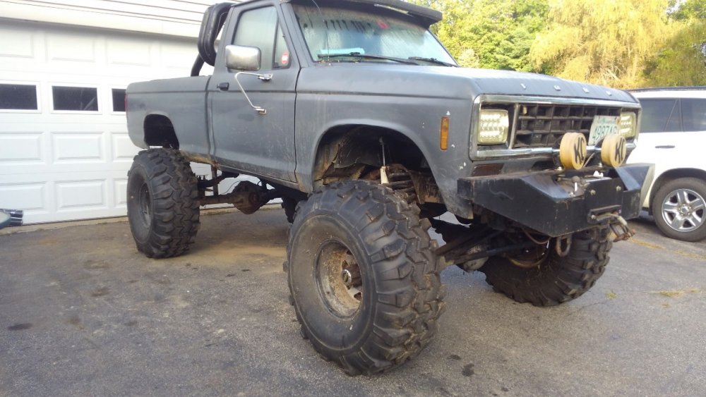

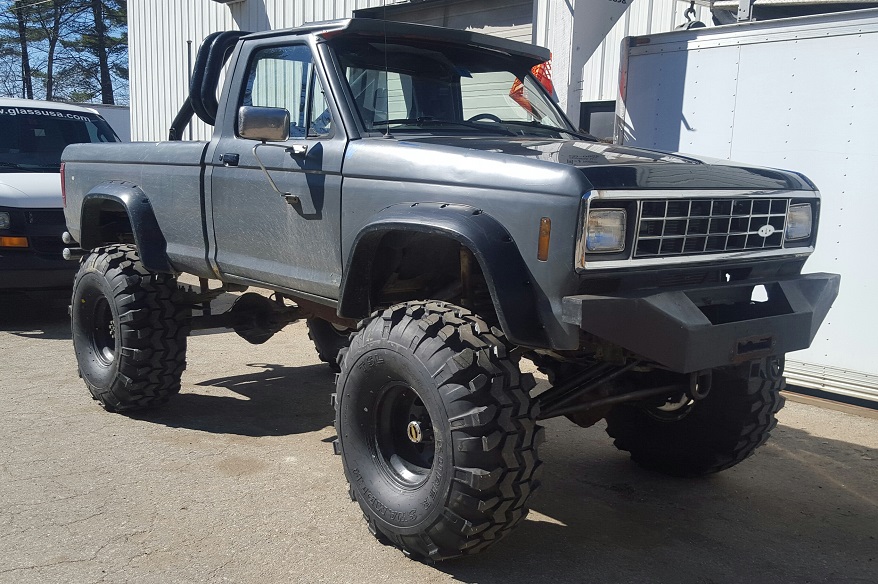

This weekend I mounted brand new 39.5x15x15 Swampers and cut the bumper apart for a new winch after selling the hydraulic winch.

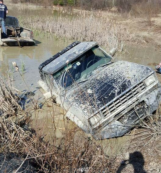

3 weeks after the last time I posted, I buried the truck glovebox deep in a pond. Got it winched out and back home for repair.

Truck had water in the glovebox and tail light was under. I must say, hip waders work awesome for days like this.
Note the Chevy in the back with the PTO winch in the bed, guys got a 496 and 44s, ol posford was walking around him with a 351w and 39.5s until I got a little too cocky.

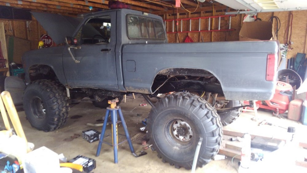

Next pictures are from this spring, the reason why it went under the knife, again.

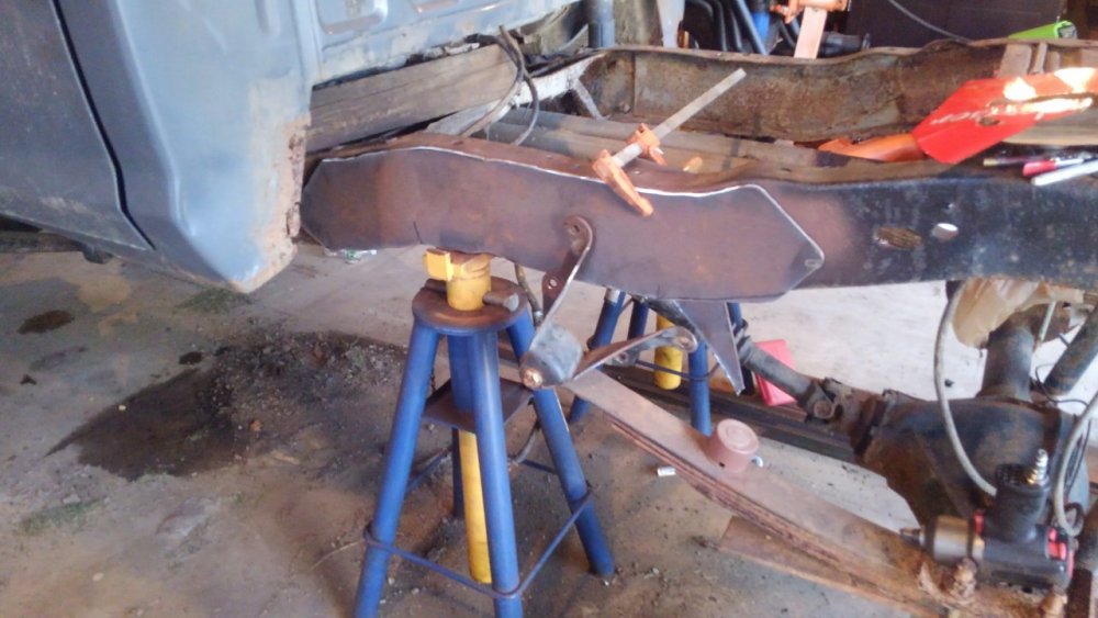

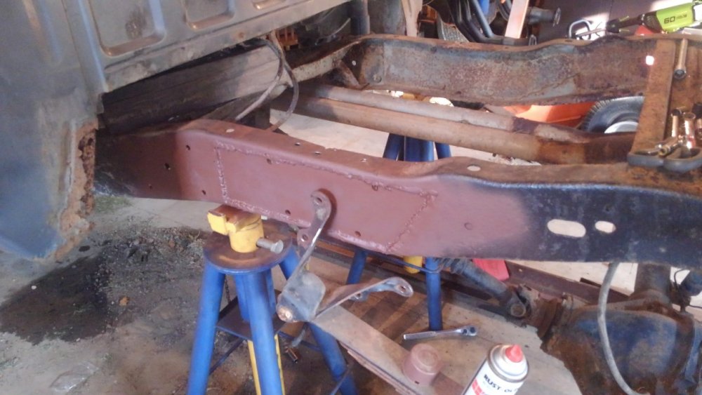

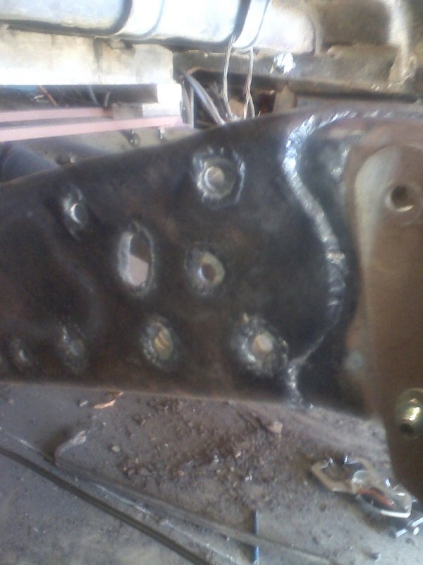

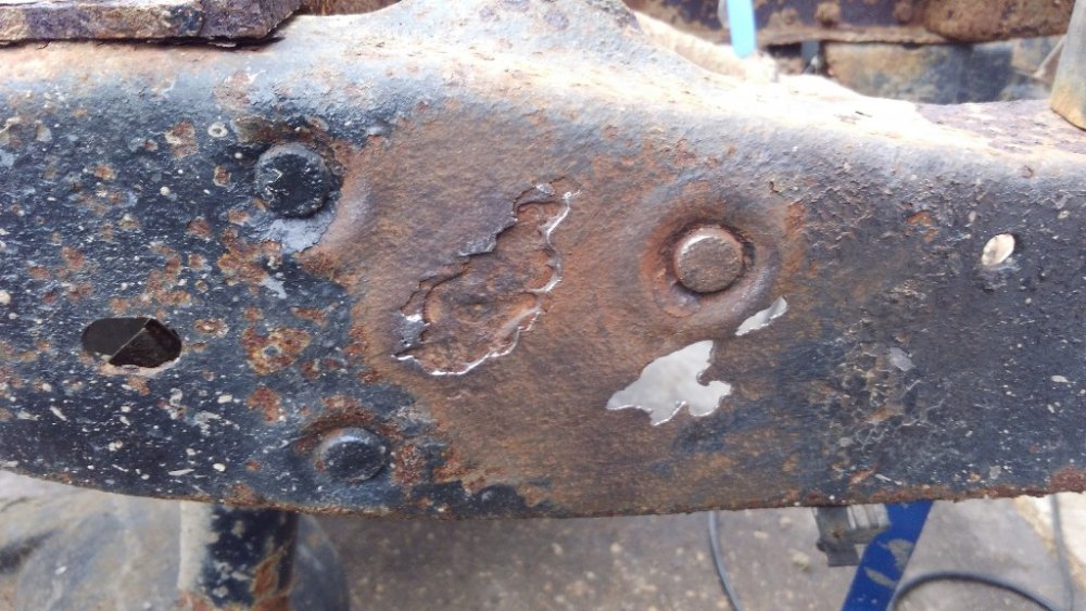

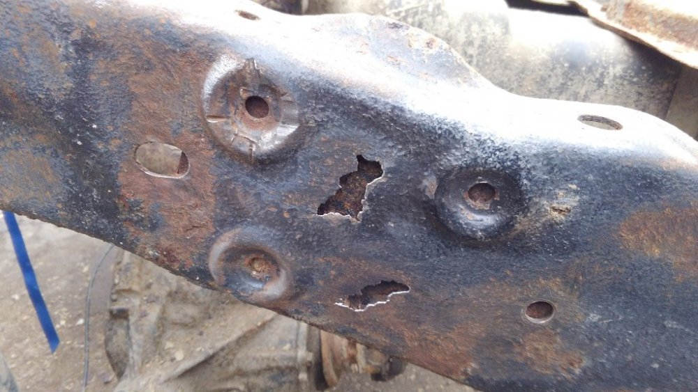

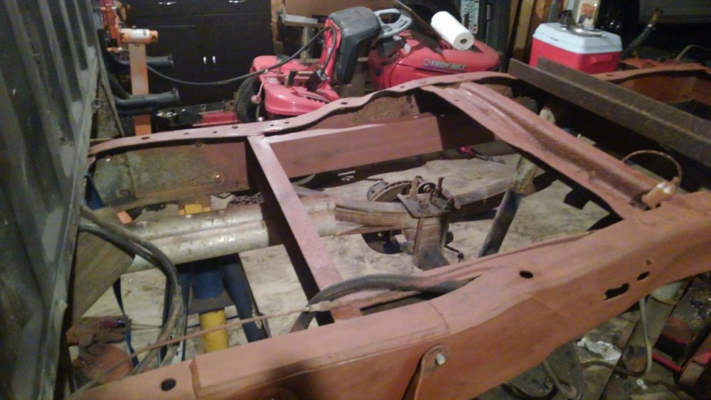

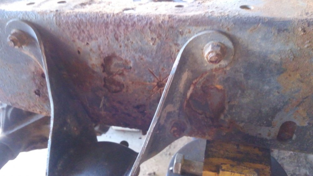

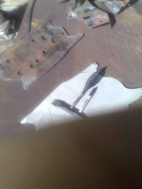

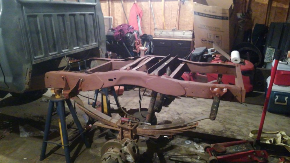

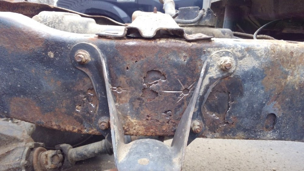

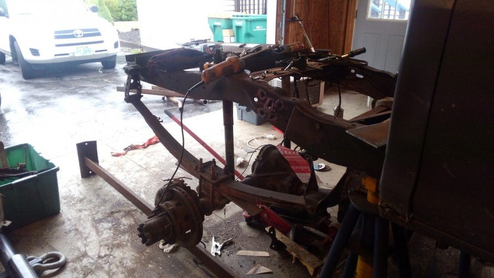

Some pictures of the process of patching the frame up. I had patched it several years ago, so once the hangers were pulled, I cleaned up what was there and hit it with primer. Made a patch template from beer box, little help from a borrowed plasma cutter and sliced the 1/4" plate into a workable patch. Goes up under the cab, under the cab mounts, and past the spring hangers, where it's through bolted in multiple spots for strength.
Then we added some 4" channel crossmembers, and then ran channel lengthwise to tie the crossmembers together. Some inner patches behind the rear axle tie everything together with the rear shackle hangers. Plan is for a receiver hitch, and possibly the Ramsey RE12000 I have sitting under the bench.

Buddy of mine came with his MIG and we spent 4 hours non-stop banging out the welding and final fitment
Rebuilt the 91 again, this time on 40s
End result

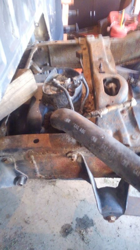

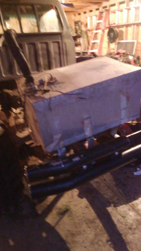

So with how I did the frame reinforcement, I needed to move the gas tank. Spent a lot of time going back and forth with this, found an alum boat tank on FB marketplace for $10, and installed a Carter P4070 fuel pump next to the tank.
What was factory

$10 tank, even has a fuel gauge sender

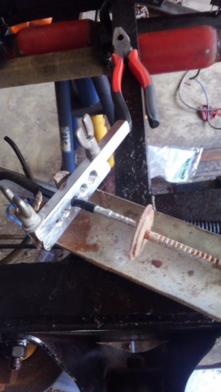

Neat tech tip, need to install fittings on those awful nylon fuel lines? Brake line flare tool, and a caulking gun make quick work of it. Adapted to rubber to go to the tank.

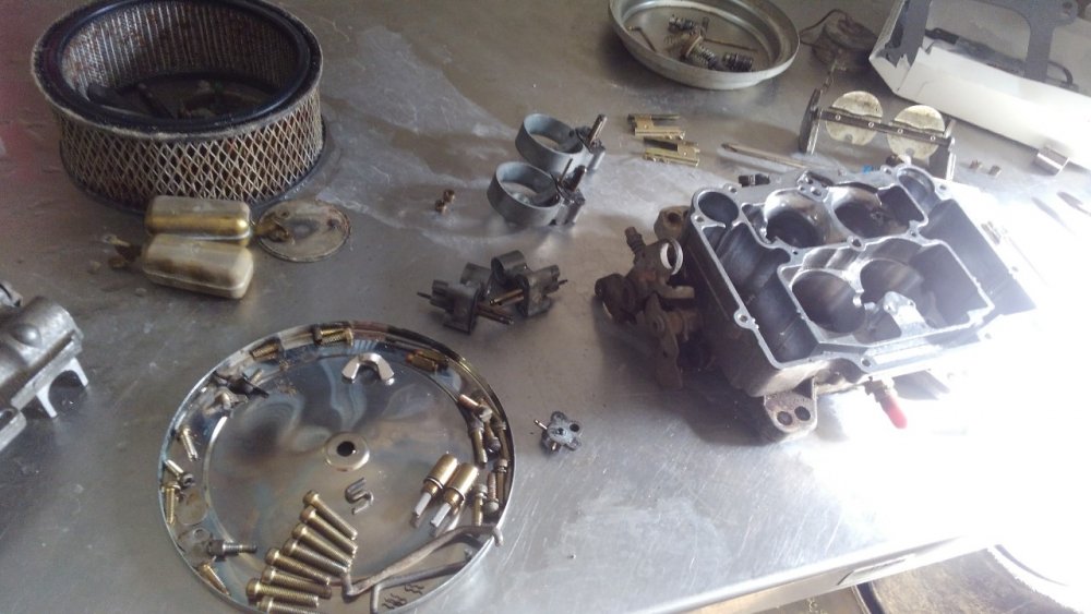

Didn't make it far before the carb idle circuits plugged and it was time for more fun

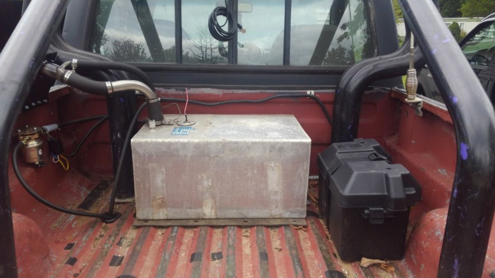

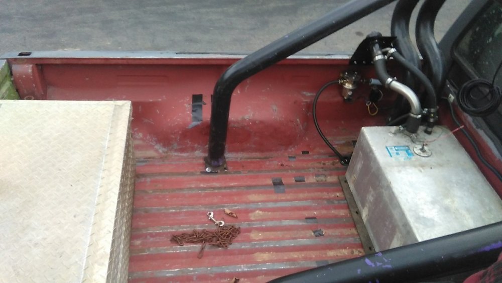

I'll take some pics of the bed when I get home. Fuel tank is up against the cab, fuel pump on one side, and battery relocated to the bed on the other side to gain some room under the hood. Spent a ton of time fixing some rushed wiring that was done years ago, got to clean up the interior some more, swapped out the bench I had stuffed in for the original rally buckets, going to make a center console, and mount the dual band radio I got in it.

Yeah, great fuel line tip. Reminds me that I need to redo mine. FWIW you can buy AN quick connect fittings (for those of us running EFI) and use steel brake line for fuel lines instead of that nylon stuff. We did it on our race truck and it has worked well.

when your hauling heavy, wrapping the frame is something to consider for patching. same or slightly less gauge..
obviously for this application.... anything is better then what ya had. fish plating and reducing right angles is key....
in my experience...ethanol fuel and alum boat tanks is the devil....i was fixing them quite a bit before i moved out of houghton lake....they get a plaque in there that loves to booger everything up.
i fit up a fat bastard tank as well....but a 34 gal plastic unit from a b series van. pretty good range and full use of bed.

Fuel tank, battery box, and fuel pump in one pic. Made a piece of plate to mount the filler neck to.
