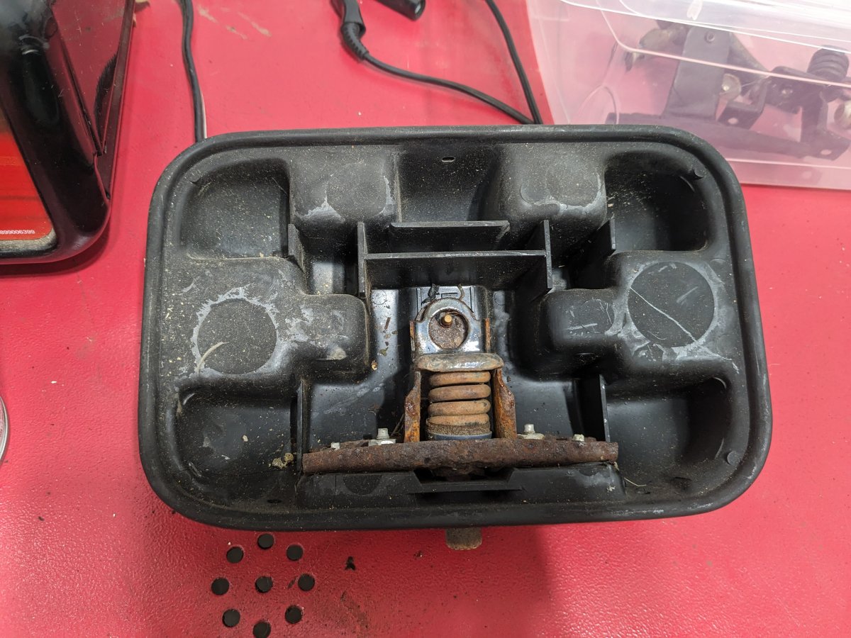

Here's what I started with:
Detail view of the pivot assemblies:

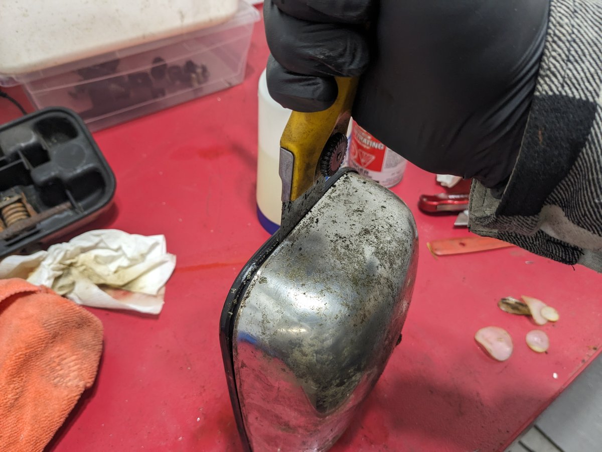

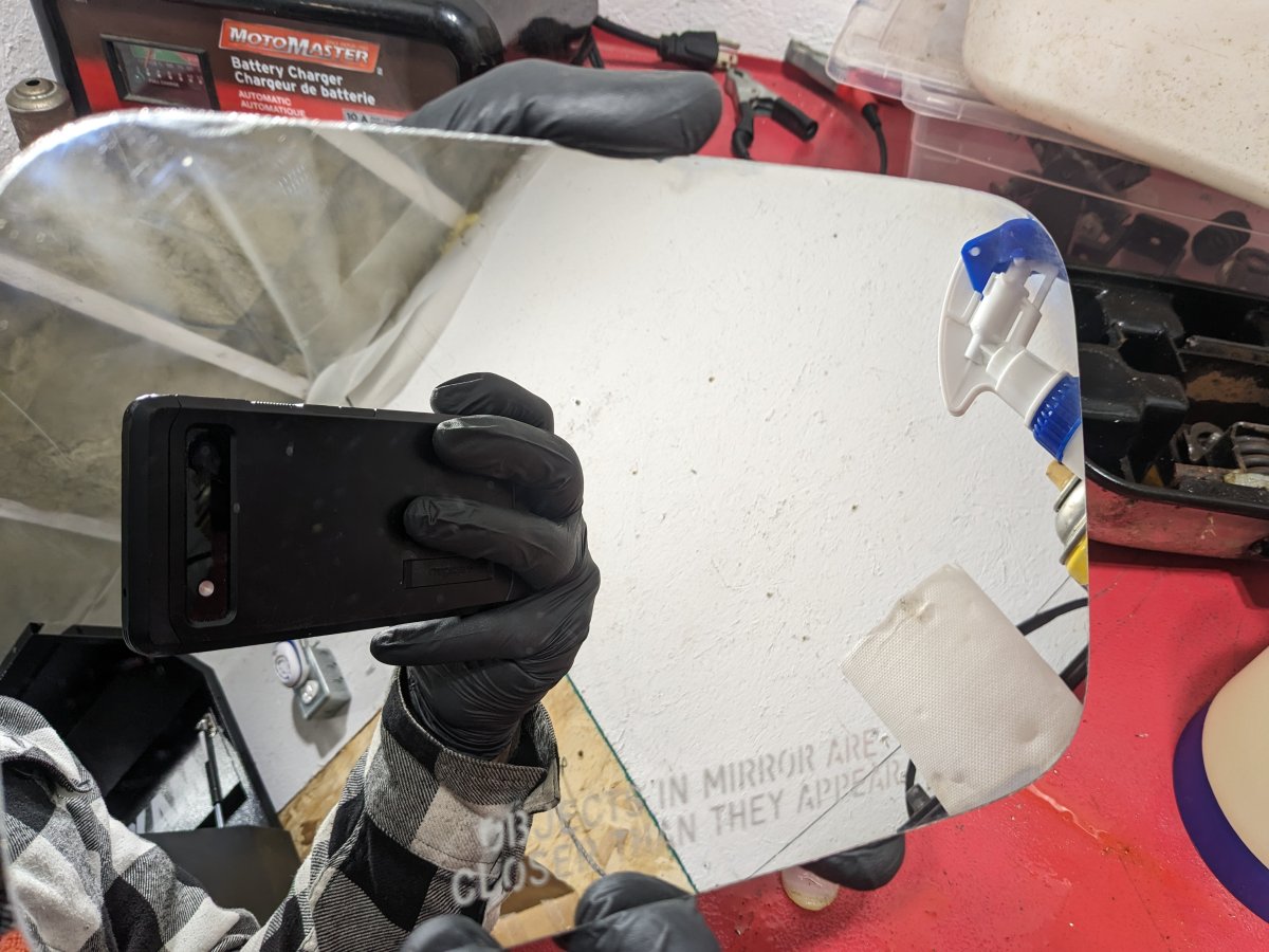

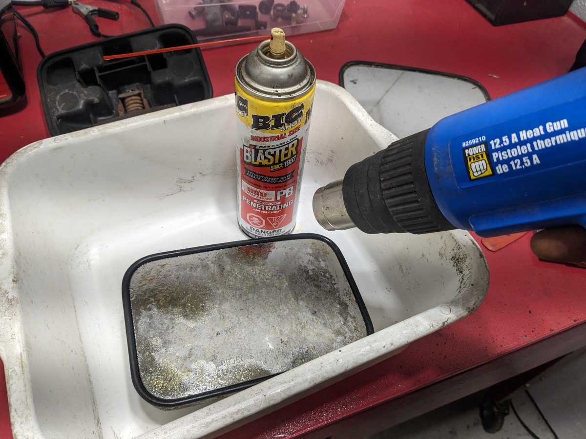

Separating the glass from the mirror body. I evenly applied heat to the glass, then used an assortment of scraping and prying tools to firmly but very gradually lift the glass out of the body.
PXL_20231228_031054212.jpg PXL_20231228_032244278.jpg PXL_20231228_031139201.jpg PXL_20231228_032557945.jpg

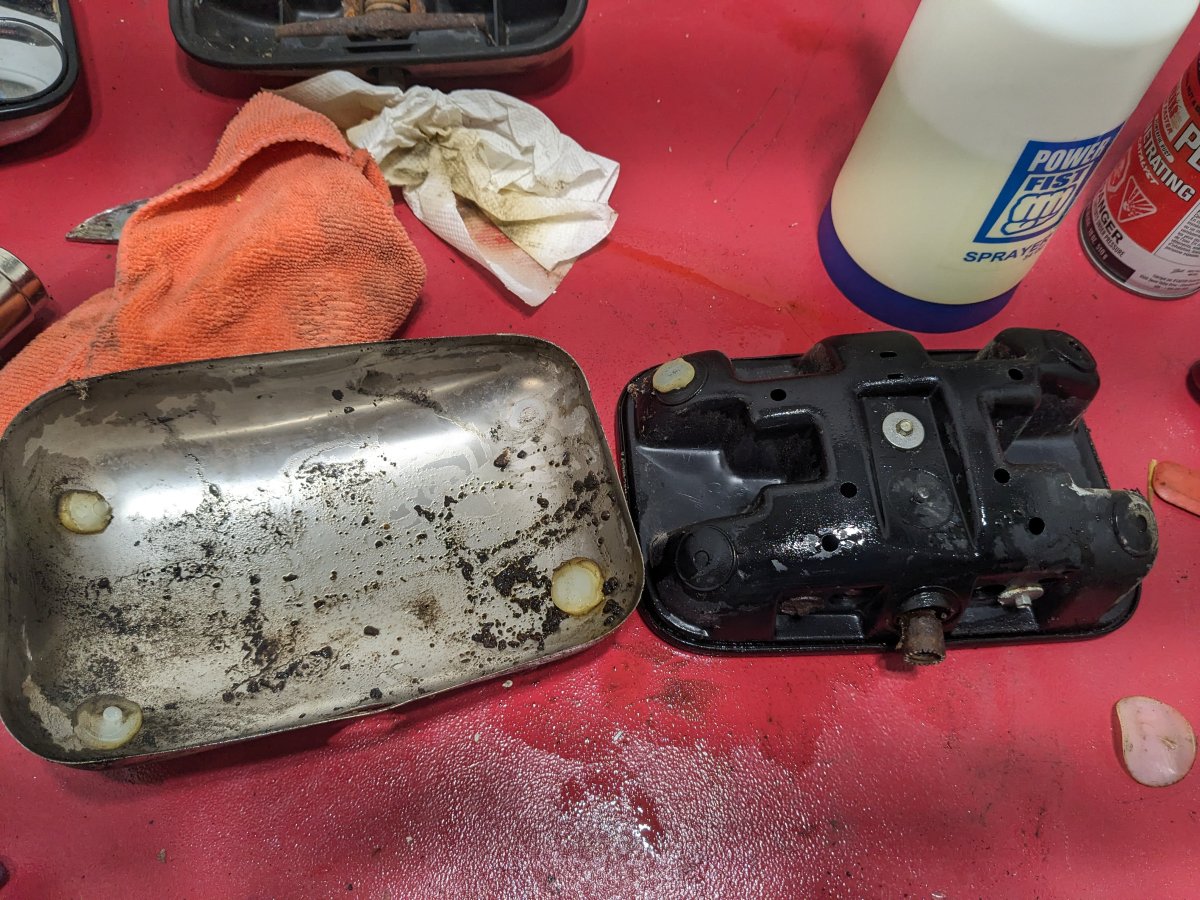

Next, we separate the aluminum back cover from the plastic body. This covers fasteners we need to get access to. It is held on with the same type of adhesive which is a relatively flexible silicone. I found it seemed to work best starting on one of the short sides.

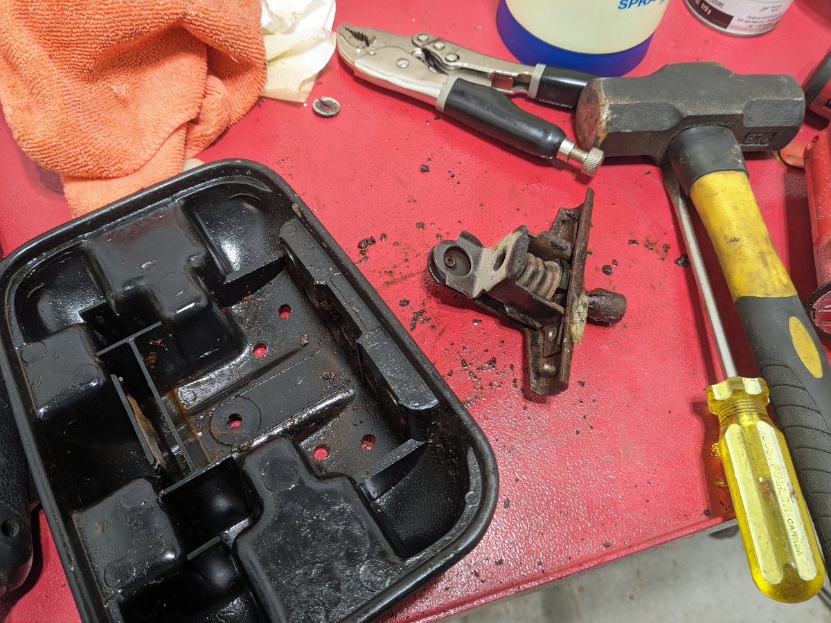

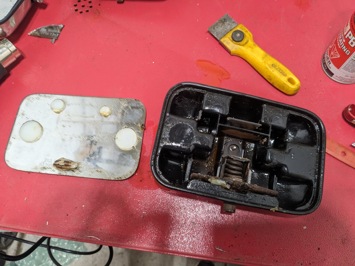

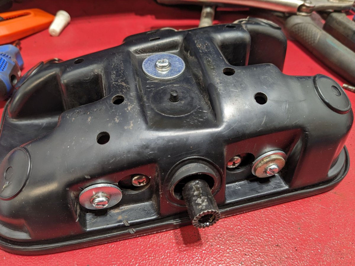

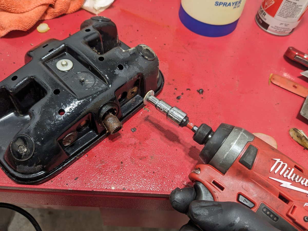

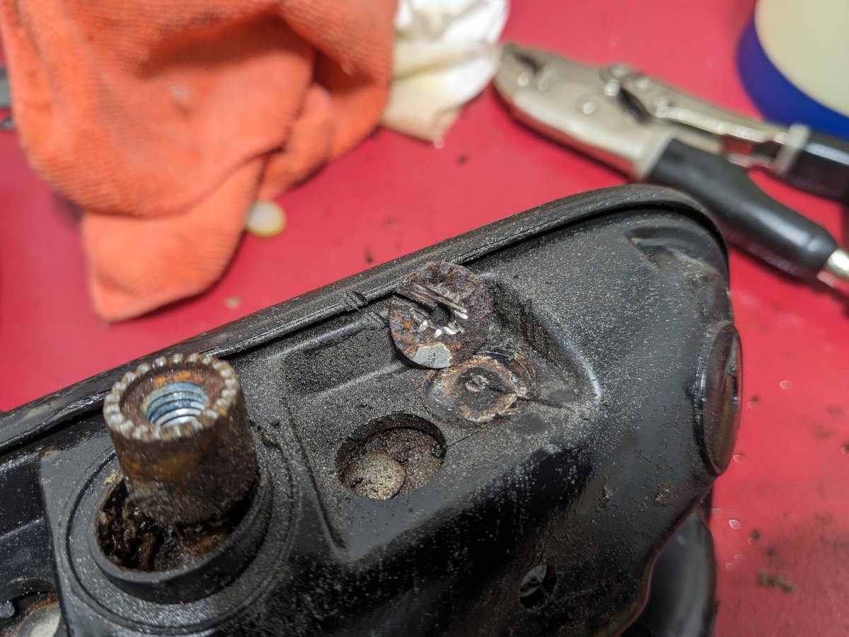

Once the back cover is off, we can see the three small bolts that hold the pivot mechanism inside the housing.
PXL_20231228_033118723.jpg PXL_20231228_033146790.jpg PXL_20231228_034148298.jpg PXL_20231228_034235860.jpg

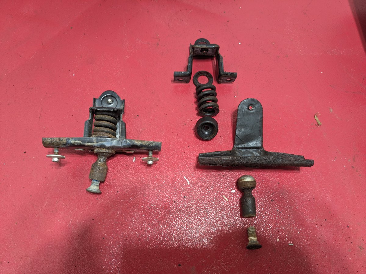

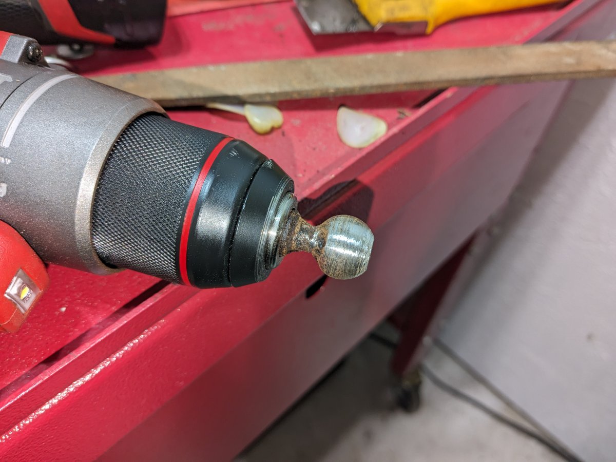

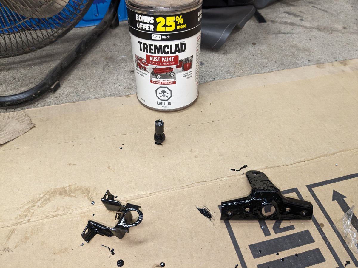

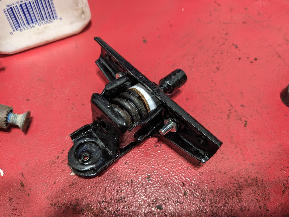

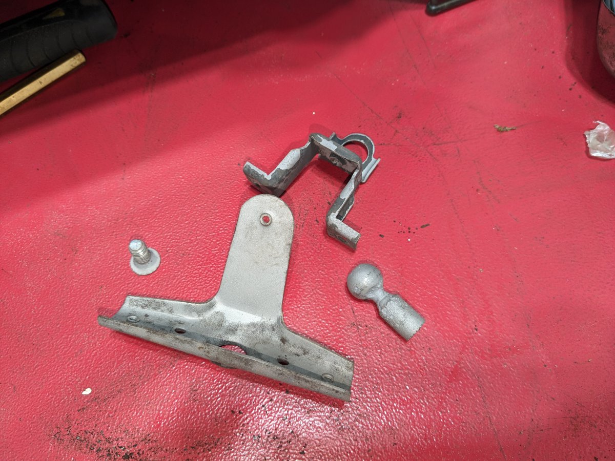

Taking apart and inspecting the pivot mechanism. Compared two of my available pivot balls, selected the one that seemed less rusted to garbage. Sanded it down to clean metal.
PXL_20231228_035503925.jpg PXL_20231228_040346834.jpg PXL_20231228_035748684.jpg
Sandblasted the pieces of the pivot.
Painted with an oil-based rust paint.

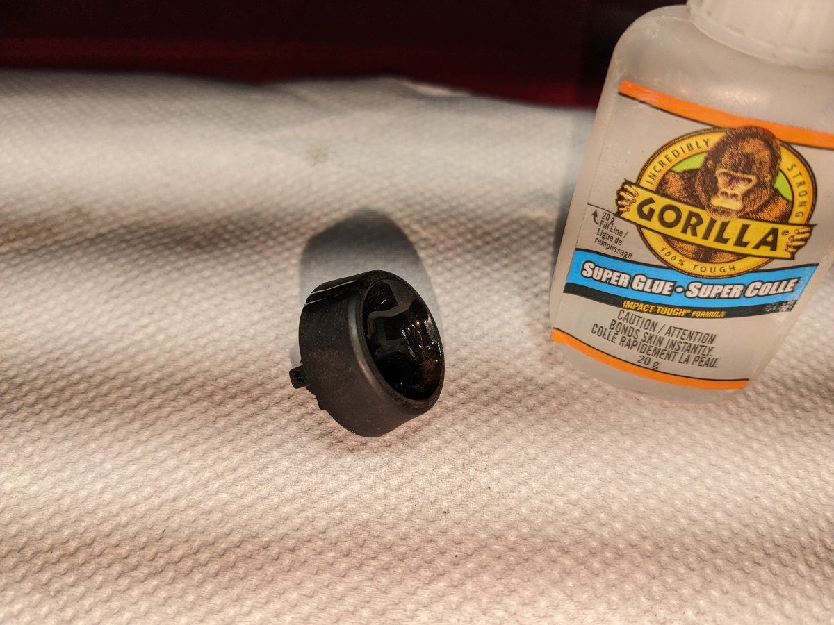

Upon closer inspection, I found that the 'socket' for the pivot ball stud has a crack in it. This is one of the failure points I've seen in the few mirrors I've looked at now, but this one doesn't seem too far gone to be worth trying to save.
I squirted some super glue inside the crack as well as lining the inside of the socket/cup, and will try to smooth it out once I see how it dries.
Status as of tonight: paint and glue are drying. If the glue looks like it'll hold up, I should be able to assemble the mirror when I get a few minutes, maybe this weekend. If the glue doesn't look like it'll work, I'll need to look for some sort of piece that can replace it, which might be tricky. It would be a pretty 3D-printable part for someone with the ability to model the part.

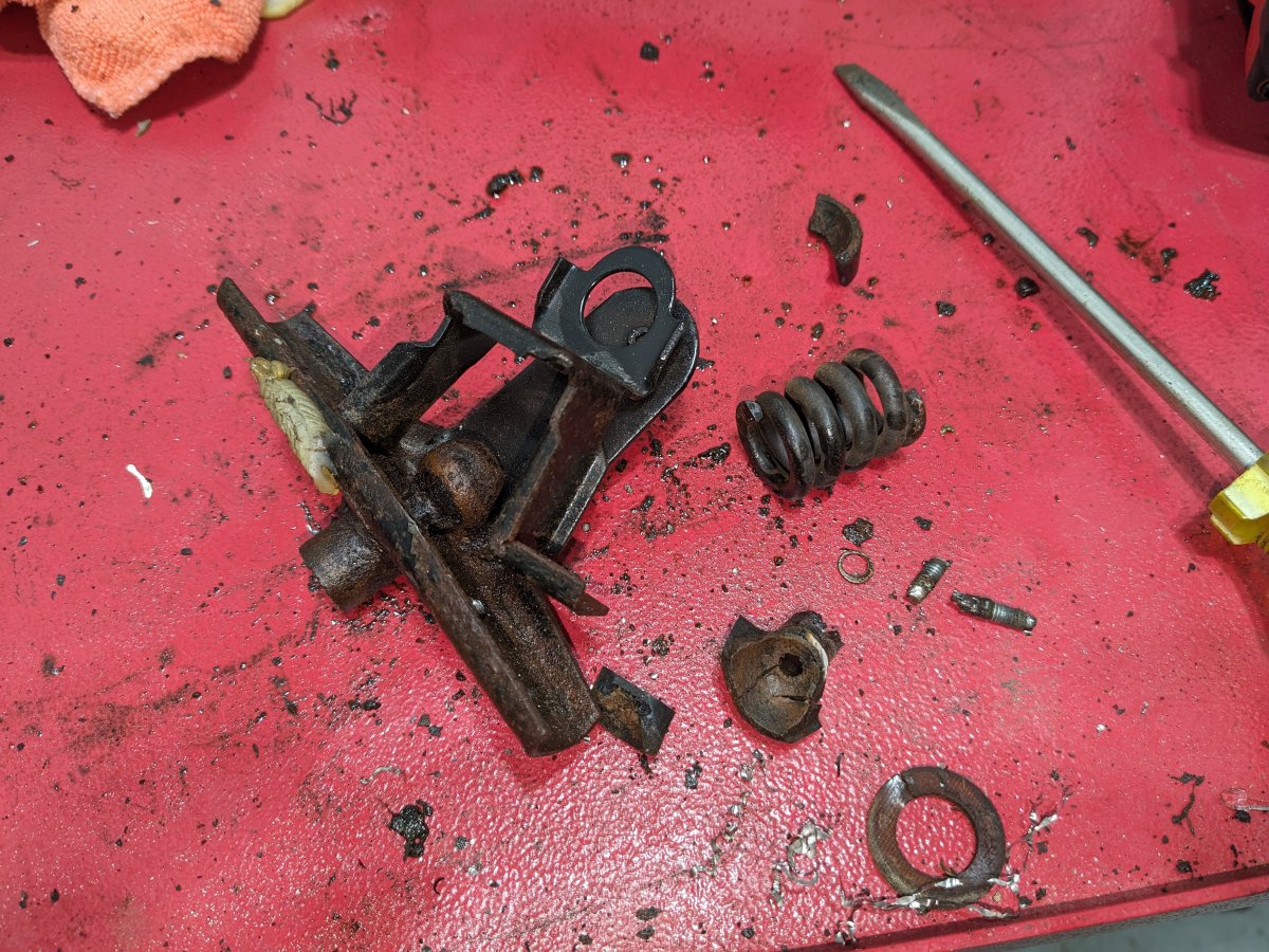

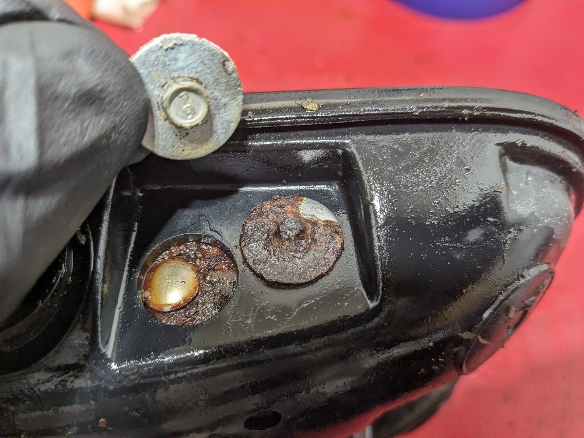

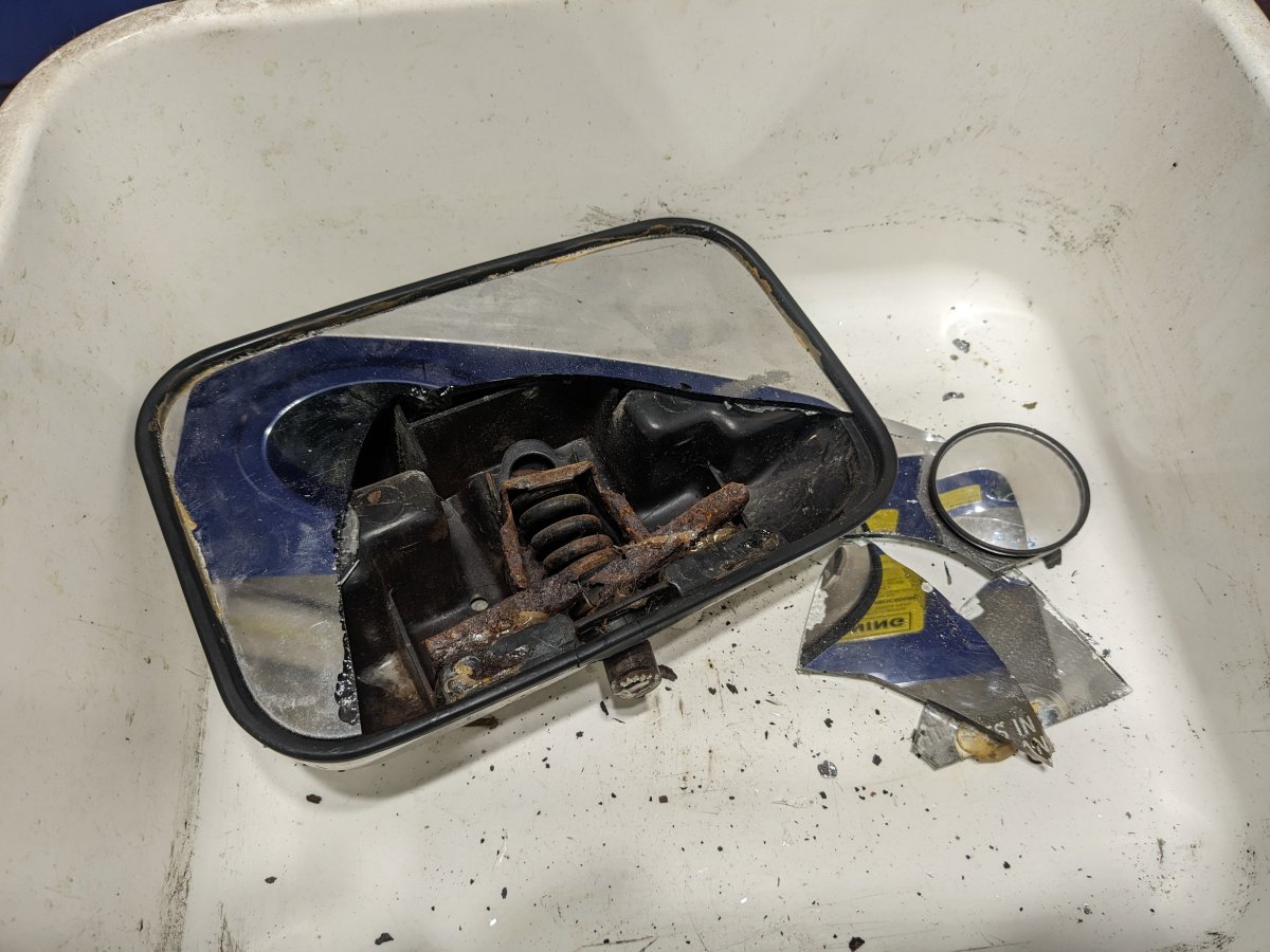

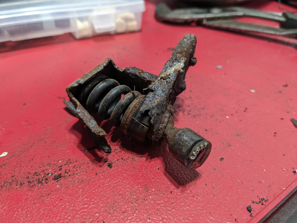

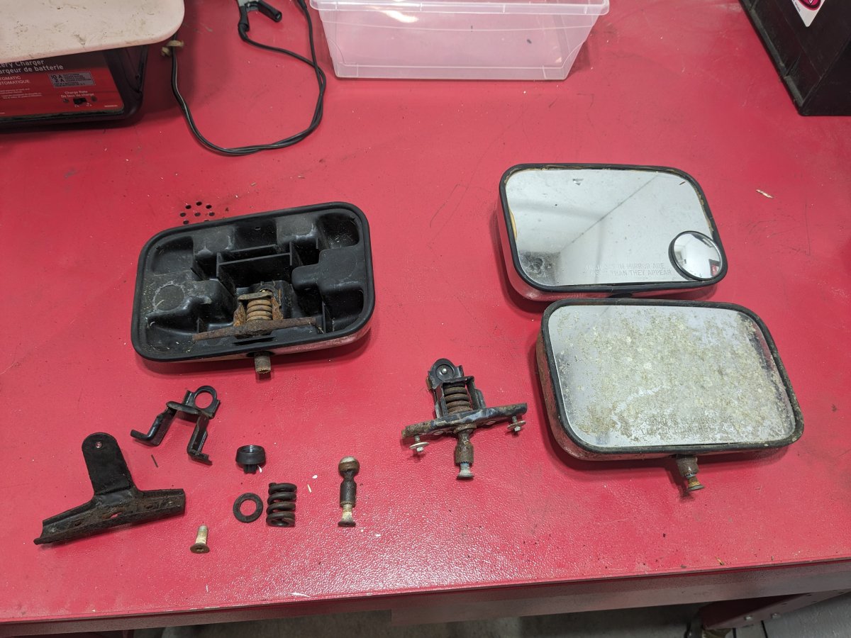

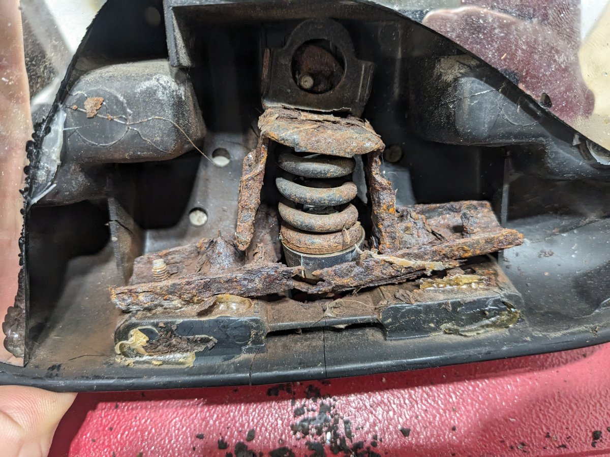

I took the opportunity to study the mirror I took off my truck to identify what exactly failed about it. As I noted further up:
Fixing this, or even identifying what actually broke, was complicated by the fact that I had previously re-glued the glass into the mirror, and there was no way it was coming free without breaking.
Yes, I'd say so.

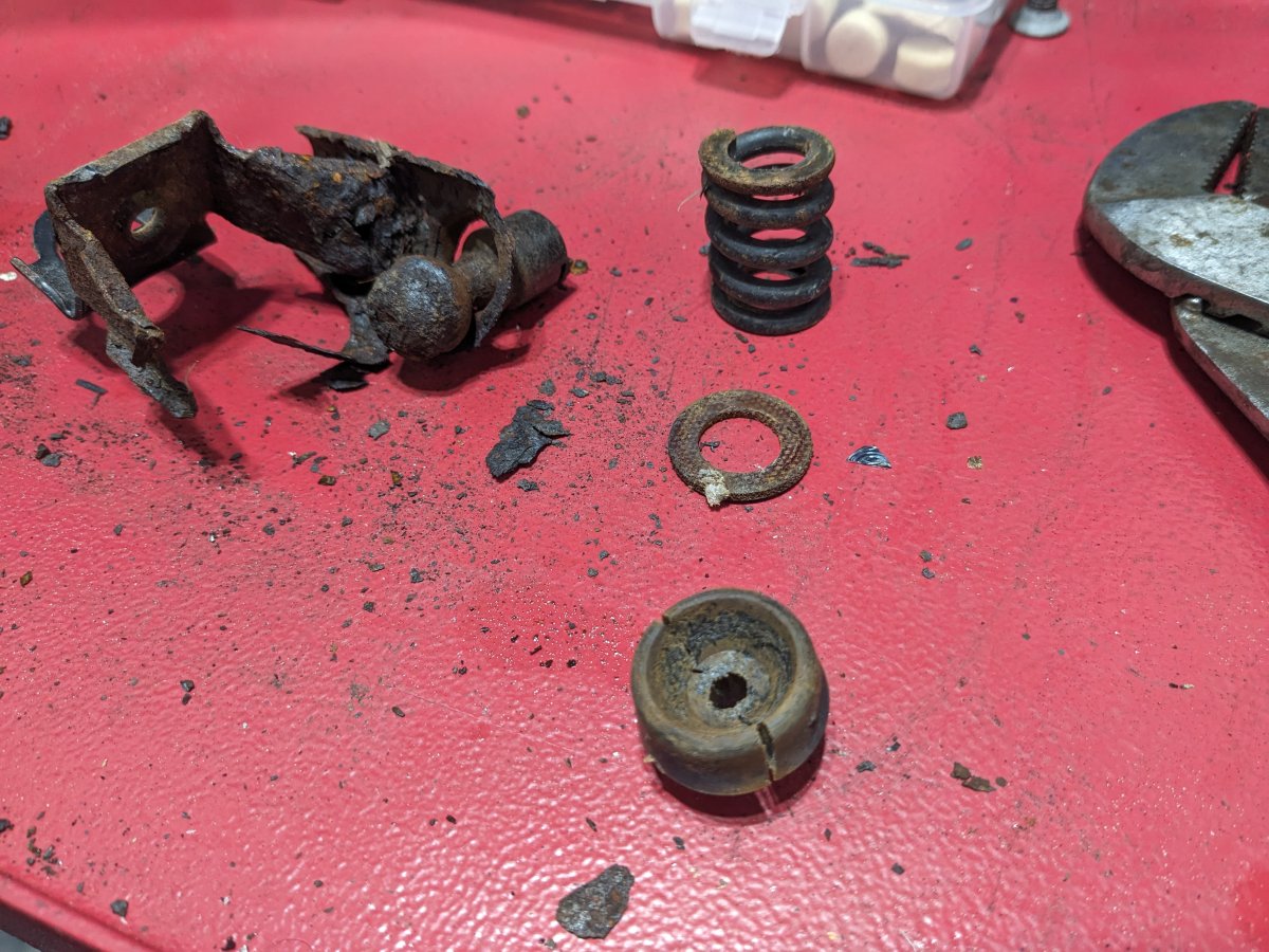

PXL_20231230_054353900.jpg PXL_20231230_054428770.jpg PXL_20231230_054448627.jpg PXL_20231230_054554362.jpg
Impressive. I managed to hit all 3 of the failures I described in the first post. The cage rusted apart, and the pivot rusted off of the mirror body, and the plastic ball socket was getting ready to let go as well.

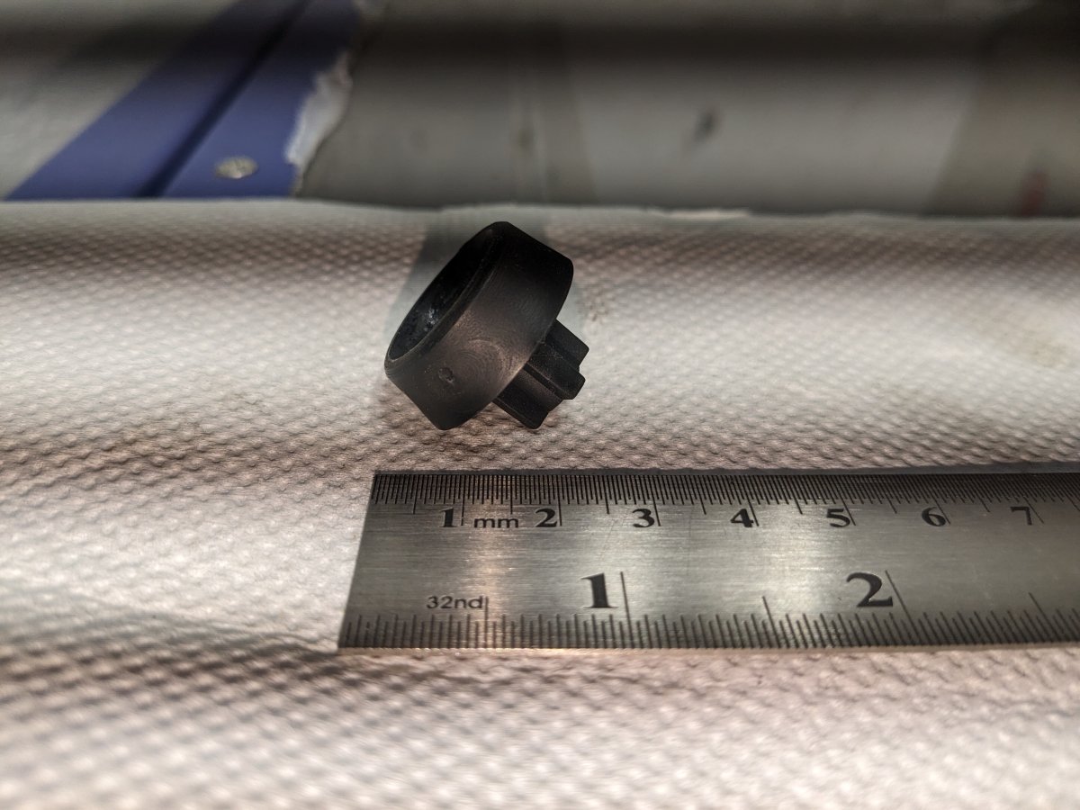

At which point I turned my attention back to the best-condition ball socket, which is the one I patched with superglue.
PXL_20231230_054743891.jpg PXL_20231230_054804824.jpg PXL_20231230_054818352.jpg
Forgive the lighting weirdness, my phone is upset about using the flash in my garage lighting.

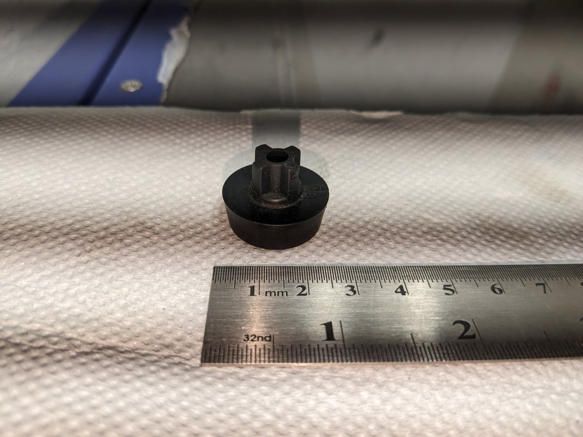

This piece will likely break apart if I return it to service. Not immediately, but maybe not too far down the road. It would be wise to figure out a possible replacement for it.
Since the piece has details which are not really used in this design, I suspect it is a piece of something else that was repurposed for use inside the mirror. Specifically, the detail on the bottom side with the cross shape which pokes into the centre of the spring seems to have molded detail that is unnecessary. If by chance you recognize this piece from some other thing that you've taken apart in your life, I'd appreciate any suggestions as to what other applications it may have.
Probably putting the brakes on mirror assembly until after I explore this piece a little more. I'll ask around in my friend circle about 3D modelling and printing a replacement, as well.

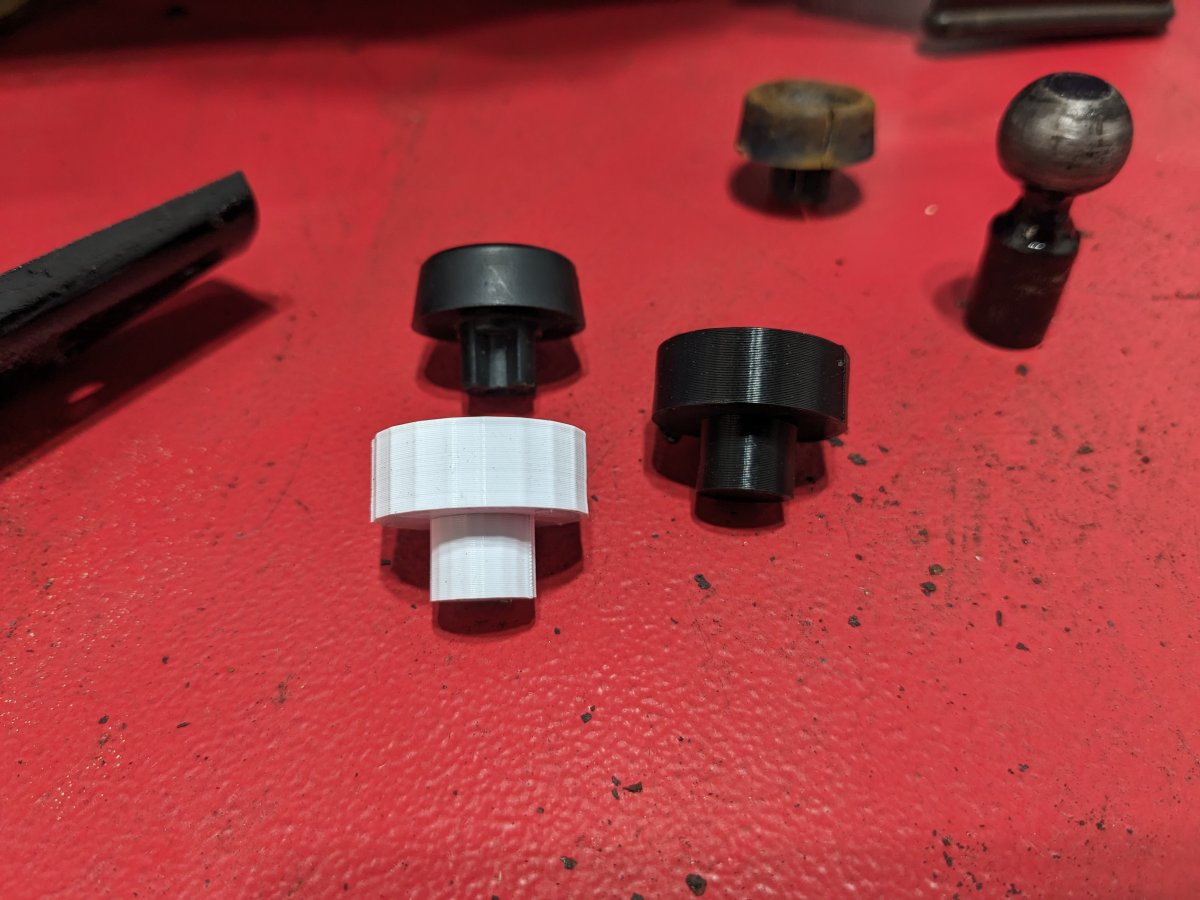

I talked to a couple friends knowledgeable with 3D printing who said it would be a really easy model and a really quick print. Cool.
Briefly taught myself Tinkercad and came up with a model that seemed like it might work.
Sent that, along with the actual piece to my friend with a decent printer. He then made his own model which has some differences, printed both mine and his, and handed them back to me.
Results are looking positive.
Version A - the one I made. It almost works too well and locks the pivot pretty firmly in place.
Version B - the one my friend made. It seems to work very well and is the one I'm going to use when I reassemble the mirror.
Bear in mind that the mirror frame/body is plastic, so if this is too stiff, you could crack the mirror trying to adjust it.
You can download either one, or both, from In the photos below, version A has been printed in white and version B has been printed in black.
PXL_20240102_023651184.jpg PXL_20240102_023703480.MP.jpg PXL_20240102_031616424.jpg PXL_20240102_031626439.jpg

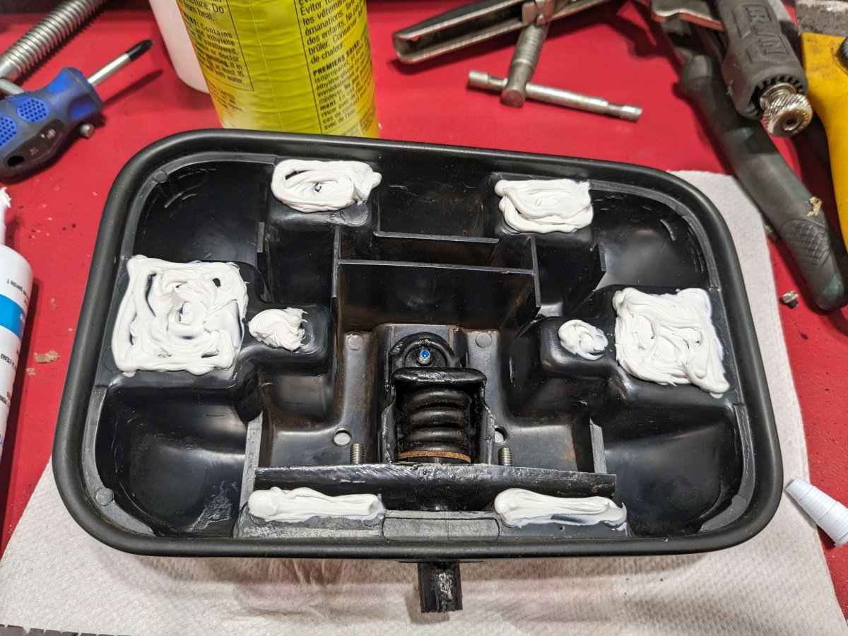

I applied sil-glyde caliper slide grease to the 3D-printed ball socket, assembled it with the thinnest of the washers I had from the various disassembled mirrors (for lowest spring tension), and I used stainless 10-32 machine screws, double-nutted, to hold the spring cage to the bottom part of the pivot assembly. I used the only M3 screws I could get at Home Depot (mystery grade plated steel) to attach the pivot assembly to the plastic body. Fasteners inside the mirror all received medium-strength threadlocker. I then mounted it on the truck and tested how firmly it holds its position while remaining adjustable, and found it's about perfect. Took it back off to continue reassembly.
PXL_20240204_021551680.jpg PXL_20240204_021600597.jpg PXL_20240204_023023224.jpg
I used the cheapest general purpose silicone-containing caulk I could find, again at Home Depot, to glue the stainless cap back onto the body. This is the same method the factory used originally, but they used some sort of clear silicone. I'm hoping what I picked is close enough.
PXL_20240204_025005850.jpg PXL_20240204_025835295.jpg PXL_20240204_030024796.jpg
Anyway, got that glued on, then did the same with the mirror glass. I let it cure overnight, then when I revisited it, I gently pried at the glass and verified it seems stuck in place pretty well. I then ran a very small bead around the top and sides (for more adhesion and also to reduce moisture entry), leaving the bottom open for moisture drainage. Mounted it on the truck and went for a drive. Seems promising. And I can't tell you how great it is to have 3 stable, non-vibrating lanes in my passenger side mirror again vs the Dorman mirror that gives less than one jittering so much you can't even see it.
