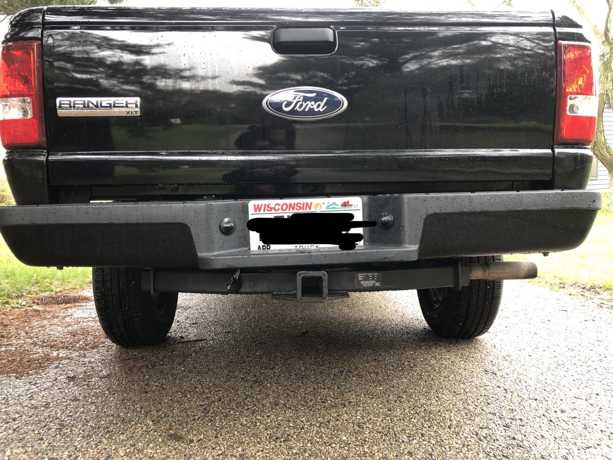

I was surprised to see minimal damage on either car, other than my bumper no longer being straight and an indentation in the other driver’s front fascia the shape of my tow hitch.
I'd have it looked at by a good body shop. The bumper, and the hitch, for that matter, don't appear to have surface damage (paint scratches, torn plastic trim). If the force was from the other car's fascia and just on the tow hitch, then something had to bend (frame or brackets), or fasteners had to slip to make the bumper that crooked.
Hard to tell in the pics, but the bumper itself may have a slight twist, that would be better seen from the side.

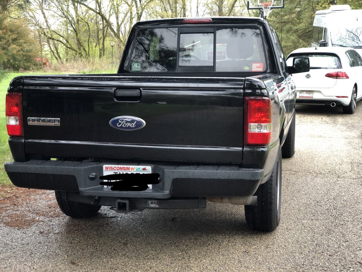

The picture below is a pretty good view of the side. I am assuming it got hit on the pass side rear more than the driver's? Mine I guess got hit harder, since it broke the taillight. But just to be sure, run your hand down the bedside, the weak point is right over the wheel well. Make sure there is not a wrinkle there on the bedside.
index.php
The bedsides look straight to me. I wasn’t able to capture it in a photo, but I also feel like the top of the tailgate and the front bulwark of the bed aren’t parallel either. I don’t know, it’s tough to tell since the panel alignment on these was never that great from the factory. The gap between the bed and the cab looks fine. When my Tacoma was rear-ended, I knew it was a total loss when I noticed small dents in the cab where the bed had smacked into it. Keeping my fingers crossed it’s just the bumper.
