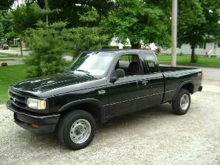

This is my 1994 B3000. Has a few miles on it, but runs good regardless.
Specs: 3L, 5spd, 13-54M, D35/7.5 open w/ 3.73's. Puny 215 70R 15's.
Picture when I first bought it:

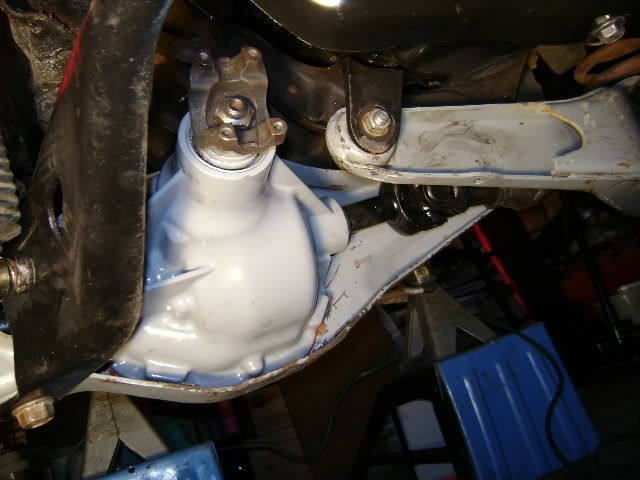

It's not as patriotic anymore. The RA's are black.....
I had to repaint them with what I had. The lower shock mounts kept coming loose. I tried all combinations of lock washers, lock nuts, and lock-tite. So I decided to just weld the @#$%ers. Sloppy farmer welds.....I even welded it on a farm next to a tractor......:icon_welder:

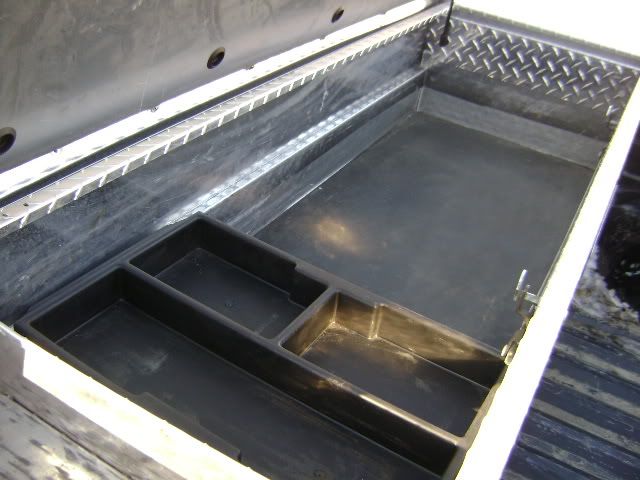

Tool BOX!
Me living in APT (lack of room) and having to go back and forth to school ( going for associates in Auto tech) with most of my tools, left me with a need for either a tool box or topper. Not really wanting a topper, I picked up on this box for a $100. It was less then 6mo. old. Works nicely.

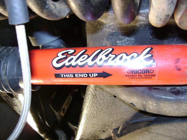

Edelbrock IAS shocks? Oh yeah!
I think they may have discontinued these, but they are worth running. I love em. Great ride and look well built. :icon_thumby:

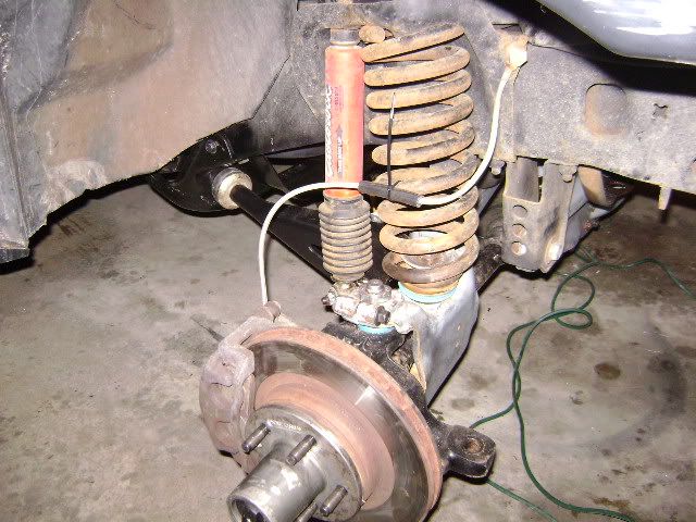

Ran into problems today. Realized both the outer TRE's are shot.
When I pealed back the boots both were packed with rust. Ouch. :icon_surprised: One wiggled and flopped around. The other was froze.
I just installed these this summer and HAVE kept them grease except for recently when the weather has been crap. Anyway, I went ahead and ordered a set of MooG TRE's and will hopefully have time to install them this weekend after I help my dad move a guy from Decatur to St. Louis. Seeing as I have an alignment appointment Monday!
