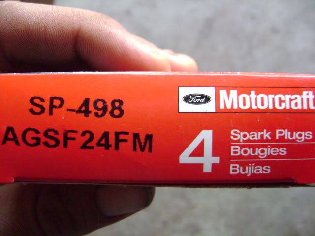

Spark plugs used and recommended by FORD:

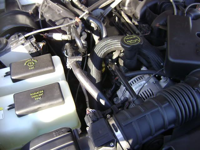

The driver's side is pretty much straight forward, you can get at it through the top.
Use a pair of pliers or spark plug pliers to remove the plug wires from the 1st spark plug. It's best to remove one plug and wire at a time. That way nothing gets mixed up and you can ensure everything is routed the same way it was removed.

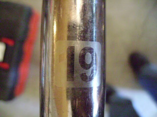

Use a 5/8 spark plug socket to remove the first plug (cylinder #4).

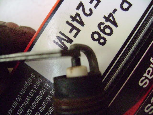

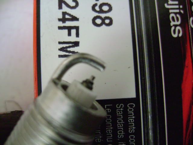

Be sure to check and see that the spark plug gap is correct on your plugs. The gap spec given on the radiator support said .062-.068. With these fine wire platinums it's not a good idea to jam feeler gauges in there. So do your best to get it close, most of the time with the Motorcraft stuff it's dead on. All mine where surprisingly. I used an old autolite to give an example.
Install the new plug. Try not to bang the tip on anything while putting it in the socket, this CAN throw the gap off. When tightening the plug, don't crank on it. It only needs to be tightened to 13 ft/lbs, in other words..... snug with a socket and 3/8 ratchet.

Install the NEW wire, following the route the old one used, and laying it into the plastic guides/retainers........
Repeat with cylinders #5 and #6. Then move to the passenger side for cylinders #1-#3.

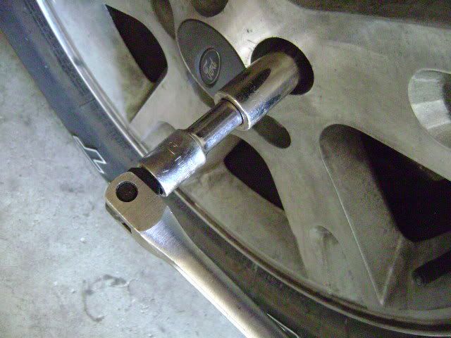

Break your front passenger wheel loose.

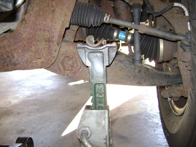

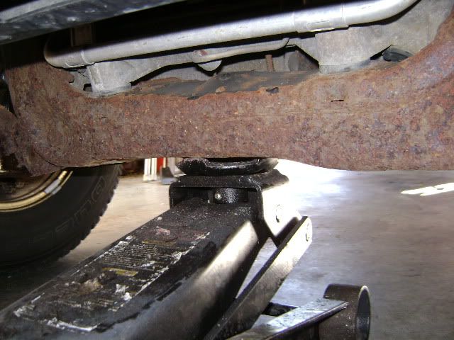

Jack up the front of the truck.
Add jackstands to the nifty little hooks on the front of the lower control arms, and let the truck rest on the stands.

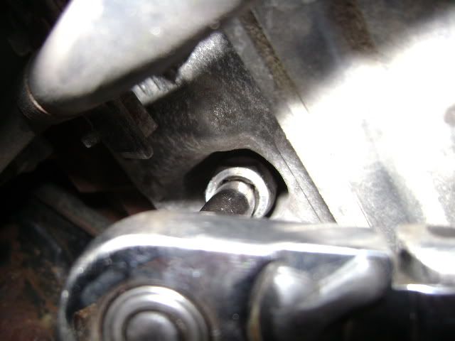

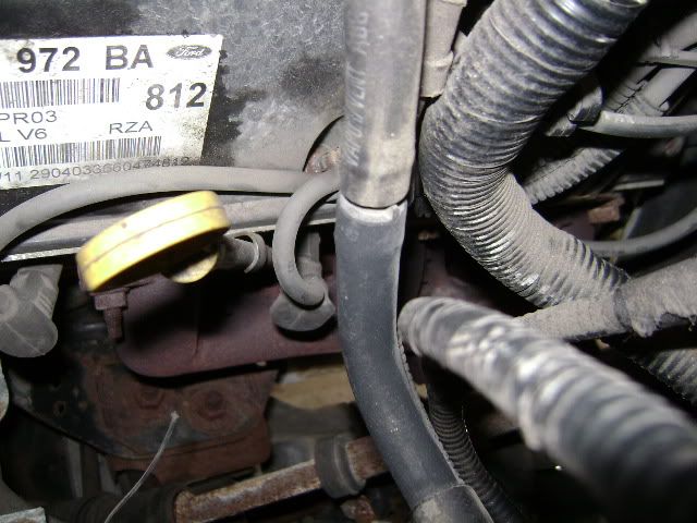

Repeat what happened on the other side, but try and keep your sanity. It took me a little while longer on this side. It's a constant battle of using different combinations of 3/8 ratchet (standard and flex head), extentions and swivels. AND going from top, to fenderwell and back in order to complete the job. You'll get it, but it'll just try your patients.
Make sure all your wires are ran:

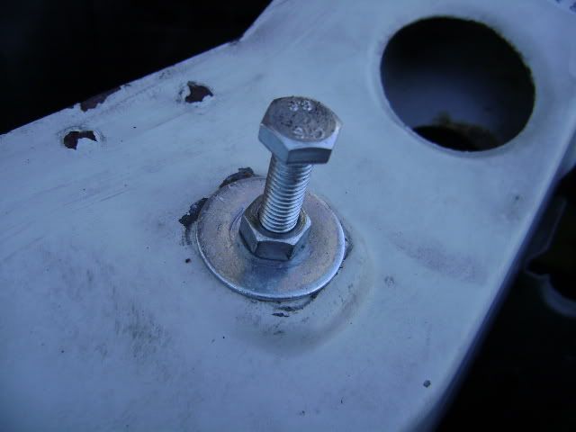

Then noticed how my hood stoppers weren't stopping anything anymore. They had rusted and deteriorated to the point of pushing through the holes and bottomed out. This was my fix. 2 bolts, 4 nuts, 4 fender washers and voila!
The rubber even comes off the old, and with the help of adhesive, stays on the tops of the bolt heads.

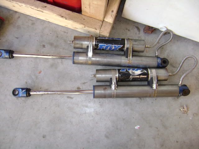

Fox shocks for the rear. 2.0 emulsions. They one needs a new shaft, but I'll probably just use them till they blow.

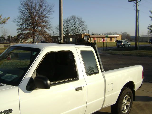

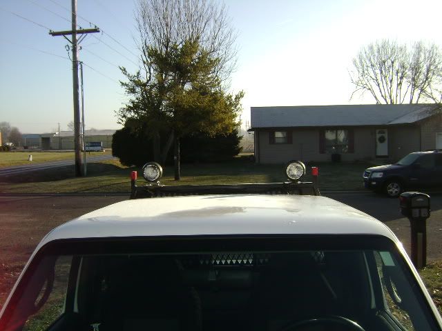

Headache Rack!
Need to make a spacer for the bottom, because it needs to raised 2.5". I mocked it up with wood, and held it in place with my spare.
Need to figure out what I want to do for lights. Those aren't my first choice. Thinking of at least 3, if not 4.

I went out and bought me some regular Hella 500's. 4 of them to be exact......:icon_twisted: On top of that fog lights for the valance. Geese.....this truck is going to be lit up like a christmas tree!
Mounting it all tomorrow. Pictures are a sure thing. Just stay tuned:icon_thumby:
I'd do something about all that rust on the frame and front cross member before it get worst and starts weakling the frame..
