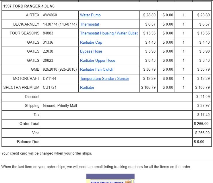

Yep on the 40 mm housing. Found that out the hard way, got the 35mm one and that didnt quite cut it. I got the GMB 9252010 fan clutch and an Airtex water pump. see below for my parts list from Rock Auto.. I am curious what your totals will be here in 2022...
Do note that the water outlet is the wrong one... had to order the right one 4 Seasons 85668 part number...

This was October 4th of 2018. Rock Auto doesn't even carry the Spectra Premium radiator anymore, and they are all now consistently in the 170 dollar range... I also don;t see the lower hose on this bill... must have ordered that later or got it at Autozone.

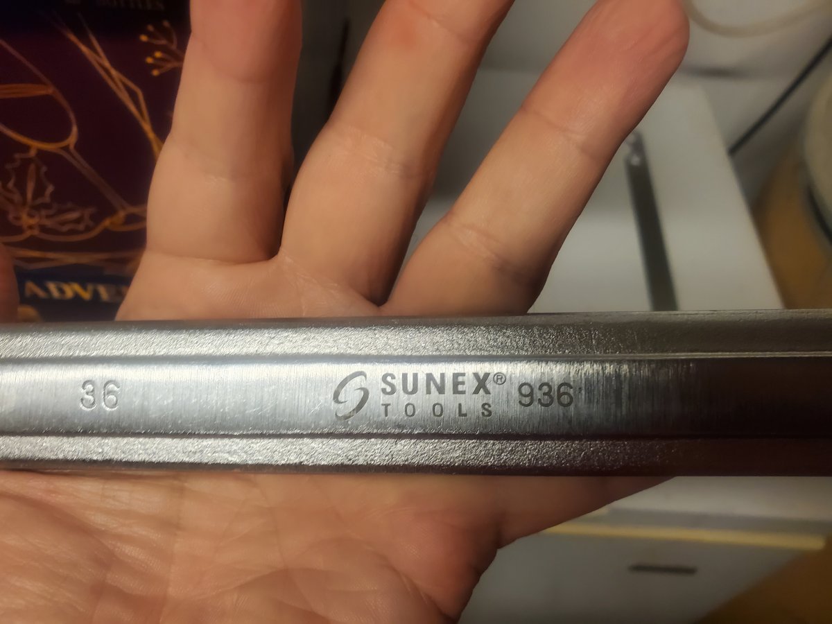

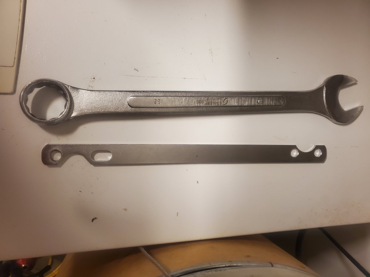

Note, you will need the fanclutch tool (can rent at autozone, but i found that the rental was bent and didn't work for crap) I went ahead and ordered a Sunex 36mm combination wrench from Amazon along with the waterpump holding tool to keep the pulley from spinning. This was actually cheaper than buying the fan clutch tool kit which was very poorly made. they both cost under 20 bucks, the water pump pulley bar was under 2 bucks.

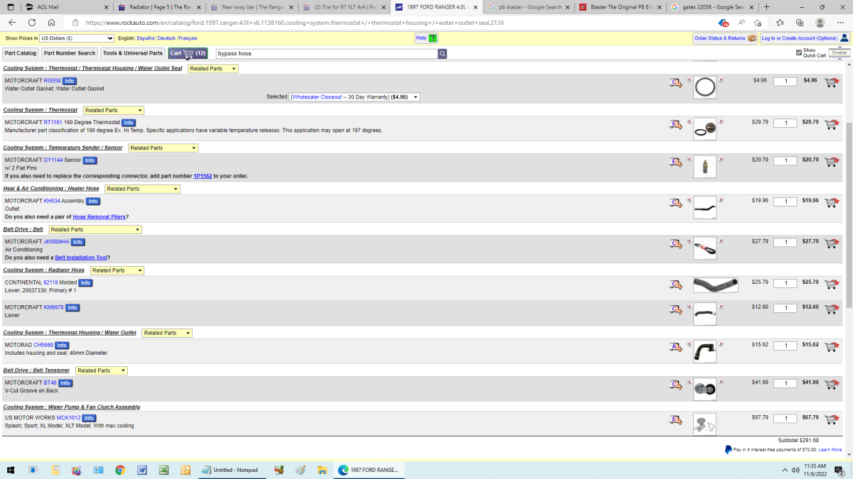

This is what I have in cart right now.
Note there are 2 lower hoses (I think). Continental one is way more expensive than Motorcraft, so I think I can delete the Continental?
Tensioner is in there, no reason to think I need it but wondering if good idea to do at same time?
Replacing serpentine belt also reasonable to do at same time even though other half says "it looks new". If you break a belt you are s.o.l. absent spare and tools.
Would it be smart to do heater hoses at the same time? Or is that just standard off the shelf stuff?
Rubber tends to get crudded up after a while I am just thinking in terms of keeping heater core clean etc. Heat is real good now so core is fine.
Let me know what you think and if I'm missing anything I'd want to do as part of this. Thanks. Will know total once cart is ready but it's going to be more than yours I would bet on that.
Trunk latch not shown so total won't equal parts shown just fyi.
