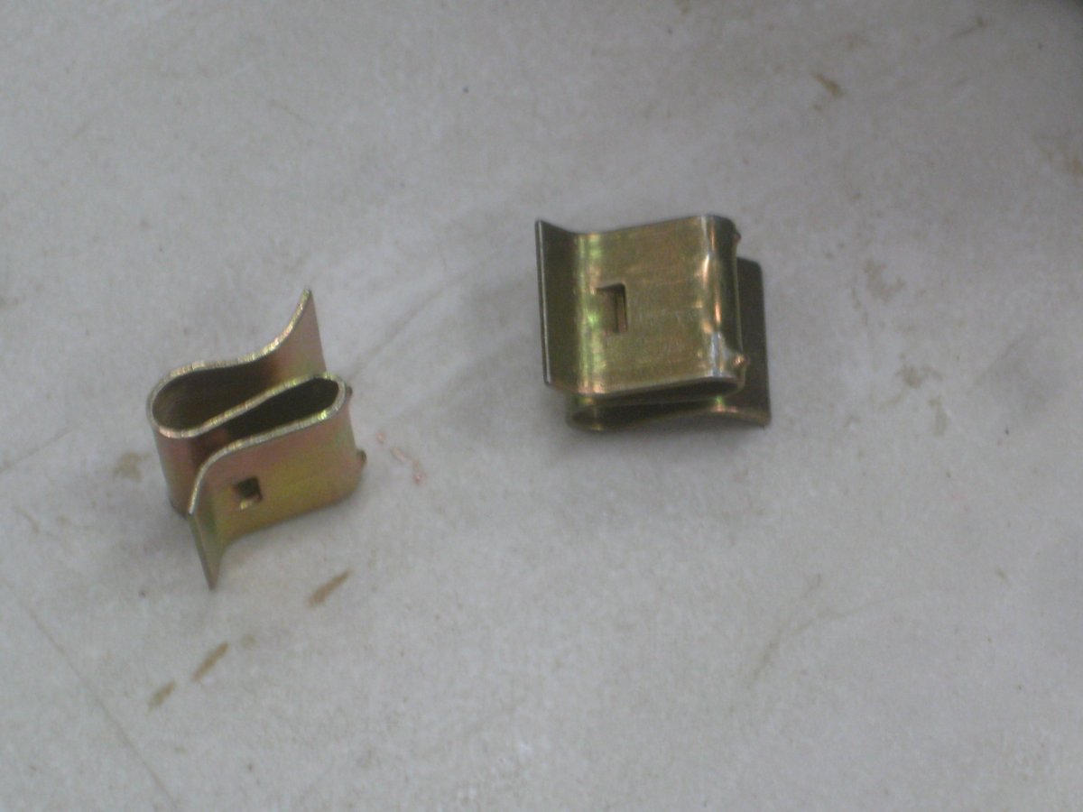

Can you post a picture of the clips?
Here they are. No scale there, but they're in the range of like 1/2-1".
Pretty sure I can re-use oem clips if that's what these are. Just didn't want to miss anything. Seems like the rad just sets in there with those 2 bolts I don't see what these could have to do with it.

Aren't those for helping hold the shroud on?
Edit; iirc those go on the bottom of the rad, the shroud slips into them, and then the top bolts go in.
I kind of thought it was something like that. But when I put the shroud on it goes into grooves at the bottom so it can't flop around (and held at top by bolts of course). There wasn't any such thing on the ass'y I took out. Maybe they could go halfway up the sides, I'll check. But it seems totally secure. If there had been those clips, I would have had to take them out to get the shroud loose and I didn't have to do so. I'll check but I'm quite sure the shroud as it sets not cannot go anywhere (meaning, flop backwards at the bottom).

Well, I dunno, the shroud is totally immovable on there. There are grooves in the rad body that the shroud is pinned into. If you are talking about the middle of the bottom, I suppose you could put them there. I don't see the purpose.
It's possible the radiator is packaged to fit multiple applications and the clips just don't apply to yours. If there was nothing resembling them when you pulled your old radiator out and no obvious place to use them, I'd just stick in them in a drawer for a couple of months and move on.
those types of clips can also hold a piece of wire. i am not sure if they apply to this engine though.
No my rad didn't have those at all. The shroud is held in real well. I think they aren't needed for me.
I think they could be to hold shroud (not this truck), or hold wires, or maybe to hold overflow tube, you could bend them. For overflow clips I re-used existing they fit into holes the right size and place. I am basically 100% sure I don't need the clips, so they are just extra parts.
yep, I am with fastpakr here. my radiator did not come with those, and I definitely don';t remember them on my truck. toss them in a drawer/ toolbox/ garbage can and move on. Glad you were able to get your lower trans line unbolted though. that was the living devil for me although a flare nut crows foot wrench might have been a huge help. did not know they existed. regular crows foot wrench did not work for me :(
