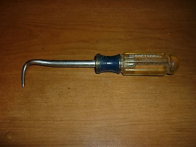

They make a tool that looks like a much larger dental pick that is pretty handy for removing stuck hoses too.
This is my favorite hose removal tool.
Common name for it is "cotter pin removal tool", but it was better known by radio installers as a "nose picker" (don't ask me why; damned if I know).
Same tool is made in several brands, but the old Craftsman version like this seems to have the best diameter and curve angle, to allow sliding the point in under the rubber, and then sliding the hook sideways around the nipple to unstick the rubber from the metal.
It's actually one of the handiest tools I own. If you ever see one, buy it.

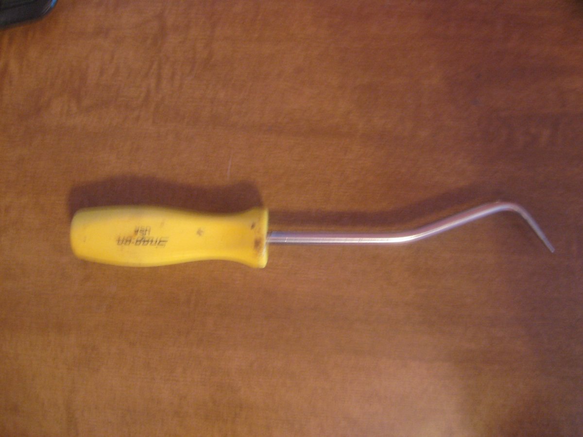

Interesting, that does look real handy. I just bought this one, looks similar, will have to keep my eyes open for a Craftsman ones. I am a slut for tools.
Duh. I just made a nice tapered pry tool from wood which won't scratch stuff.
But I actually have a similar tool. THANKS. pls excuse crummy photo
The Wilde brand that you linked looks identical, on the business end, to the old ball-handle Craftsman.
And yes, I'm a tool slut too.
Yes, that Snap-on version can come in handy for hoses. It's best if the tip is not that sharp, and just go easy with it. When the hose is real old and the rubber is stuck to the metal, wiggle and push the tip in between the rubber and metal. Don't poke through the rubber and don't work it too hard or you can slip and poke yourself real bad (don't ask how I know . . . . ).
The right-angle hooks allow more leverage, but your Snap-on version will work, too.
On real stuck hoses, once the hook is in, I'll put a straw on a can of WD40 and spray it down into the gaps just created beside the hook. Then you just slide the hook sideways around the nipple.

Didn't take me long to get it off with the tool, thanks for pointing that out. You can actually work all the way around inside the hose and keep the tip away from the nipple.
Yeah I can see how you could poke a hole in your hand or the hose. I just keep it kind of flush in there, the shape is correct for the job then you twist/lever it a little in the stuck places. It works real nice.
