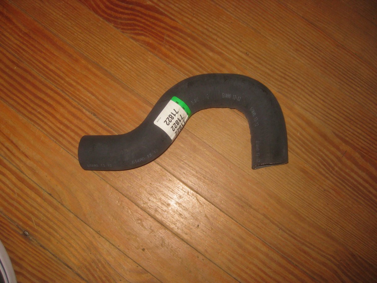

So here's the Dayco hose Advance says fits. This CANNOT be right because the engine coolant inlet is perhaps 6" behind the radiator outlet. I don't see any way in h*ll this could possibly fit.
It's definitely not a match to what is on there so seems like Advance doesn't know wtf they are talking about.

Looked at Advance Auto Dayco hose and -maybe- it would fit but I don't think so. Holding on to it to compare to the one I got from Rockauto which I hope is right.
What I'm saying is the Advance hose is definitely a different shape than what I have and I do not think it would line up with the connections.
