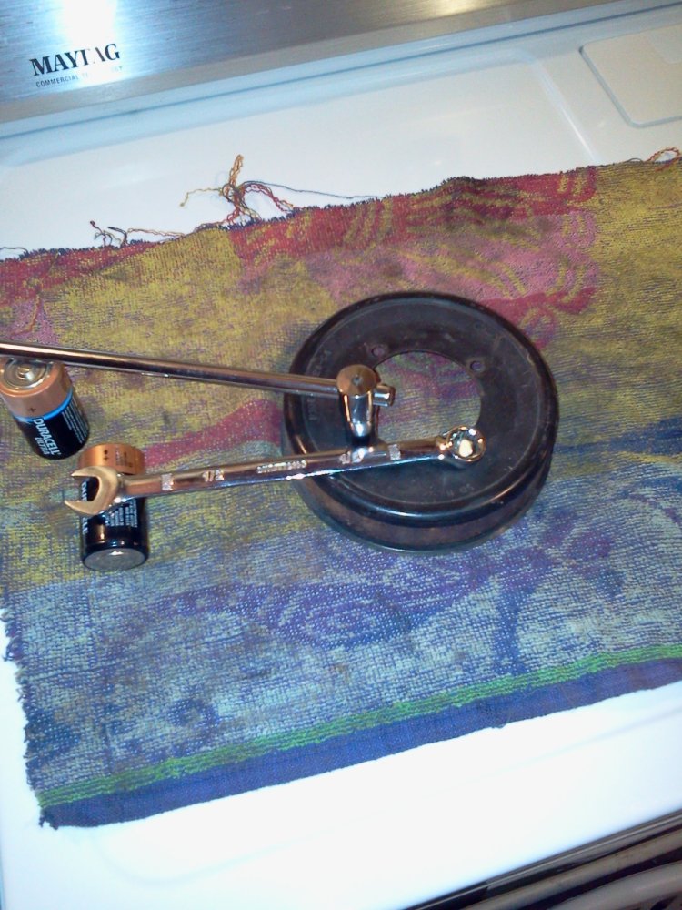

a water pump holding tool can be improvised. for pulley removal.
grab a boxed end wrench slightly larger than a bolt head, place it over any bolt head and hold it there.
put a socket on any of the other bolts (with bar or ratchet) and rotate until the socket comes into contact with the wrench.
pull/push as needed. leave one in loose so you can get the last tight one.

Thank you all. Grearwrench set looks expensive. Improv looks good especially if it's a one-off thing. Seems like you could make it.
