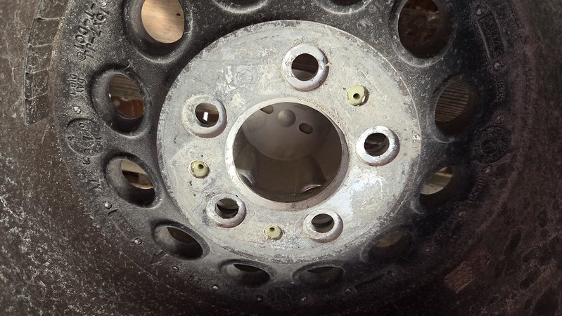

Older Ranger wheels are not hub centric. I don't know when the switch was.
What is the hub bore of the wheels?

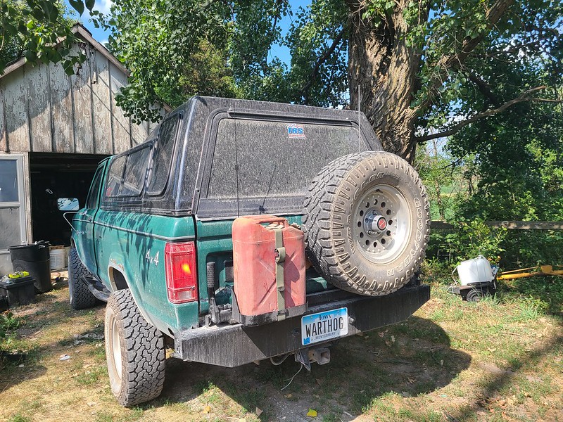

Mine are aftermarket with plastic push thru hubcaps.
Questions about 1988-1992 wheels
I do have a factory wheel for a spare though.

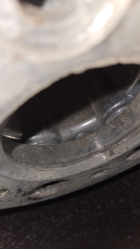

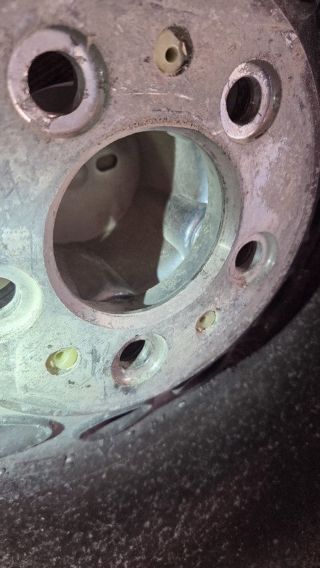

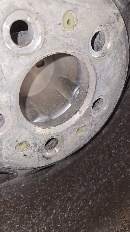

Pics of the back side of my spare tire:
