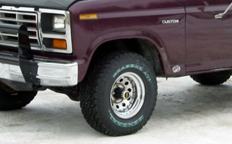

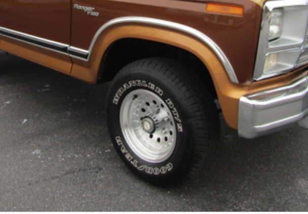

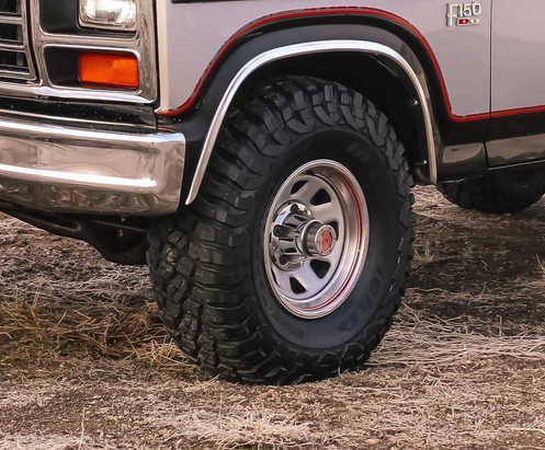

I have a white 07' 4.0 4x4 Ranger that I currently have a set of 15x8 steelies on. I'm continuing to have vibration issues and I've pretty much narrowed it down to poor tolerance in the construction of the wheel itself. There is some warping in one or more of them just because of the way they are constructed that is probably the source of my vibration issues.
I really like the look of the wheels I currently have. They're all black with window cutouts. Not gaudy, very simple, but they look great. I think I really just need to bite the bullet and get aluminum wheels. I want something simple. In considering my other options, I really like the look of the 80s-90s wheels that came on the F-150s and Rangers:
All I need is something that's 15x8 and clears. Does anyone have experience with these wheels and can offer some insight? I am wondering about clearance for hub rings on the back face of the wheel (another issue with the steelies) and any other unforeseen issues I might have.

Stock wheels fit like stock wheels. Ranger had wheels like the ones on the brown truck, so did BII's and Explorers. American Racing Outlaw II wheels are similar.
Black truck wheels were only available on F-150's and are stamped panted steel.
Maroon truck wheels are aftermarket so who knows what there. Those are chrome plated steel.
