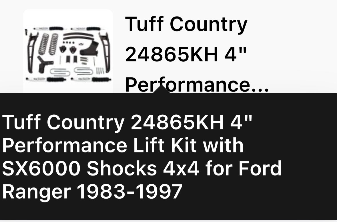

Hey everyone. 1994 Ranger 4.0, 4x4, I would like to lift the truck 4 inches. I have heard bad things about RC, so staying away from them, then I heard about tuff country. My budget is $1,000USD, and wouldn’t like to go over that, what would everyone recommend that has the similar year to my truck and installed a lift kit? Any issues with camber and caster afterwards? I have heard good things about skyjacker but they are a little too expensive for me, I do have other things I need to save for aswell. Thinking about going with this kit since it’s on sale for $1,000.

Don't know anything about it. It uses drop brackets and extended radius arms for the front, which is the right way to do it. The question is, how well are their brackets engineered. The biggest problem I'm aware of with Rough Country is that their brackets somehow allow something to poke a hole in the differential housing, I would guess during big articulation. If Tough Country does NOT do that, then this might be a good kit, or at least a good starting point that could be modified and strengthened later if necessary. The add-a-leaf for lifting the rear may be ok. I would prefer that instead of blocks any day. But new springs with more arch are the best way to go there. Longer shackles could be used also to adjust rear ride height.
I know the dilemma of wanting to achieve a goal that happens to be expensive. I would be an idiot if I didnt6recommend being patient and saving more money so you could get a kit from Skyjacker or James Duff. But I've been in your shoes many times. My best advice is "do as much research as possible before buying." And that's seems to be what you are doing. Try to study as many of the articles in our tech library as possible and weigh that with the answers you get here.
The Rough Country kit is built around the D28 and for some ridiculous reason they haven't updated it in the past 30 years to work with the larger D35 differential case... but they say it works with the D35.

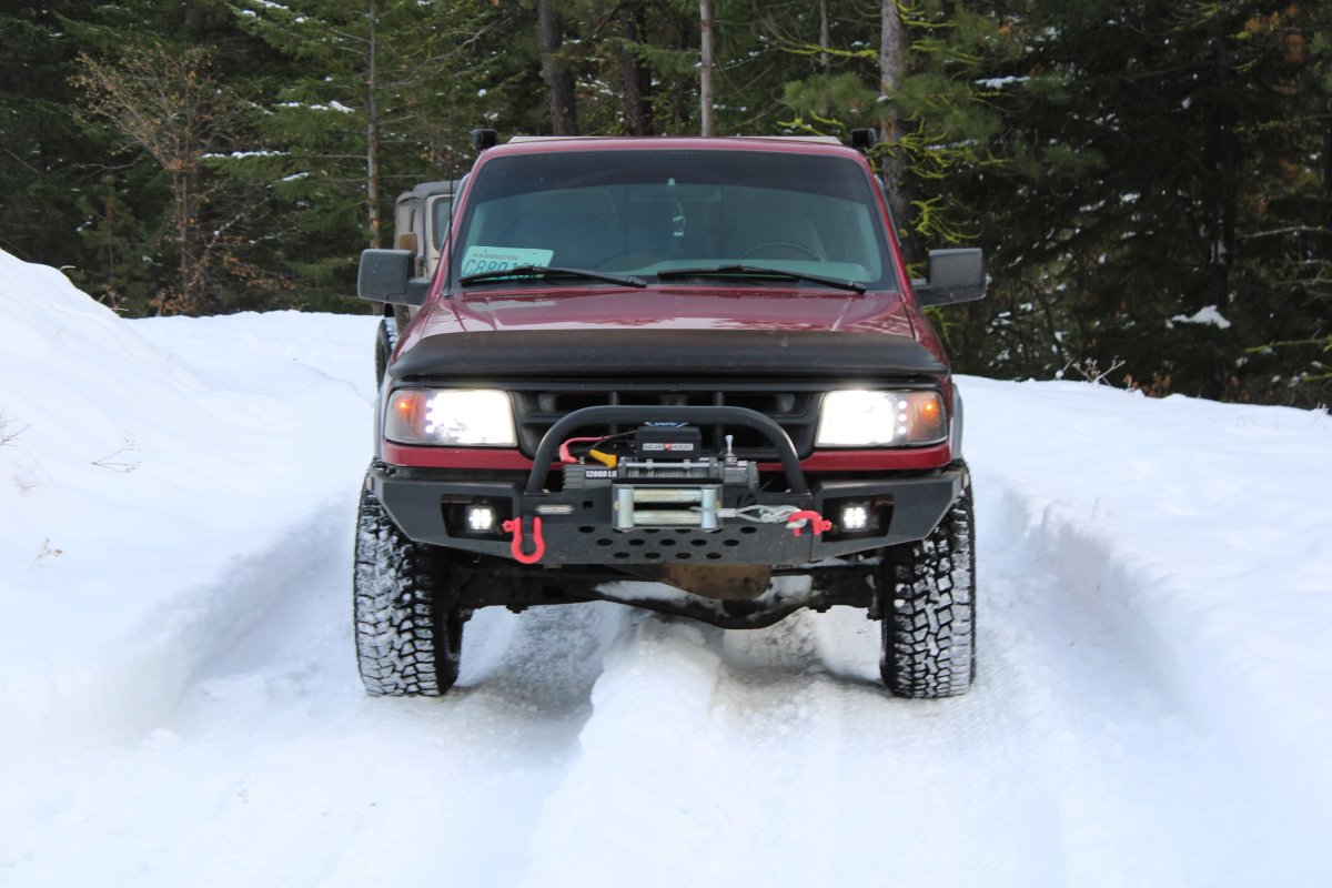

These trucks are pretty capable in stock form. More so than a lot of people realize. It’s definitely something to keep in mind. Good tires and at least a rear limited slip if not a rear locker will get you a lot of places if you are a decent driver.
On a 94, you can get 2” of suspension lift relatively cheap, just a spacer/stack of big washers/90’s F-150 spring perches under the coils in the front and a 2” “drop” shackle set for a Chevy 1500/Ford F-150. Probably longer shocks and an alignment. That’s what I started with on my Choptop. I didn’t keep it like that long though before I went to 3”, then 5”, then added a 2” body lift. I know why I did it like that (money and mechanical knowledge were limited as I started the process). Looking back, it might have been better to just do the whole thing in one go rather than piecemeal because I knew from the start I wanted to end up running 35” tires on it.

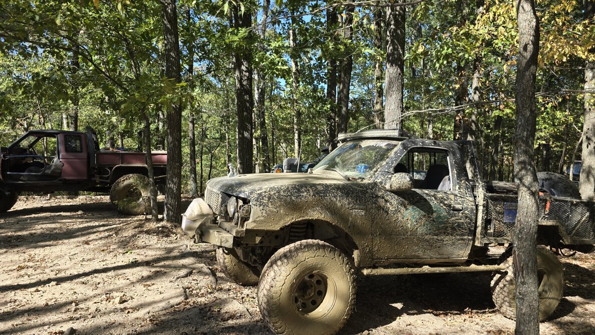

My 88 Bronco II wasn’t ever intended to be built that big. But I had some leftover parts after the Choptop grew, so the 88 got a 2” suspension lift and I built a set of long arms for it because that will help the suspension do it’s thing (stock arms are rather stubby and don’t let the front suspension freely move) and it’s getting a 1” body lift. Probably a minor fender trim in the front because first gen trucks are a little small in the front wheel arches and it will get 31” tires because I can. Probably excessive. In college I had an 89 Eddie Bauer Bronco II on 30” mud tires and stock suspension and I wheeled it a few times with a YJ on 34’s and a TJ on 36’s. I couldn’t do everything they did, but I went a lot of places that surprised them.

I kinda downplayed a bodylift earlier but that is all my truck has.
I have really been quite impressed with it on trailrides and the Vagabond trip. It also allowed me to fit bigger tires and opens up things in the engine bay and makes things much easier to work on.

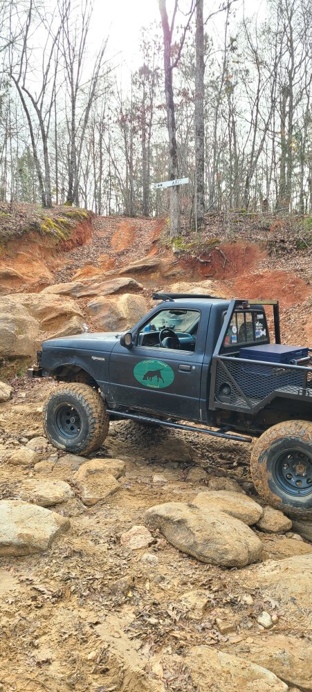

View attachment 120659View attachment 120661
The thing is I can afford it easily. I have money in the bank, only thing is I’m not sure if the kit is worth it or not.
It's a cheap lift that is designed for tire clearance and not necessarily good offroad performance. Shocks are probably mediocre at best... springs are probably pretty stiff.
31's are a great size for our trucks and if that's all you ever want to run, I would just run a spacer lift and/or a body lift. Get some good shocks (Bilstein, KYB, etc) and spend the rest of your money on bumpers/winches/skid plates/etc.
Just speaking from experience, I have one big truck on 35's with about a 7" lift that has very little armor and an Explorer on 30's with a 2" lift and skid plates everywhere... they are both fun & very capable. It is really nice to go out and be able to drag the little truck over everything and not worry about jamming a rock through the transmission or whatever. Money spent on armor right at the beginning is money very well spent.

I see, here is what my current truck looks like. I just took it up and would like to go regularly, you think it would be worth it just doing blocks? I would also have to get rid of my all around Bilstien shocks, which sucks, should I just throw a spacer under the front coils and maybe a little spacer in the back??
