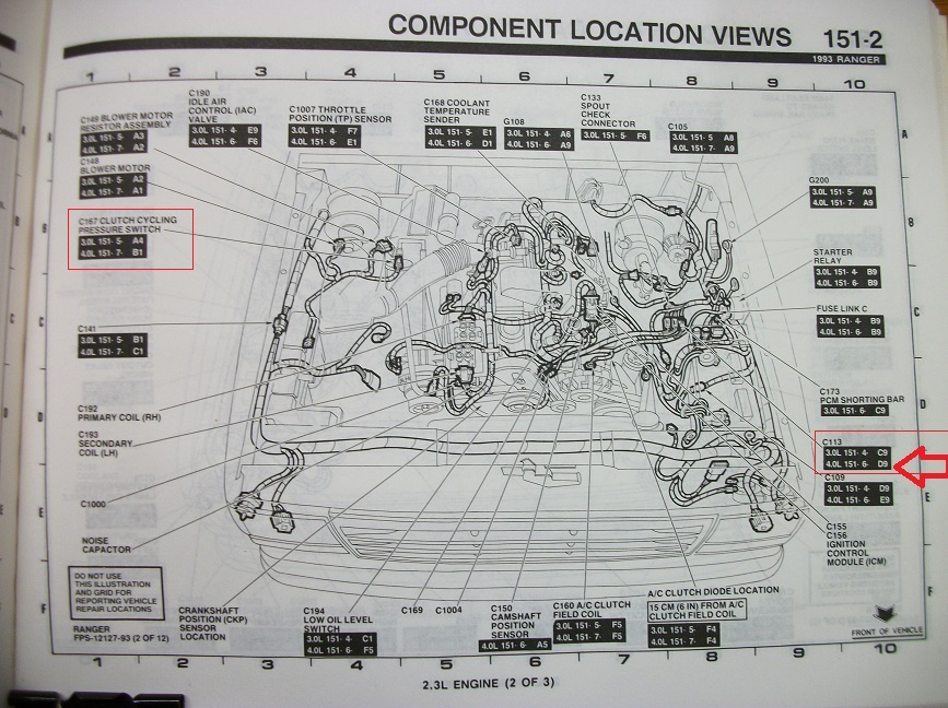

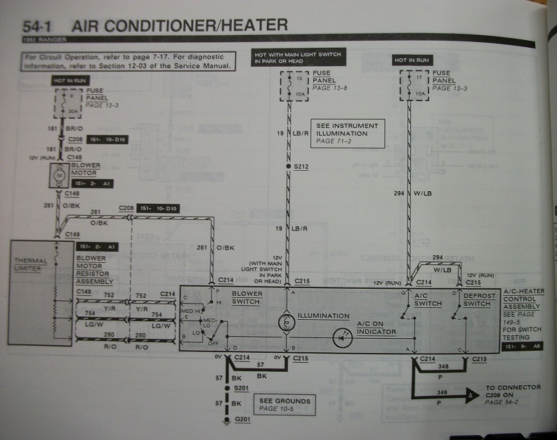

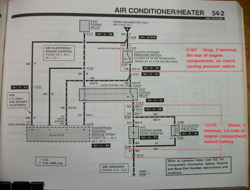

Hopefully, the one plug that you have found is C113 (see the 1993 diagrams that I include below), which will need an extension harness to go to the compressor, that will also include the AC diode. If this is the case, I'd get the short harness from a junkyard donor.
The other connector that I hope is in the truck already, is C167, for the pressure switch. Look around the passenger rear corner, for an unused loose connector, or an unused one that's taped off to a harness.
I suspect that you're OK on the inside switch wiring, and I suspect that the existing PCM is already wired and will work like it's supposed to.
Use wire colors on these diagrams, and the locator view, to help you in trying find those two engine bay connectors.

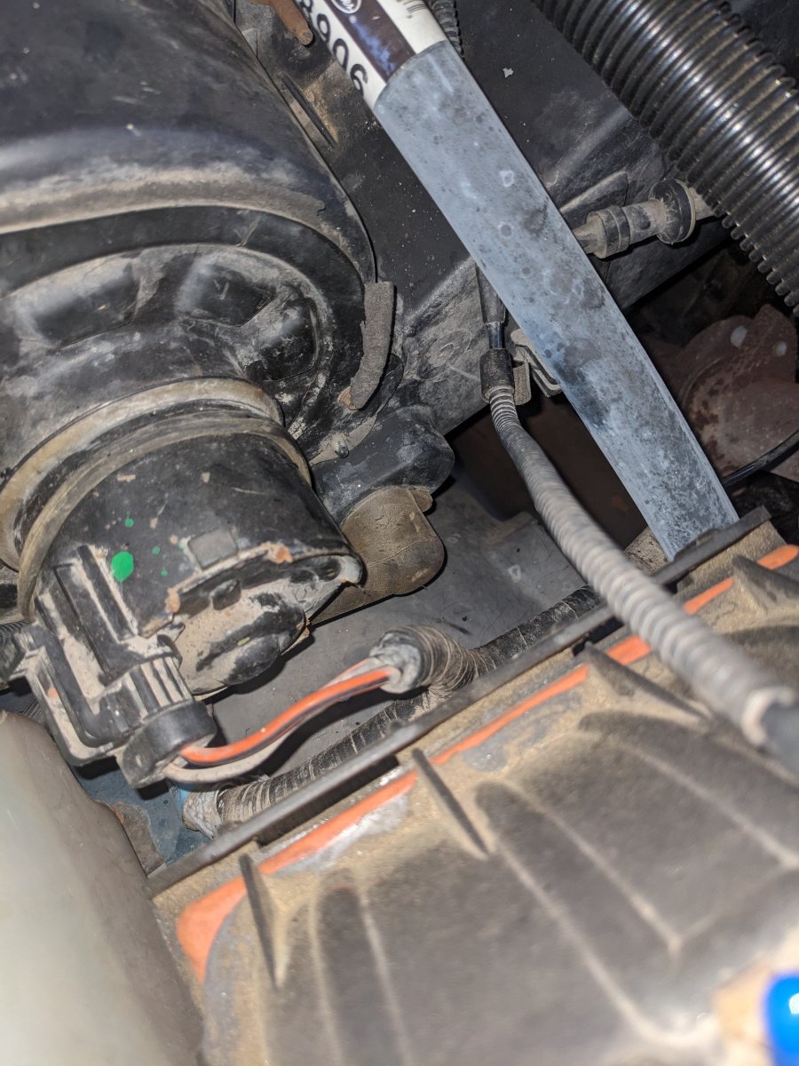

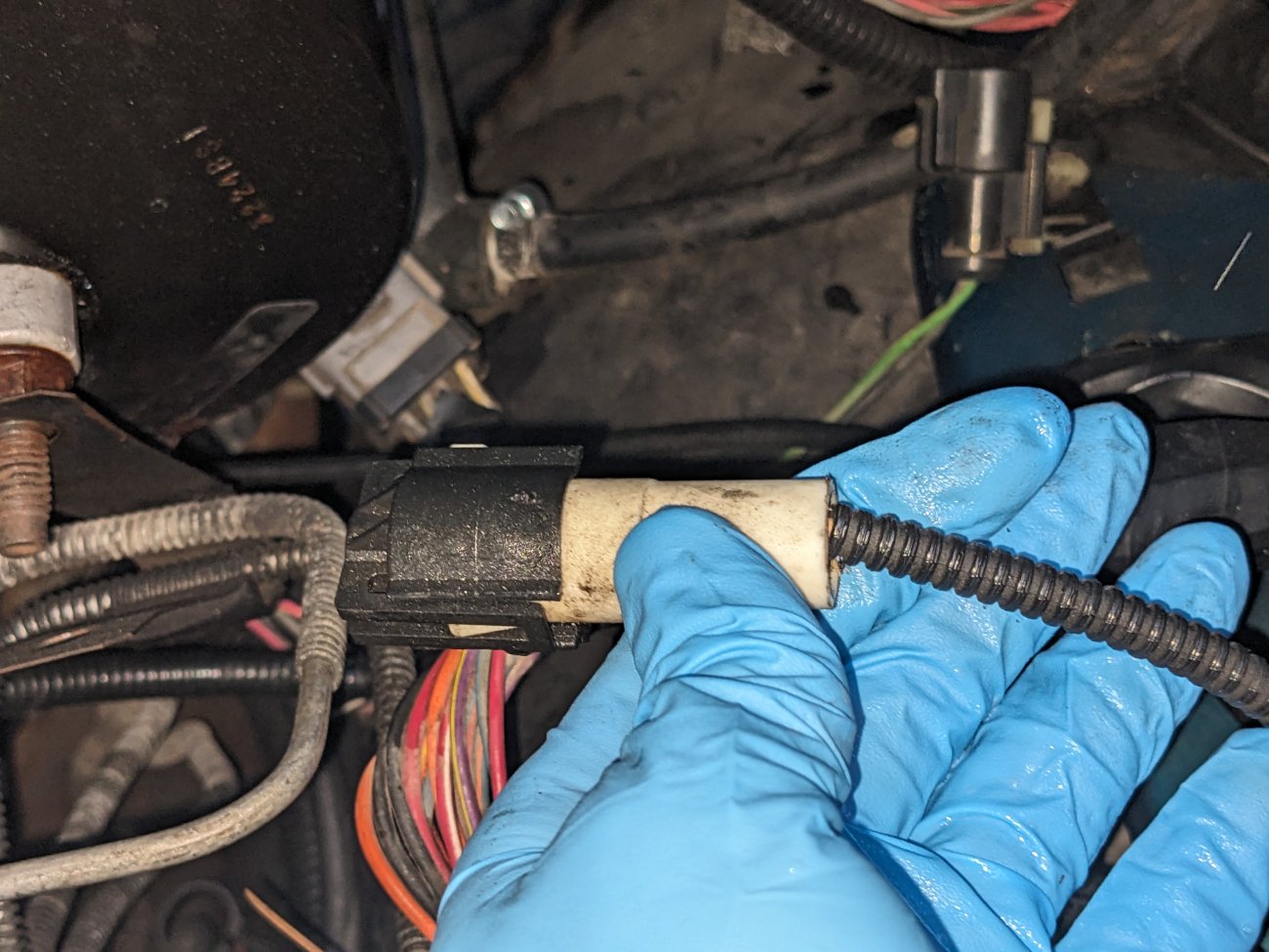

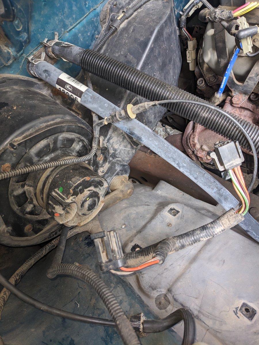

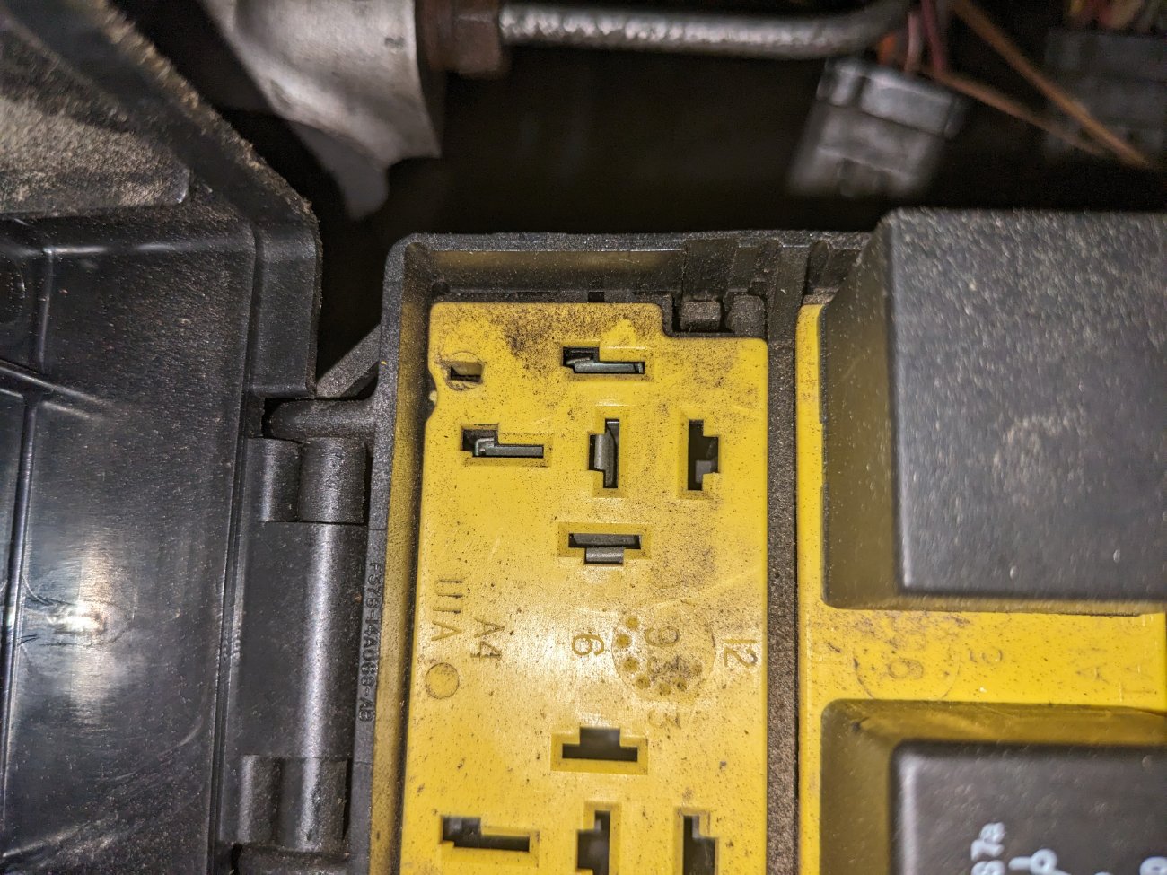

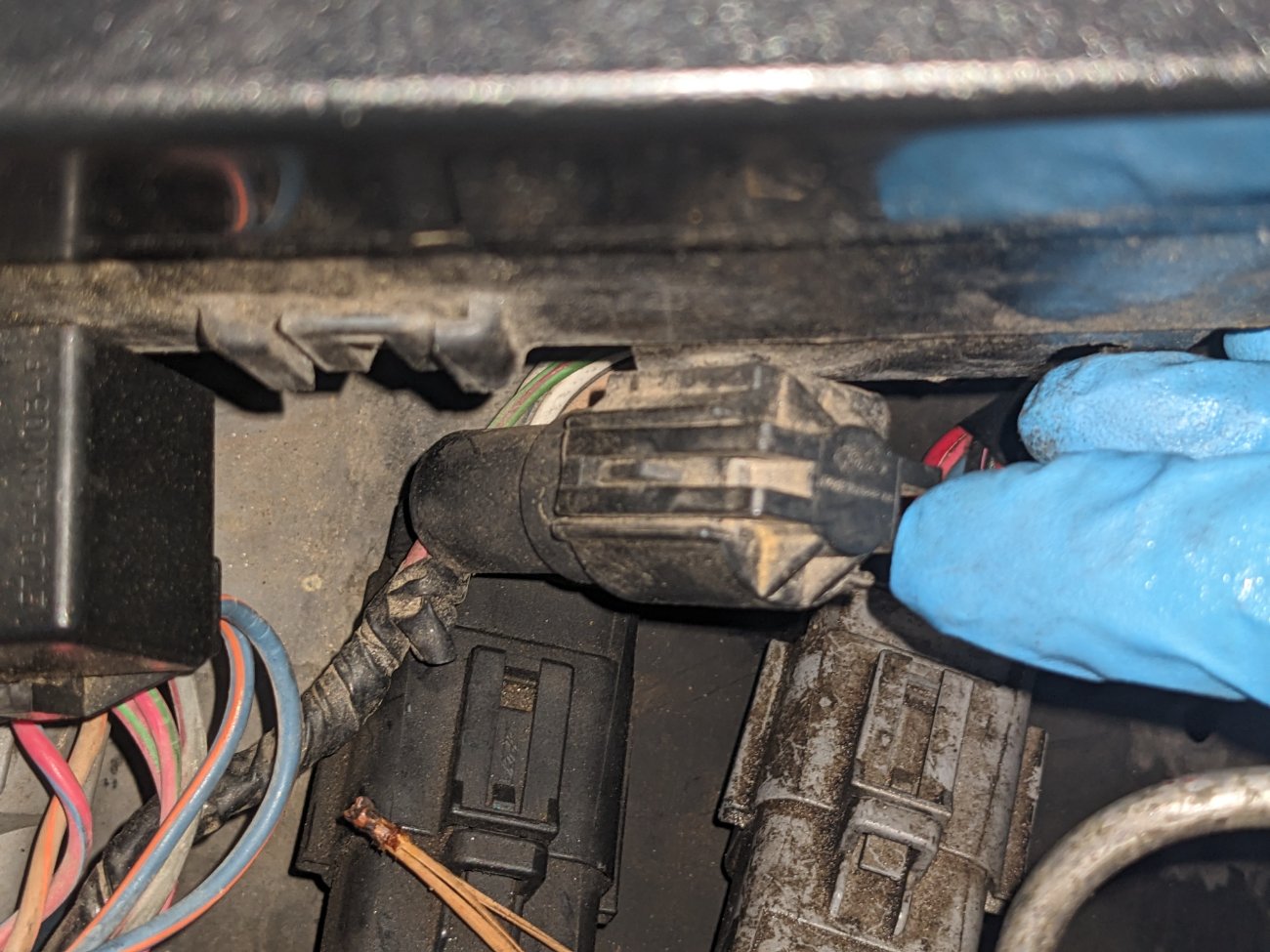

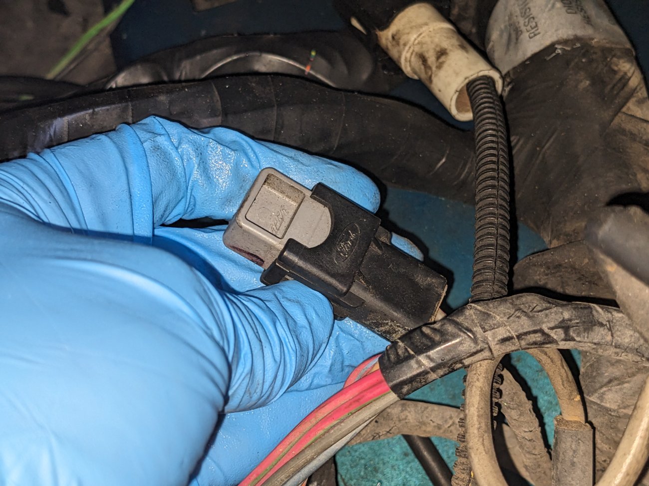

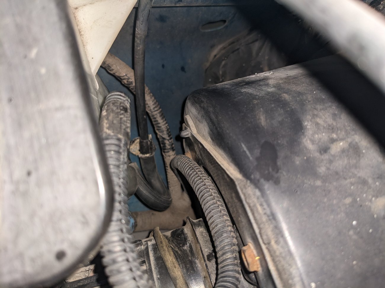

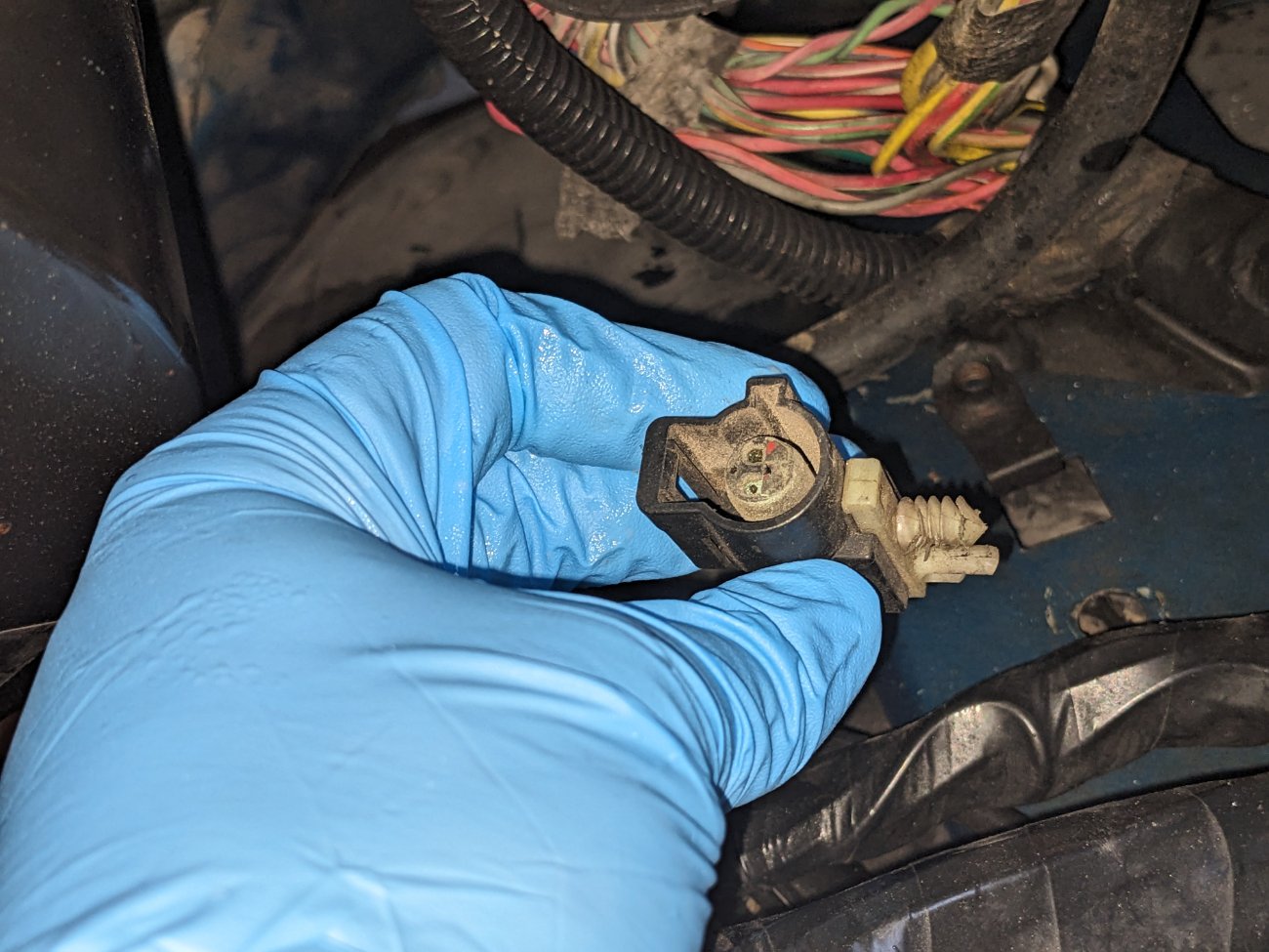

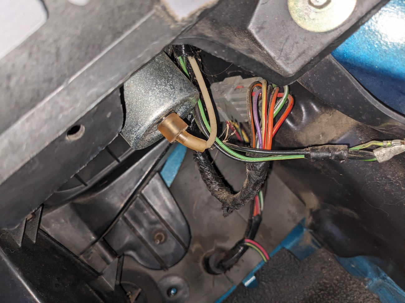

So I took some pictures in the engine bay and interior. The driver side had all of the plugs pictured, I'm guessing the rectangular one is the one for the AC extension harness? Correct me if I'm wrong. Also I looked in the passenger side and didn't see any loose connectors from what I could see. I didn't get really digging because it's raining atm. I also took a picture if the fuse box showing the populated pins for the WOT relay and under the dash where the vacuum actuator for the recirc/ambient air flap is present and, until a couple of days ago, wasn't hooked up to any vacuum lines.

Wire colors at suspect plugs will tell you the most.
C113 should have a Black / Yellow wire, and a Black wire.
C167 should have a Pink wire, and a Dark Green / Orange wire.
The rectangular connector in your picture #2 looks like a shorting plug to me, like the one used to set the timing.
Unfortunately, the 1993 EVTM does not show C113 and C167 as connector views, which would hint at their shape.
That may be the diode at the compressor.
I did some more digging today. None of the driver side plugs matched the wire colors you gave me and the passenger side seemingly has no plug. I felt the loom and I didn't seem to feel any hardness like a plug hiding under the loom so I'm beginning to think I so not have the wiring. What should I do?
Get the stuff from the junk yard. It's time consuming. Or, at least get all the connectors with long pigtails so you can buy wire and make your own harness.
I think I'll just make my own harness. Im no stranger to wiring things and from what I've looked at thus far all the ECU does is the WOT cutoff which I could very well just bypass. Just wire the button in the cabin up with the switches and be done with it.
Can you get all of the connectors new?
If I'm not mistaken from looking at them they are all the same rectangle style connector and I have seen them for sale as new pig tails so I should be able to.
If the truck lacks the proper wiring, I'd also just add what's needed to make the AC run.
The schematics I posted should get you there, and I agree that the WOT relay probably isn't needed.
