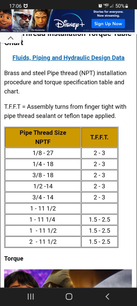

What IS the TORQUE spec for ye olde BW-1354 plugs? As usual, lamer-Chilton's and lamer-Haynes are mute on the issue...

I think it's more like 3/4" NPT fitting than 3/8", but since I'm thumb-palming a small 6" ratchet I think(?) I'm safe from over-torque...
