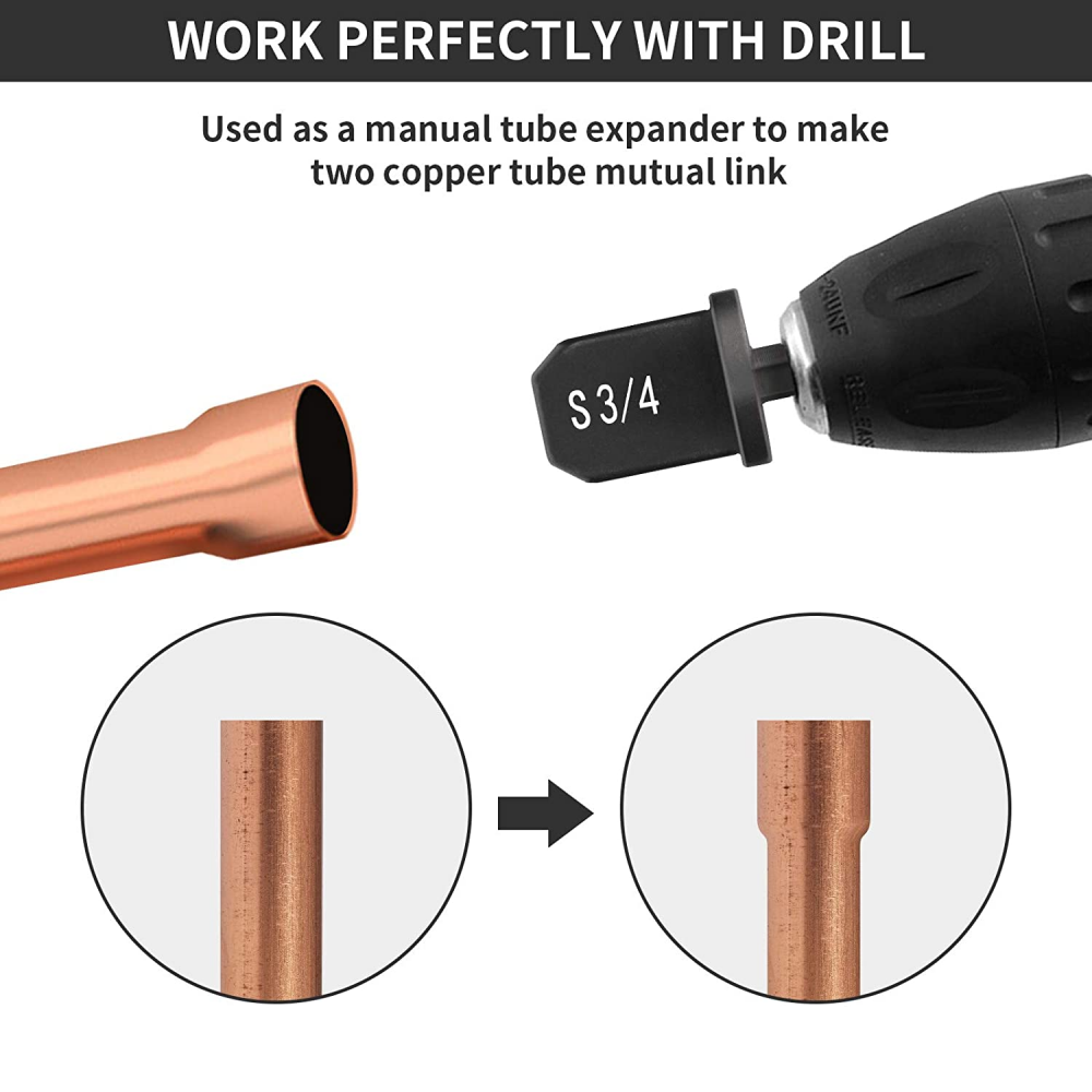

RE: using plumbing parts, the guys on "Jalopy" website make their own copper coolant system components all the time, but they "flare" or somehow put a "lip" on the end of the pipe to prevent hose from sliding off... considering ways to do that... hmmm...
theres swaging and flaring bits that do it, HVAC supply places sell them
63323
Eddo: COOL TOOL!... but probably only for annealed (soft temper) tubing. All my scraps are the hard kind (L-weight) used in water plumbing, not HVAC/refrigeration.
