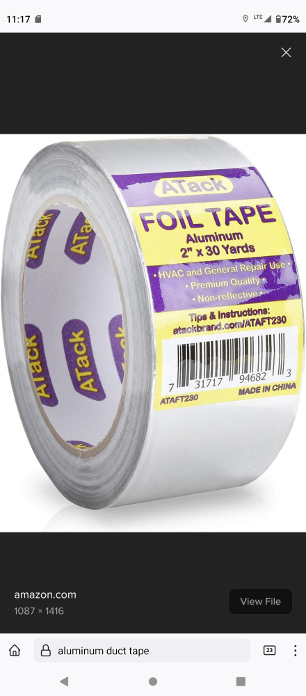

There is aluminum foil tape meant for ducts. Kinda pricey to use for just 2 feet but if you have a use elsewhere....
