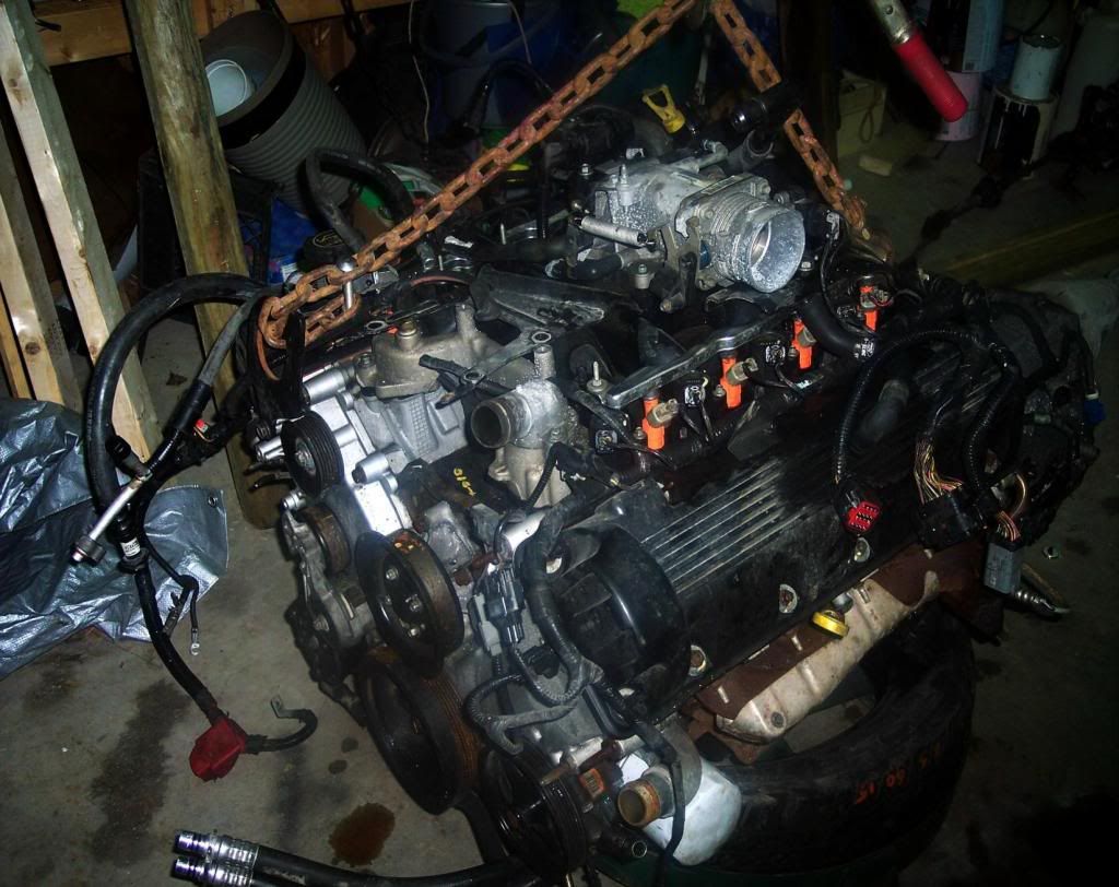

The 2004 is definitely throttle cable, not sure when they changed but I was scrounging the JY today looking for some pats modules and saw a 2006 that was electronic throttle.Here is a photo of the engine right after I brought it home
