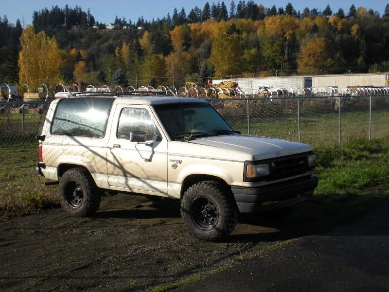

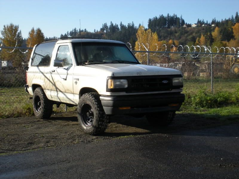

I have the B2 sitting on all four wheels again. I had to source a D35 which I got from the JY, and I had to buy a new radius arm crossmember, rockauto sells them new fairly cheap.
I did the explorer rear leaf spring swap w/o the overloads, and it sits a little more than stockish with 30x9.5 Maxxis Bighorns, Id say there might have been a 1-2" lift, its hard to tell since I never measured with the stock springs. I was more after the stiffer ride over the lift.
The front D35 is out of a 93 explorer and Im using the front coils. With no engine the thing sits sky high in the front, but I assume it will all change when the SOHC is in there.

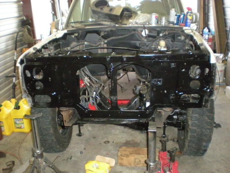

All the suspension is in, explorer rear springs, explorer D35 and front springs, manual hubs.

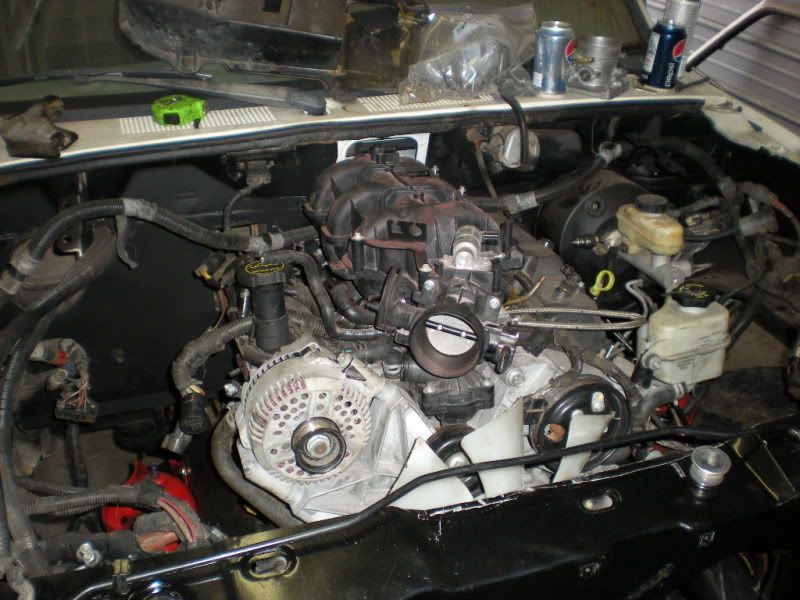

The engine and transmission is in, I had a custom power steering hose made, replaced the EGR with a homemade IAT bushing in the intake. Peeled the crap off the stock engine harness and re-taped it with the adjusted connector positions. Amazingly enough, the OHV harness fits nearly perfect on the SOHC engine, just minor adustments in positions were needed.
Anyway, Ill get some pictures up very soon, but here is a couple of teasers.
