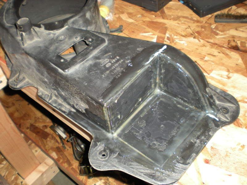

Got the rough work on the heater box done. I went to lowes and picked up an ABS catch basin and cut the plastic out from that, then I used some two-part plastic epoxy to bond it together. As soon as it dries, I can do a test fit, sand and paint her up, and then get the engine in permanently.
Wow, that almost looks professional. I just used some ductwork sheetmetal, coarse thread sheet metal screws, and black RVT when I did mine. I did the exact same notch too.

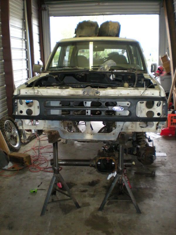

Just a little update on where im at.

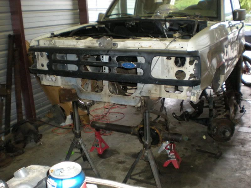

Got it up on jack stands so I could get some real work done.

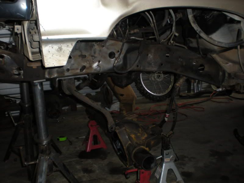

Got all of the TTB stuff out and those rivets really suck.
Its coming along nicely. Its looking like ill have to move a little tube over to the short side of the front axle so I can get my leaf pads on, as it sits right now they would hit the side of the pumpkin a little. Im going to put some 2.5" wrangler fronts in, the length is just about perfect, I should still be able to use the navajo front bumper. If it ends up being too soft, ill probably find another leaf to add in, I dont think ill have a problem with flex, the springs are going under the frame rails.
I gotta get some shackles going and a little plate welded to the frame.

rivets really suck.
You talking about those solid steel ****ers that are about 3/4" thick in the middle and appear to be pressed on both sides? I had to drill and grind some of those on my trans cross member mount to move it forward for my AOD. Yes, those do really suck. :annoyed:
