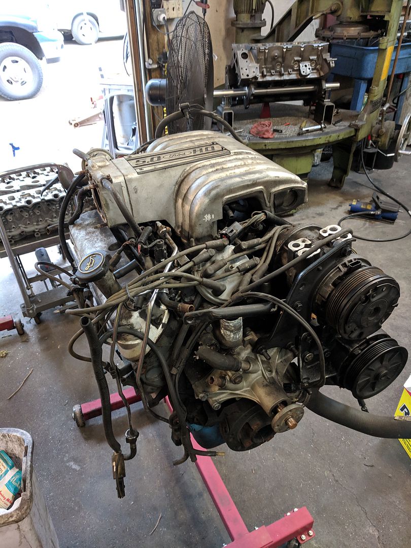

Tomorrow evening I'm going to try and get the interior pressure washed while it's nice and can dry properly. Next project is to start pulling the engine/trans.

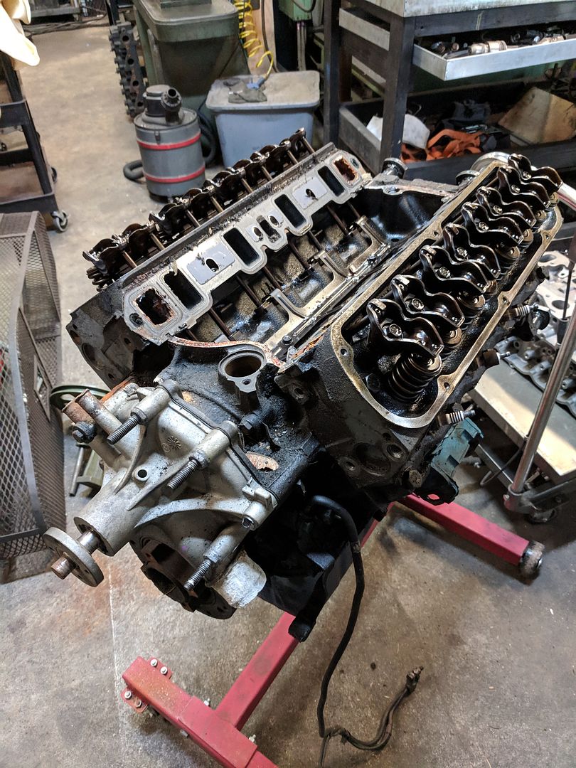

I've decided to take the HO engine I have and build that. It's been hard for me to make time to get to the JY, so I'll make do with what I have until it comes time to get the front accessories, and I'll get the explorer stuff then.
After much deliberation, I've decided to send the HO intake to T-Moss and work his end (yes I understand all the aspects of the situation, and it's literally the most economical way to get where I want to be with this engine, I've been stirring on it for a couple weeks)...

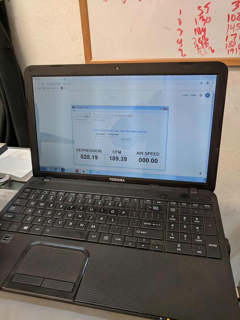

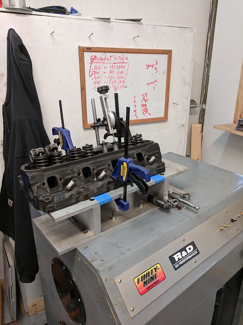

I flow tested my GT40 heads I ported over a decade ago, and am very happy with what I got out of them... No flow bench then, just a kid in the garage grinding away with the best info available.
Intake:
.100- 55cfm
.200- 130cfm
.300- 184cfm
.400- 208cfm
.500- 218cfm
.600- 218cfm
Exhaust:
.100- 35cfm
.200- 102cfm
.300- 145cfm
.400- 171cfm
.500- 188cfm
.550- 189cfm (coil bind on the test spring)

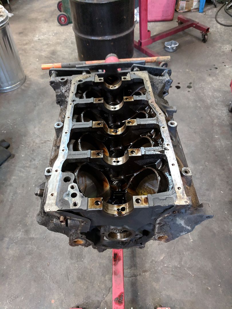

Plugging along, not a huge update...
Engine is all broke down. Crank was shot.... Leading me to my next step. I started adding up the cost of the parts I was going to use anyway, as well as having the crank reground, and my time into reworking the stock rods, and it would be like $100 more for a stroker kit.... So that saves me some time and I get some cubes out of it, that's the direction I'm going.

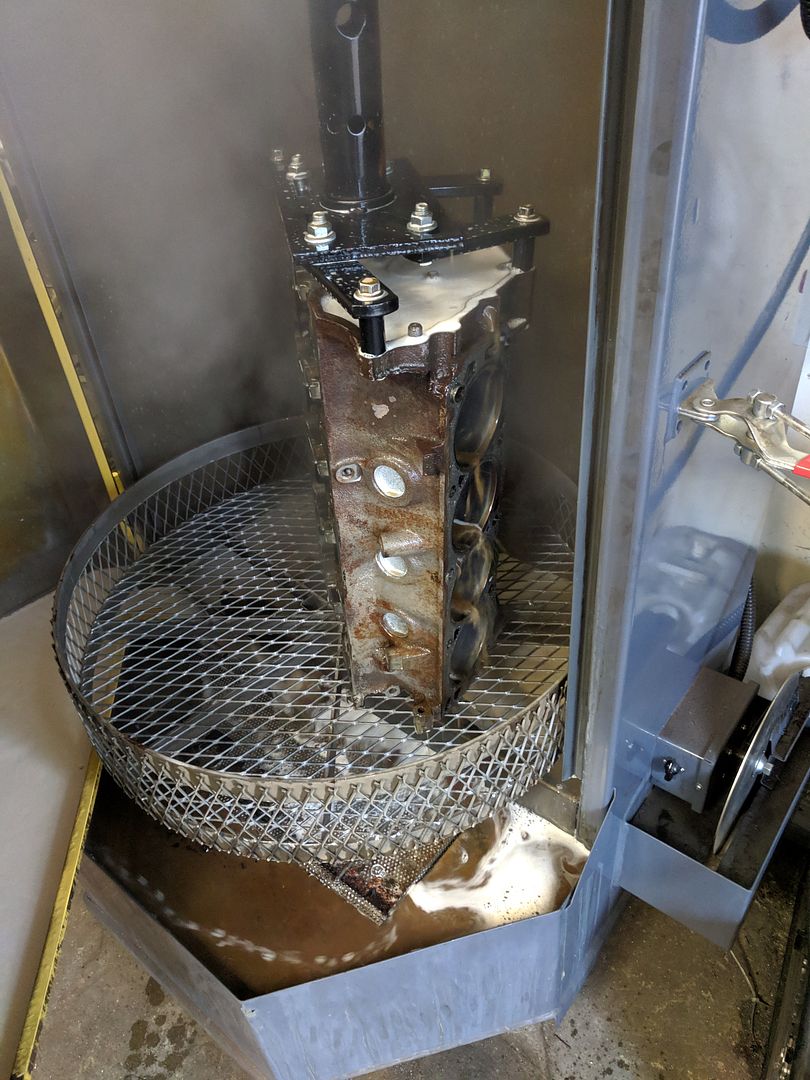

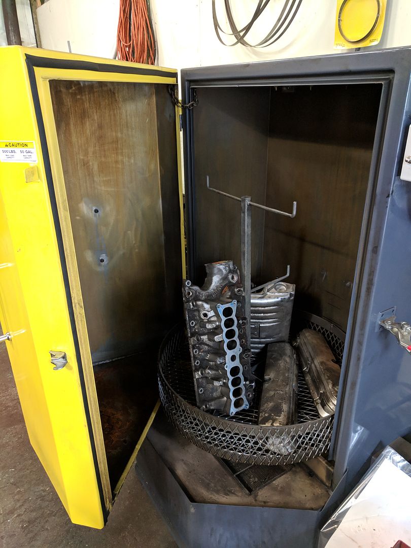

Spray washer was open tonight between diesel heads and blocks, so I tossed the block in and got it cleaned up.
I'll get some more up when stuff starts showing up.
