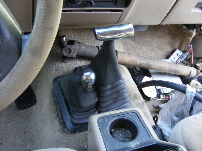

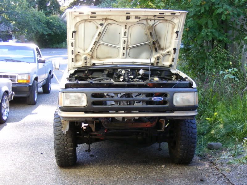

After doing some wheeling with my friend doug in his XJ, and finally getting some sunny days to work on stuff, I decided to get this sucker running and have fun with it this summer.
Yesterday, I went out to the JY and picked up an almost new clutch hydraulic hose and some inner fenders. Today Doug helped me and we got the T-case in and the shifters hooked up, as well as the injectors rebuilt, intake/fuel rail on and a bunch of little stuff. Tomorrow I plan to hit the JY and grab some stuff and Im hoping to have this thing going by this weekend, its about 85% of the way there. Hopefully I dont have any hang up's.
Also, I challenge anybody to post pics or video of a running SOHC/EEC-IV in a first or second gen RBV. I know there are a couple of people who claim to have done it, but there is no proof, at least that I can find. If your smart enough to do the swap, your smart enough to post video, I know I will as soon as I start it. If nobody can show proof, Im gonna claim first documented SOHC/EEC-IV swap.
Anyway, here is a couple of pics... More tomorrow.

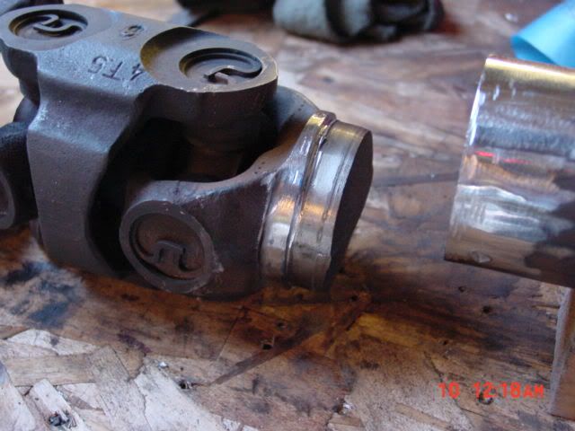

Today I hit up the JY to grab a front drive shaft from an explorer to shorten for the rear. I pulled a shaft and yoke and started to walk through the yard, then I noticed a Mid-90's sport. So I went and checked it out, and notice its a 5-speed, and the shaft was still there, BINGO! So I found the sought after explorer cardan shaft! Also picked up a couple of other small things.
Project El Taco...1990 BII
I installed the airbox and then proceded to shorten the drive shaft...

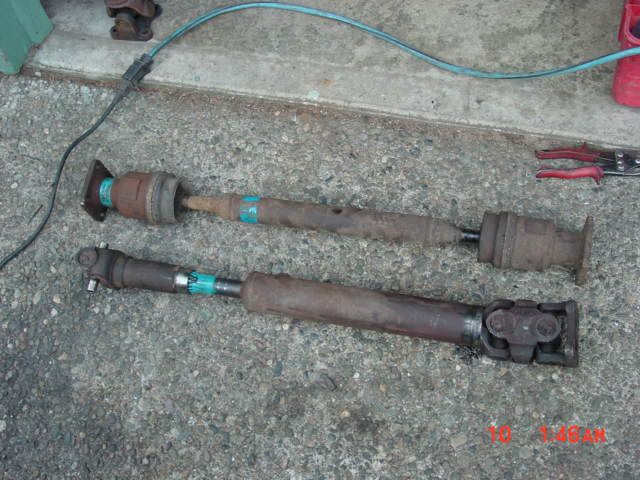

Here is the diffference between the stock B2 CV garbage and the explorer sport Cardan shaft:

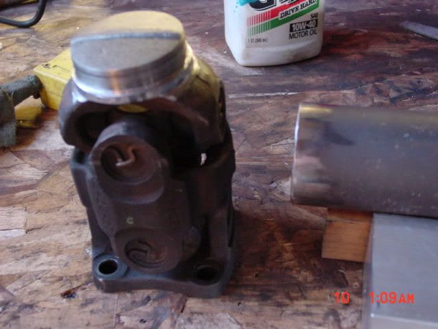

So the process begins... I marked a line with permanent marker about 8 inches down the length of the shaft on the Cardan end and proceded to grind the weld down flush with the tube.

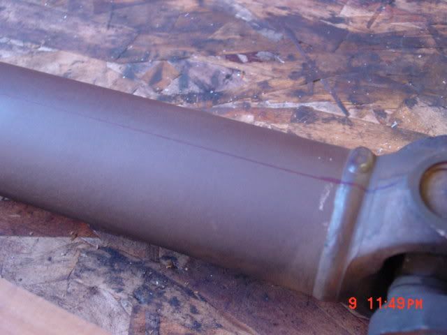

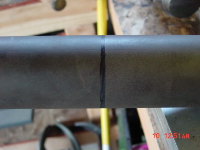

Then I wrapped masking tape around the tube in about where the center of the weld was and drew a line around the edge of the tape.

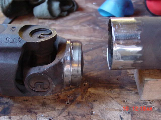

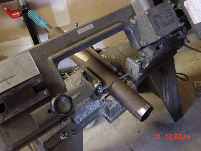

Then I took the shaft to the bandsaw and followed the line around about an 1/8" deep. Next I took a Deadblow and knocked the flange off and out of the end of the tube.

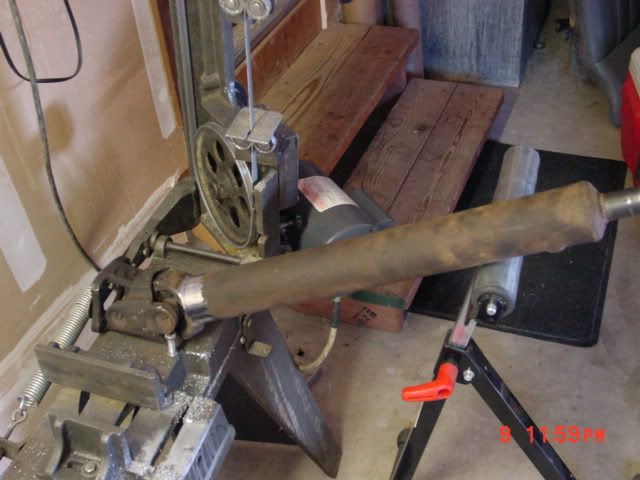

Next I took and Marked the tube 6" in from the end just cut off (the difference of the two shafts to make the length I need) and again masked it off at the line and drew a line around it, and took it back to the band saw and cut it off just shy of the line...

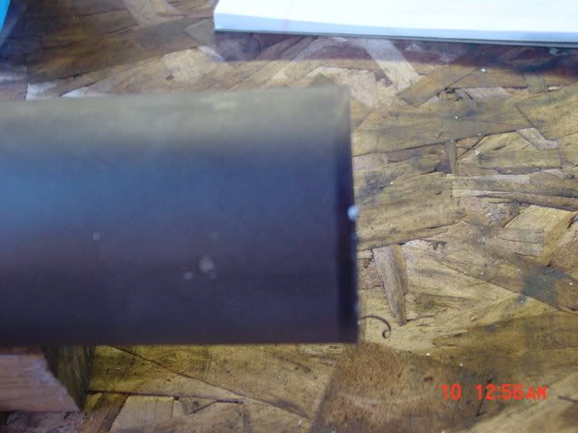

Then I took a grinder and ground the rest down right to the edge of the line so that the end was perpendicular to the tube and checked with a square. I also ground the surface of the end so I could get a good weld on it.

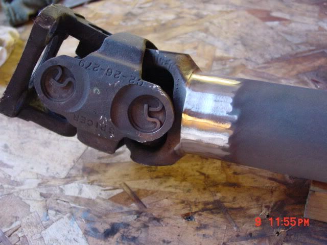

I lined up the lines and installed the end in the tube all the way up to where I sawed...its a very very snug fit.

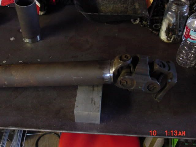

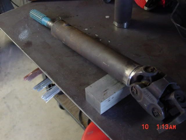

Then I threw a tig weld down on it just because I can :D
Done!
