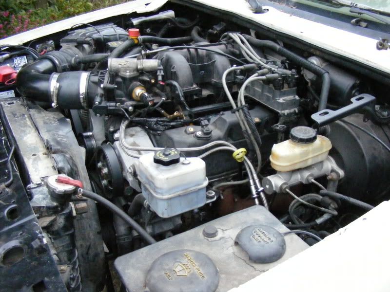

Here is a few pics after I turned it around and after the engine bay was together:

Tomorrow after work, I plan to get the exhaust done, get the hood on, and get the front bumper on as well as do the blinker Mod as im not putting on the lower valance and blinkers.
