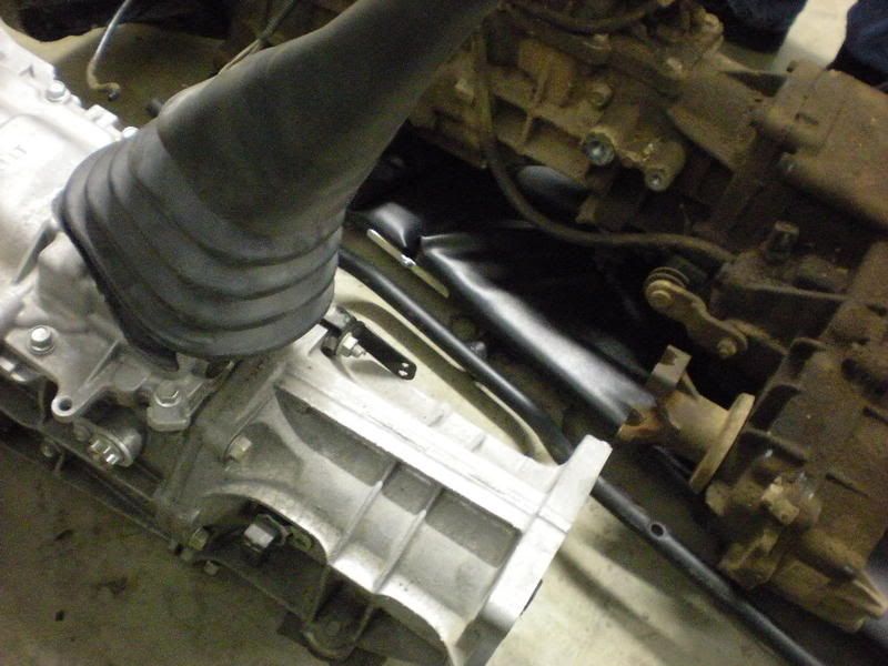

Got a killer deal on a M5OD-R1HD from an 06 ranger today!
The thing is like brand new!
I picked it up for $300.
I wish I had the money to buy the 4.0 that was in front of it, cause that thing would be going into the B2 instead.
Here is a couple of pics after I pulled the engine:

if you pulled that trans from a SOHC motor, im pretty sure it wont work. Last SOHC motor i worked on had a different bell housing bolt patter than the OHV motor.
The bellhousing has both patterns.
Everything I have read says it will work fine, thats why I even went after it.
Even if it wont work, I can always take out the internals and put them in the navajo case.
i just finished a clutch on a 03 ranger this evening. the housing IS different BUT the clutch setup will work and so will the bolt pattern. the primary difference was the bottom has bolts that go all the way to a tab on the block/pan but they do not HAVE to be mounted to the block. the earlier m5od1 dust shield. it SHOULD work fine.

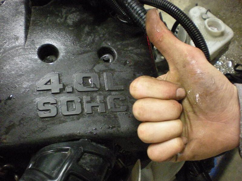

2006 ranger 4.0 SOHC from the same truck the tranny came from.
It was too good of a deal to pass up, $550, it only has 30k on it. It turned out Id probably only use the engine from the navajo anyway, So I sold it Pearldrumbum for $500so he could use the engine and axles on his ranger.
I also got the Y-pipe from the truck that has 3 cats on it, so I can make some money back from that.
I plan on running the engine on an EEC-IV computer from an explorer, and if it seems im leaving a lot on the table with that setup, ill probably squirt it. Im more after reliability, than getting every once of power out of this thing though. A nice flowing exhaust shouldnt hurt.
Also, comparing the two trannies side by side, the M5R1 doesnt have the tapped bosses for the manual T-case shifter on the side, so im going to have to make a bracket for the shift lever.

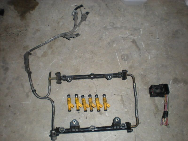

Going to find a return style fuel rail and adapt to fit the existing fuel lines.
Went to the JY today and picked up a few things.
There was a 97 explorer out there with the SOHC, so I robbed the fuel rail off of it. The cool thing about it, is the fuel lines come out in the same spot as the B2, so it should just be plug and play.v
I also picked up some 19lb injectors from a T-bird, they are a little bit longer than the ranger ones, so hopefully Ill have enough room to space the fuel rail up to use them.
The third thing I picked up was the pigtail from the engine harness connector, I might get away with just splicing into the 90 OHV harness and plug it right in to the SOHC.
